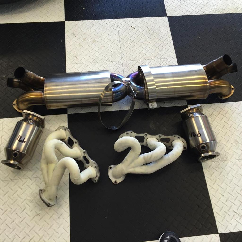

That X must cause some serious friction! Look at the color differences, slightly yellow at the inlet side and pretty blue in the middle at the X. Weird!

Good catch Dixie. It's discolored due to the fact that there are bends there. It's a 1D X which helps with the characteristics sound and performance. We have pushed 1000 hp through one of these on a 991

There’s a bend ahead of that muffler as well and that bend is only slightly discolored (yellow) while after the muffler at the X the color is blue. (much hotter) Normally temperatures drop the further away from the turbochargers but in this case the temperatures go up, that can’t be correct.
Actually seems like no surprise because with that tight X you’re choking the airflow. I understand that the 1D helps with sound but that X really is a bottleneck and won't help with performance at all, hence the severe discoloration.

Thanks Dixie. Most of the top modern exhausts though a bit different have an X of some sort or chamber in the middle including the factory unit. So you will see this same effect. You will not find too many full systems if any for this car that just flow across without an X, merge, u-bend or chamber. Again it's not just an X. We have had pretty great success with this design as an amazing all-around test proven solution. In fact it's on the strongest 991's in the world as well as THE highest powered I know of @ 800hp to the wheels and counting (PDK limited). This is why I stand behind all my team and results and suggestions 100%. We also have different solutions for different applications. Most times there are compromises but here many feel we have nailed it. Opinions are great and welcome. But the performance and sound is proven and it wasn't overnight I am proud to learn form and work with Kline innovation!

I agree, I thought that discolored X was an isolated issue on Visceral’s exhaust but it seems like a common problem.
Here is another one, yellow at the entrance and blue/purple at the X. That’s a lot of choking
