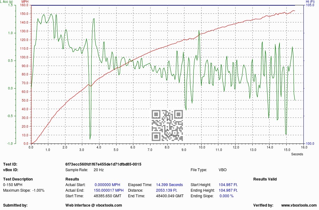

SubscribeI wanted to post up a review for awhile but I wanted to include acceleration testing with it, and the summer heat made comparisons to my baseline testing impossible. Since today was 75 this morning vs 68 when i did my original testing i decided it was close enough. DA was just under 1000 so both runs before and after are between 0-1000 DA . I did 1 warm up 1/4 mile run then two full 1/2 mile runs and the car got faster every time . 10.53@ 130.1 v box trap , then 10.52 @ 130.2mph vbox trap , then 10.50 @ 131mph box trap(132mph terminal velocity ). The two half miles done on the same flat slope both ways were 16.7@ 156.5mph v box trap 155 terminal velocity ( I lifted too early) , and 16.6 @ 158.2 mph box trap (159 terminal velocity). Best 100-150 mph was 8.02 sec, and 0-150mph no rollout was 14.39 sec. All runs were on pump 93 octane , tire pressure 32 front 35 rear on the stock zeros with 3000 miles on them. Still able to get a 1.57 60 ft. Not surprisingly just changing the exhaust has very little effect on max performance (Best time and trap are identical)however it did seem to help with consistency and preventing any decrease in performance on a warmer day and the 1/2 mile run was the quickest and fastest she's done.

Here are the box verify files.

Strong 10.2 on an un-prepped street surface. New heights compared to the .1s at the track in comparable stock form. Def looks to be a 9 sec recipe with a lot less compared to the .1s. Can you post the the vbox 10.2 run? TIA

Oops typo 10.52 ! Not 10.2 !Originally Posted by White991TT

Heck yes , considering I'm stock except for the Kline exhaust I'm very pleased , especially the 1/2 mile trap .Originally Posted by White991TT
