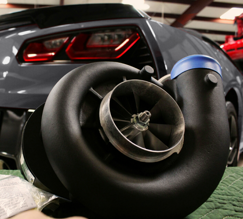

While I am patiently waiting for my Speed Fix from my TTS, I just purchased a set of Weld racing wheels and Hoosiers for my 2016 Camaro along with a Procharger to give it that little extra push. I should have ordered it earlier so I coulda put it on for the Red List oh well been busy. The box stock Camaro ran 140-141 all day long at the last shift sector, will see what an extra 150-160hp to the wheels will get.

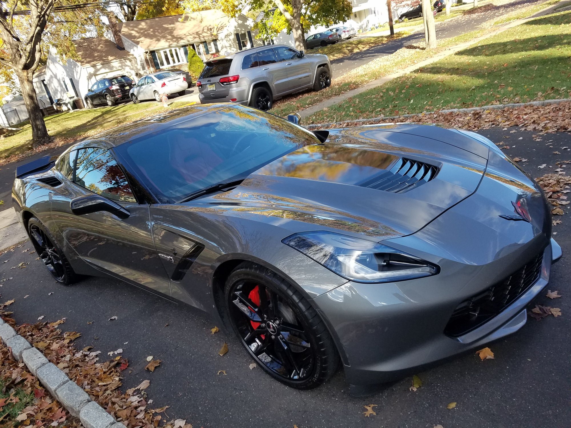

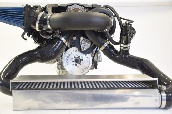

I can't answer for him but most likely it is the same as the intercooled ECS kit on my C7 vette. They are a large air to air intercooler and mine lays flat in the front of the car to not block the radiator. It's a great set up. With just 8lbs and longtubes/meth my car makes 620rwhp (around 710 crank horsepower) and has plenty left if you pullie down and retune. The kit is capable of 15lbs but I would do forged pistons before I did that. Everything else in the LT1 motor is forged and up to the job.

Adam yes I'm doing the stage 2 air to air which is the largest one they have, along with a custom tune. The standard kit puts out roughly 7psi and super Chevy installed it in a Camaro with the canned tune and it put out 550whp on 91 pump. So there is a lot of room to improve upon those numbers with custom tune, more boost, better fuel, exhaust etc.

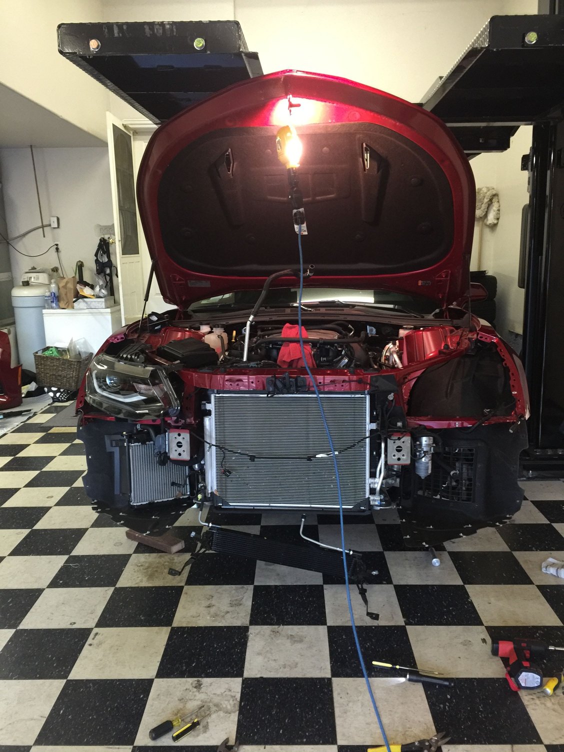

Can't believe how much stuff u have to take off

Holy crow, nice project Mark!

That's awesome Marc! And it should round out the sights and sounds nicely!
