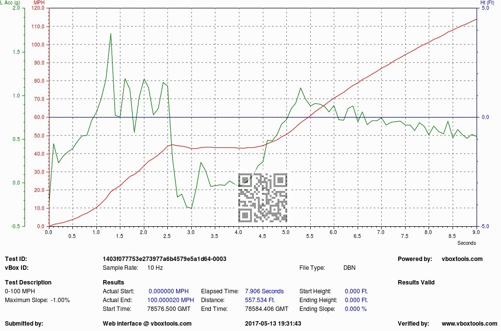

A couple people have asked for my Vbox runs from the other day at the strip I am pretty sure I posted a couple of them on one of the threads but here are the 60-130 100-200 and a couple others. These runs were done at Sacramento raceway around 3pm on a sticky track with sticky tires at 27 psi. I have also posted one of the runs that shows the issues we were dealing with but I wanted to show everyone what kind of acceleration this thing has, Have you ever seen a 991 TTS every pull over 1.7G's after a botched launch? me neither cant wait to get everything ironed out.
We should pick up a little more on the big end and hopefully a whole lot at the start,fingers crossed.

Thanks for sharing! Great results!
What exactly did you do to your car?
Thanks Dan
By Design Sam
IPD plenum and Y pipe
Champion Inter coolers
Kline Inconel headers and exhaust
By Design/Tial 68's Vtg's
Jon Bray motor work, Carrillo rods, cnc heads with Inconel valves, stage 1 cams.
Snow performance meth kit
DSS axels
Dodson clutch upgrade
Cobb Access port for Tuning
Speed Gallery Auto
Basically Everyone above has put many hours into collaboration of putting this package together to push the 991 TTS envelope further and further, I can tell you there is no one out there that knows anymore than these guys about this platform.
Sam is the man if you need anything he is the guy putting all this together he is working with every vendor he know more about this platform then Im sure he wants to know. He has spend endless hours on these cars personally putting my car back together more than a few times, so if you ever need anything he will be there for you.

Nice figures man!!!
Where do u live?? It's very rare to see 0% slope.
I had that here where I live.. in Saudi Arabian on the Eastern porvince... Full flat area
And then I thought my vbox was shot... As no one would believe results with 0% slope.. so i tested it in Bahrain and gave me 0.3% slope reading. Otherwise it's doctored lol

Originally Posted by 3llooi
Nice figures man!!!
Thanks Man,
Nevada but that run was in sacramento.
yea I have no idea what the Vbox is doing, I turn it on and I turn it off every so often it comes back with 0 on all the slopes. I dont have time to doctor up anything. I run my cars anywhere any time anyplace, it is what it is, nor do I have the patience to screw with electronics.

Originally Posted by Markblackwell
Thanks Man,
Enjoy it mate!!!
It's not 10% slope though.. right?
LoL J/K
