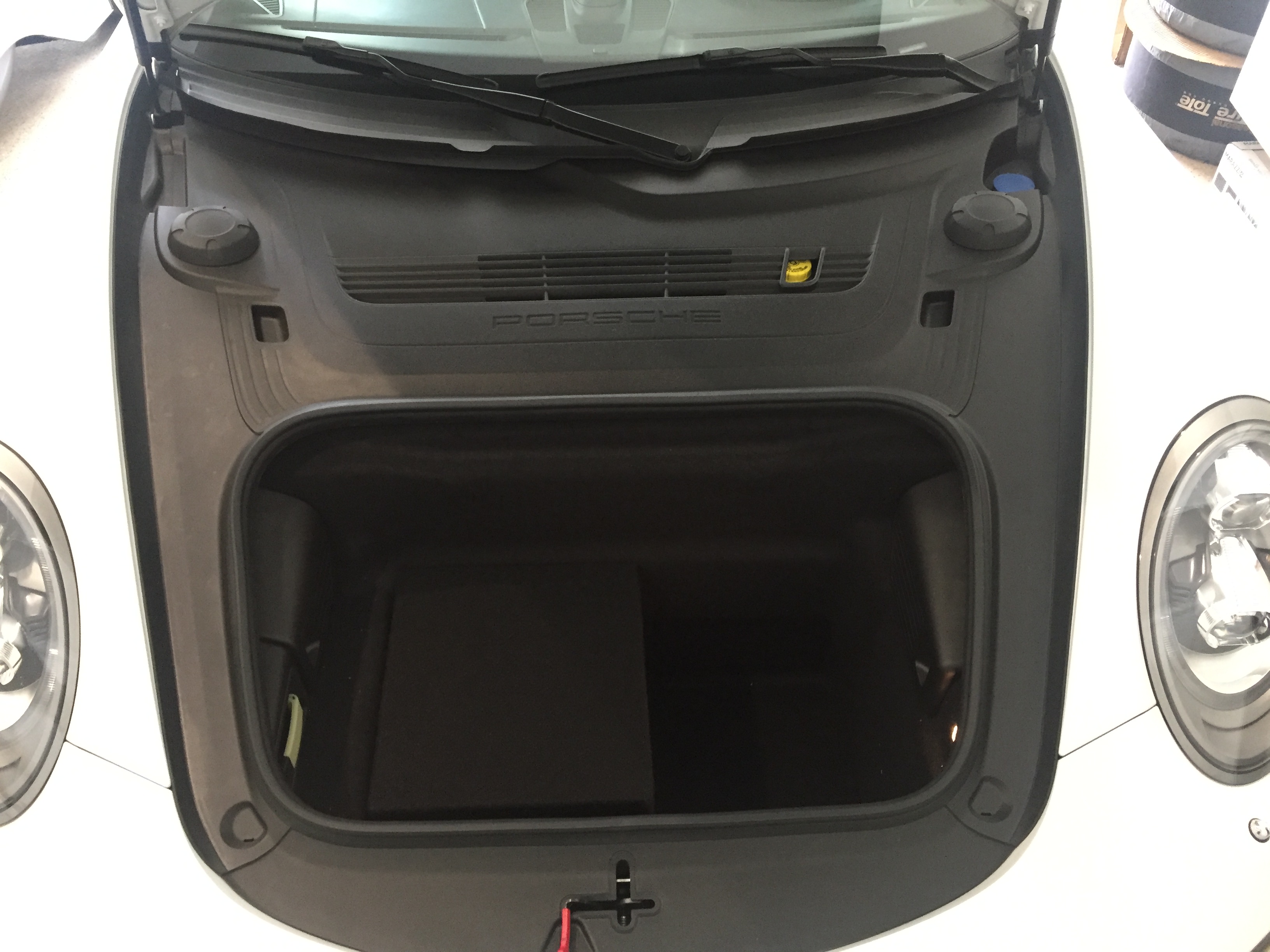

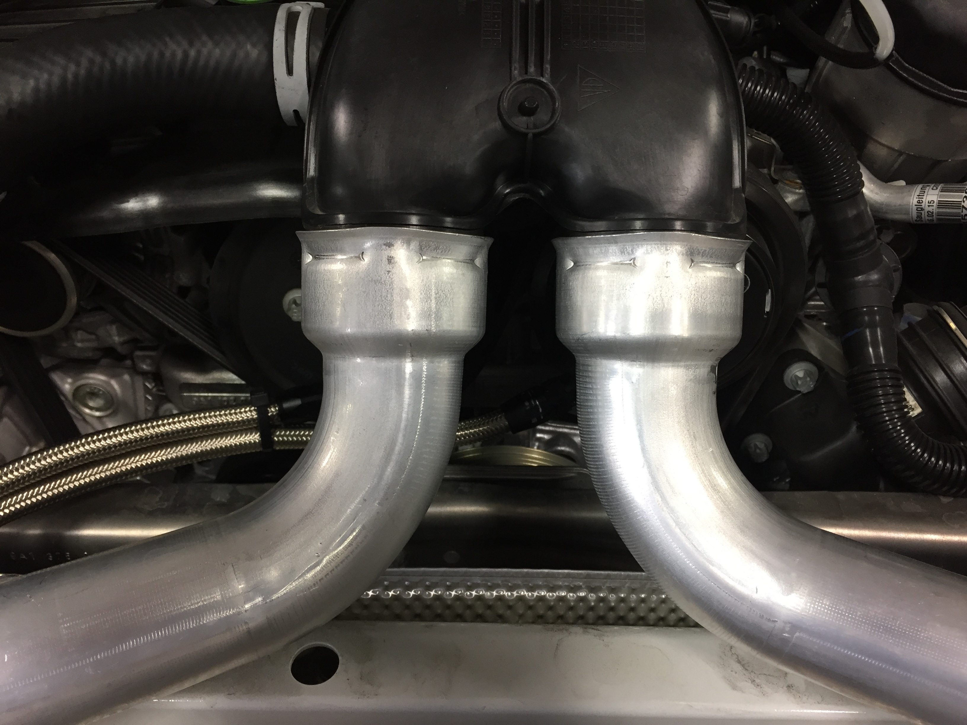

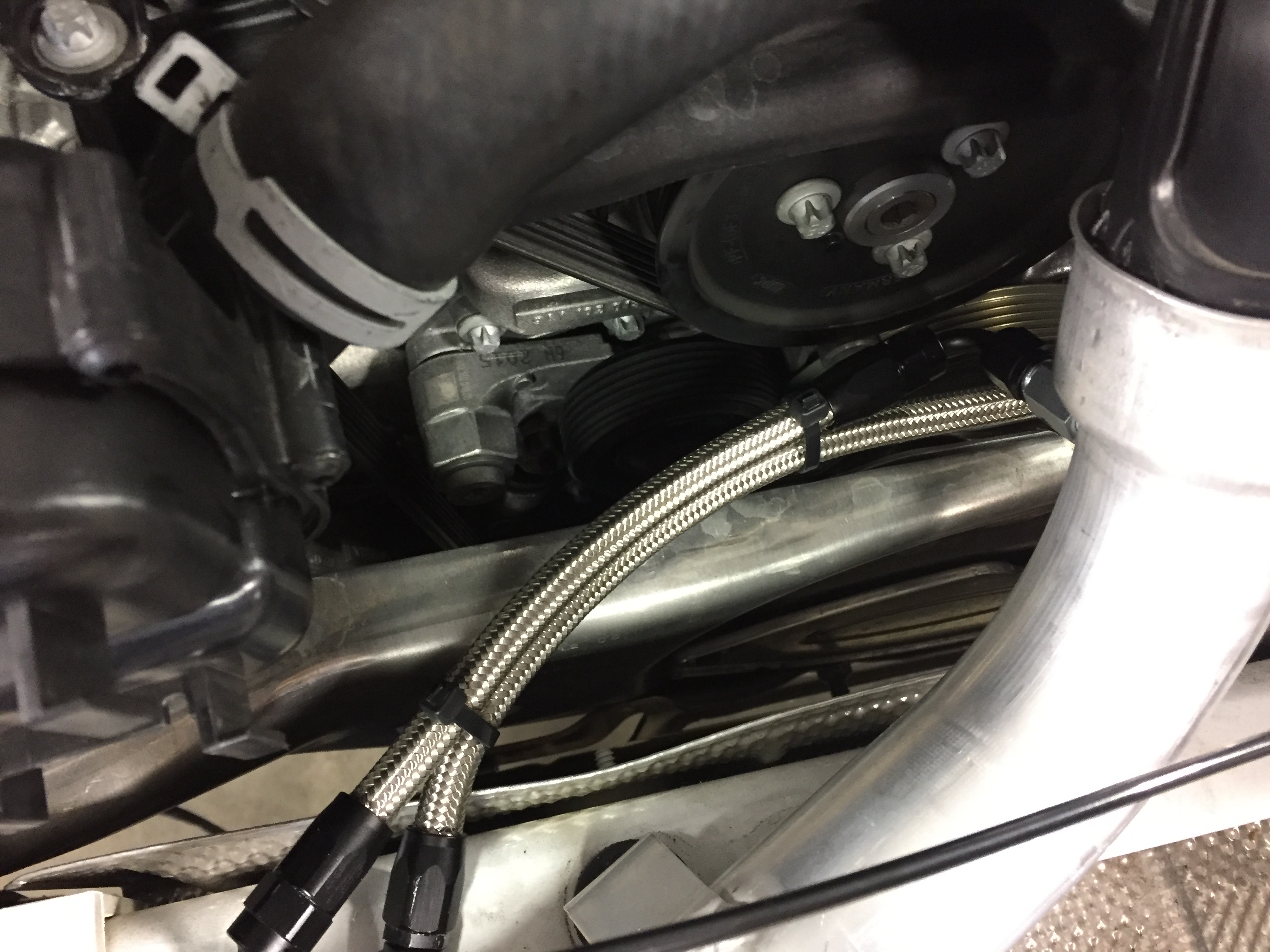

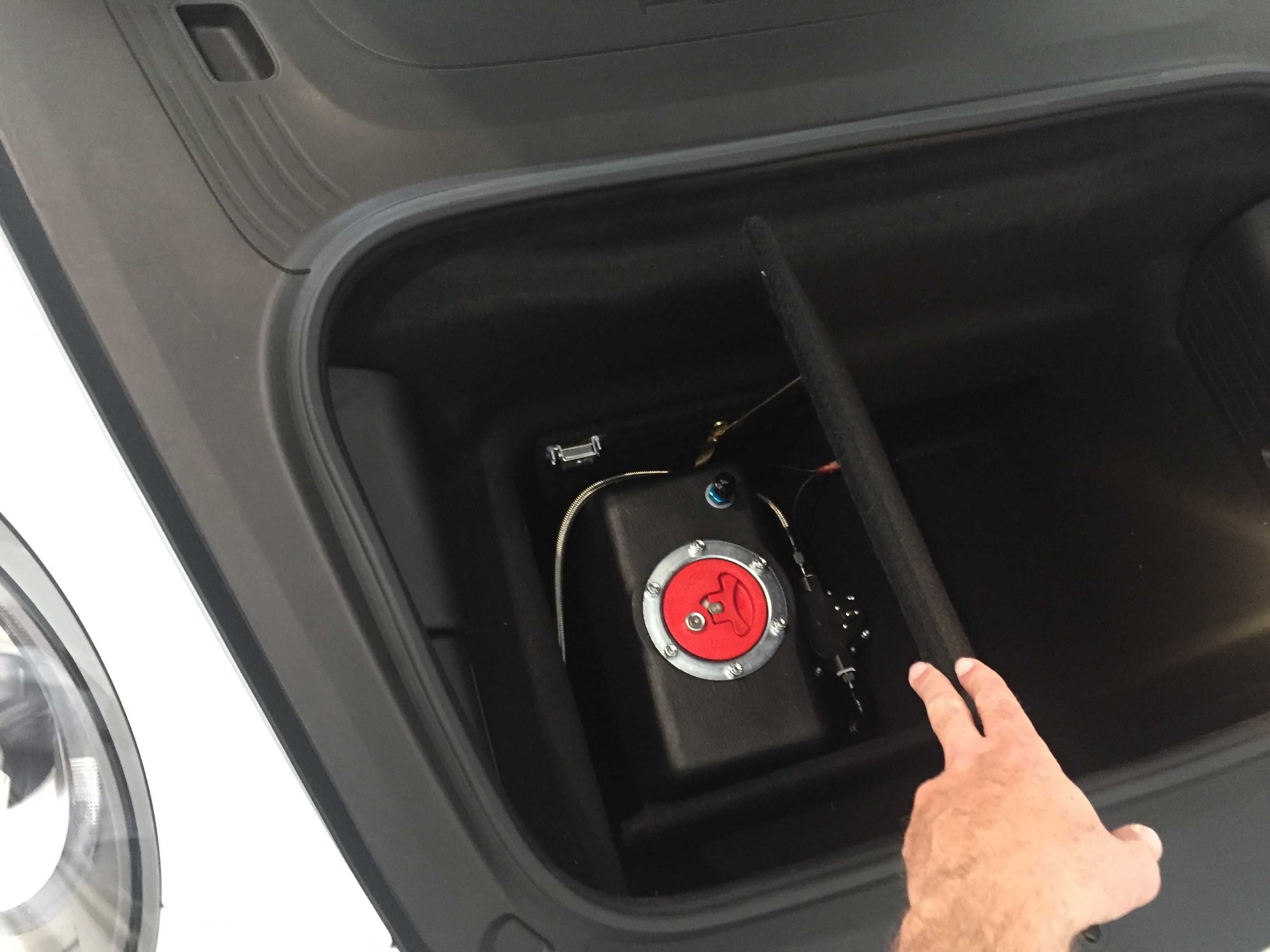

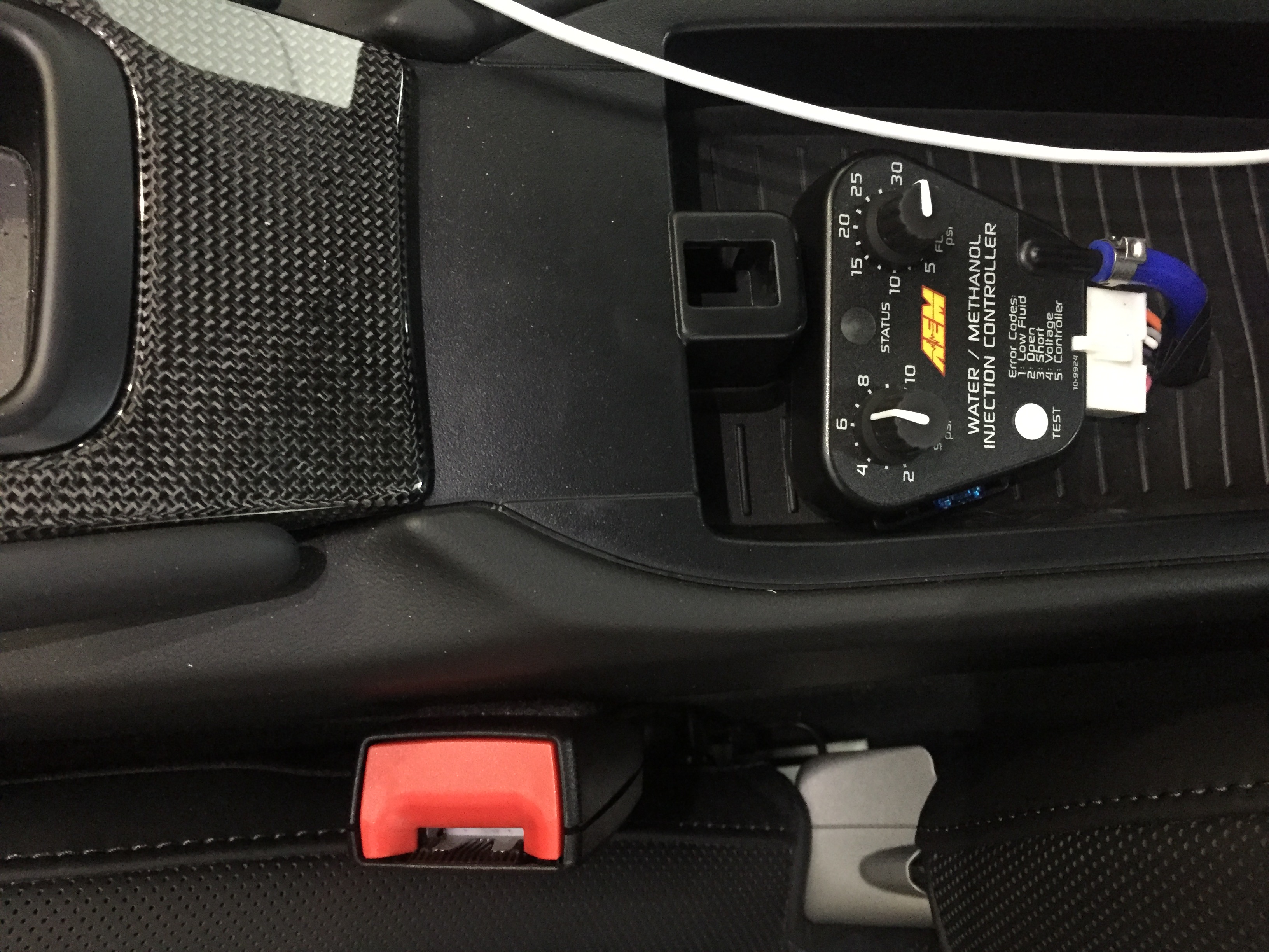

Stealth Meth Install
Meth does some pretty amazing things on this platform as we all know. There can be many issues (some catastrophic) with meth, however. I have been running it for years on a few different platforms and learned that the system needs to be much more robust than what is supplied in the over-the-counter kits from a reliability and safety perspective. My 997.2 Turbo S kit was simply amazing, designed by a vendor here - Thomas Emmanuele of Emmanuele Design. Thomas is a former GIAC tech and he also employs a Porsche tech named Marcel who does a lot of custom aftermarket work.
So goal #1 was safety and reliability. But there was also another goal with this install. Since I've kept my 991 completely stock looking - not even changing the amber side markers - I wanted it to be completely hidden from any view, whether inside the car, outside or even looking in the trunk! How would this be possible? Not sure but I gave the task to Thomas and Marcel with those goals in mind.
What came back was nothing short of spectacular. Given the constraints imposed by the need for stealth, and also to be able to fit a 5 gal pail of race gas in the trunk, parts were all custom ordered including the tall+narrow 3 gallon bladdered fuel cell, the thin AEM meth controller to fit perfectly in the arm rest, and of course all steel braided lines and aircraft fittings.
The AEM controller works similar to my old Coolingmist controller for my 997.2. Start boost for meth onset and max boost for 100% meth flow. Thomas used dual 630cc nozzles which are fine for now although who knows I may go with bigger nozzles later. Like with my 997.2, I'm not tuned for meth so no need to go with a complex system like Aquamist. The Porsche ECU compensates very quickly for changes in fuel trim so a less-sophisticated system works just fine. The AEM controller also has a priming mechanism that the Coolingmist controller didn't have. Pushing the priming button opens the solenoid (you can hear it click) and then it pumps meth into the Y pipe. I know that it's working as priming the system at idle causes idle to fluctuate a little.
There are some limitations for now such as no low fuel light but I will have that addressed shortly.
I wanted to again thanks Thomas and Marcel for an amazing custom job.
Pics enjoy:
