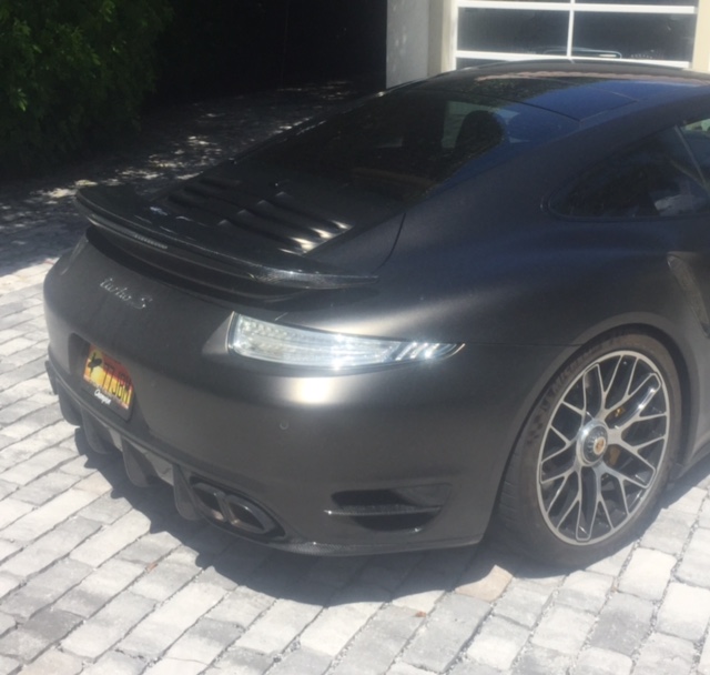

I think with cats it may have been less intense
my car is back together, new backend and wrapped, satin black with gold specks:

Looks really nice Karl. Glad to see her back together. I must say, I agree that with cats the heat would have no where to go. You would have possibly had issues sooner. There are lots of cars out there shooting flames on the reg right out the back.
Did insurance pay for that or you?
