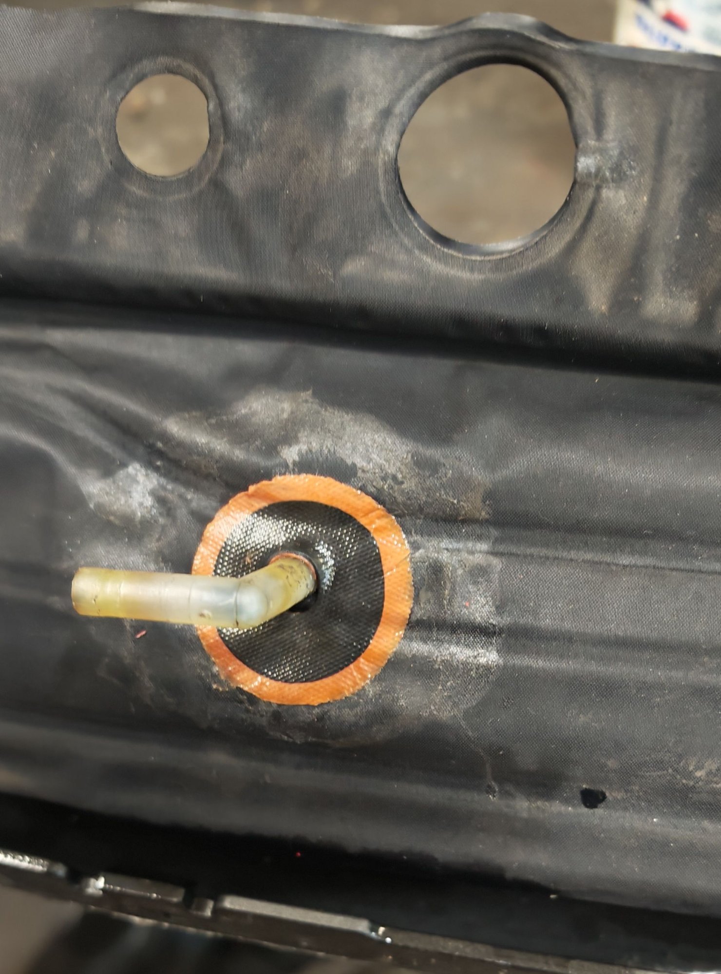

yes it isnt a very high psi and has low volume, a buddy of mine didnt want to pay 5k to replace so we just patched it with a bicycle tire patch, been fine for years now
How big was the hole? I’m trying to fix one right now.

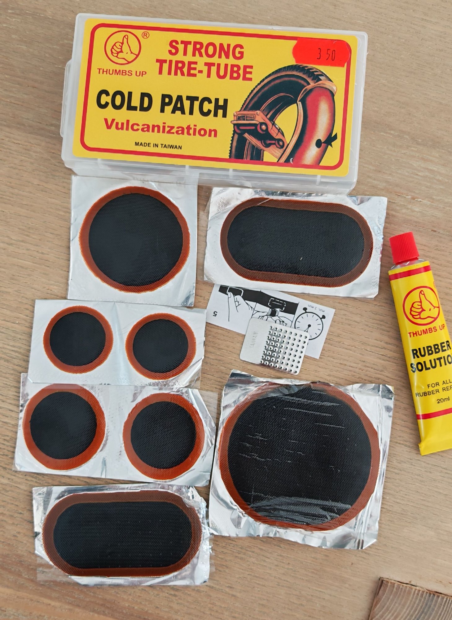

in my case bicycle tire repair kit didn't work ..... and it's just 15 psi

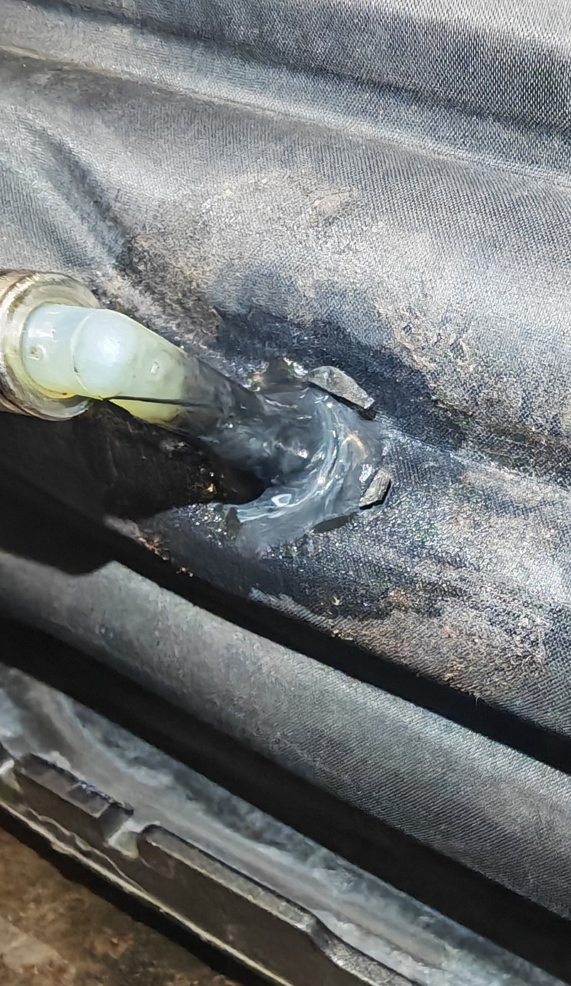

Here is a video of the leak: https://files.fm/u/8d6s25z6kw

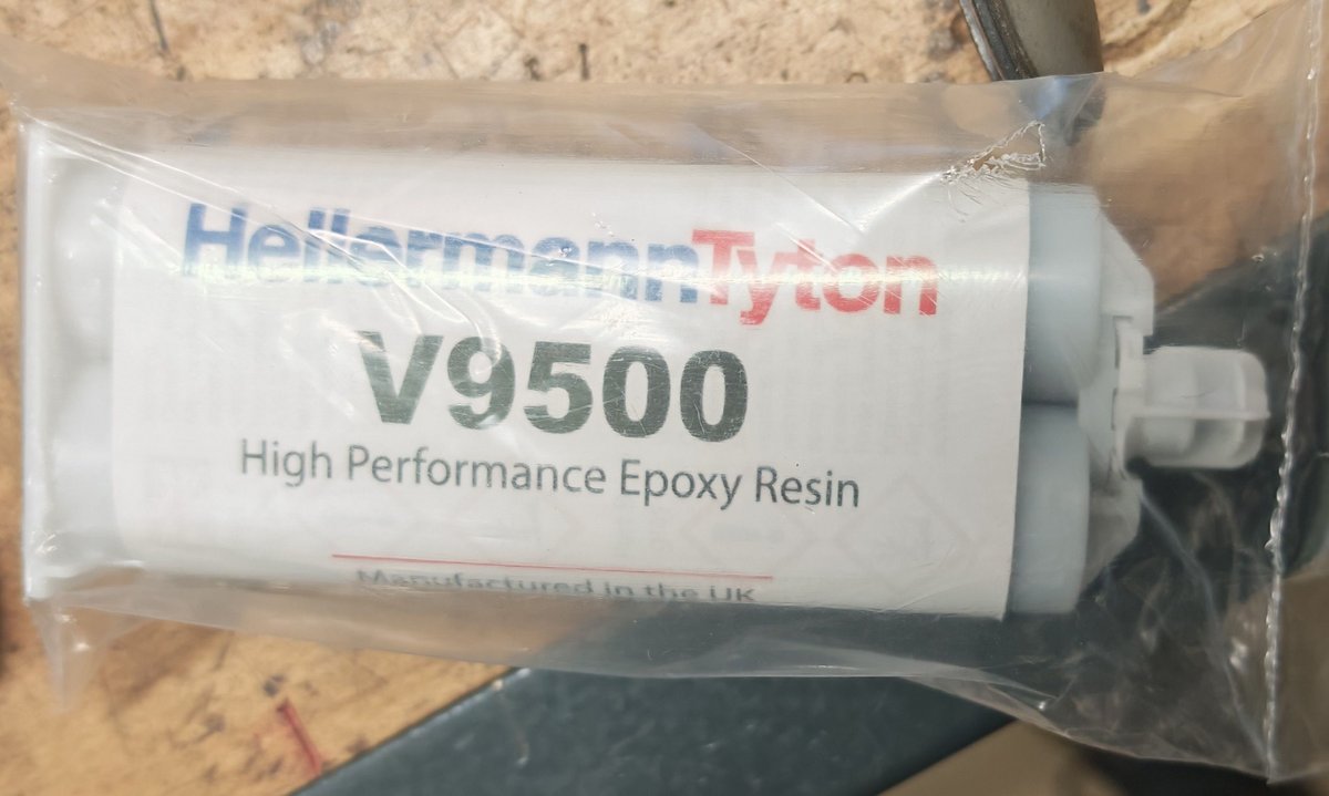

so I ended up using Two-Component Adhesiver V9500 Epoxy Kit-EP-BK https://www.hellermanntyton.com/prod...-kit/627-95001

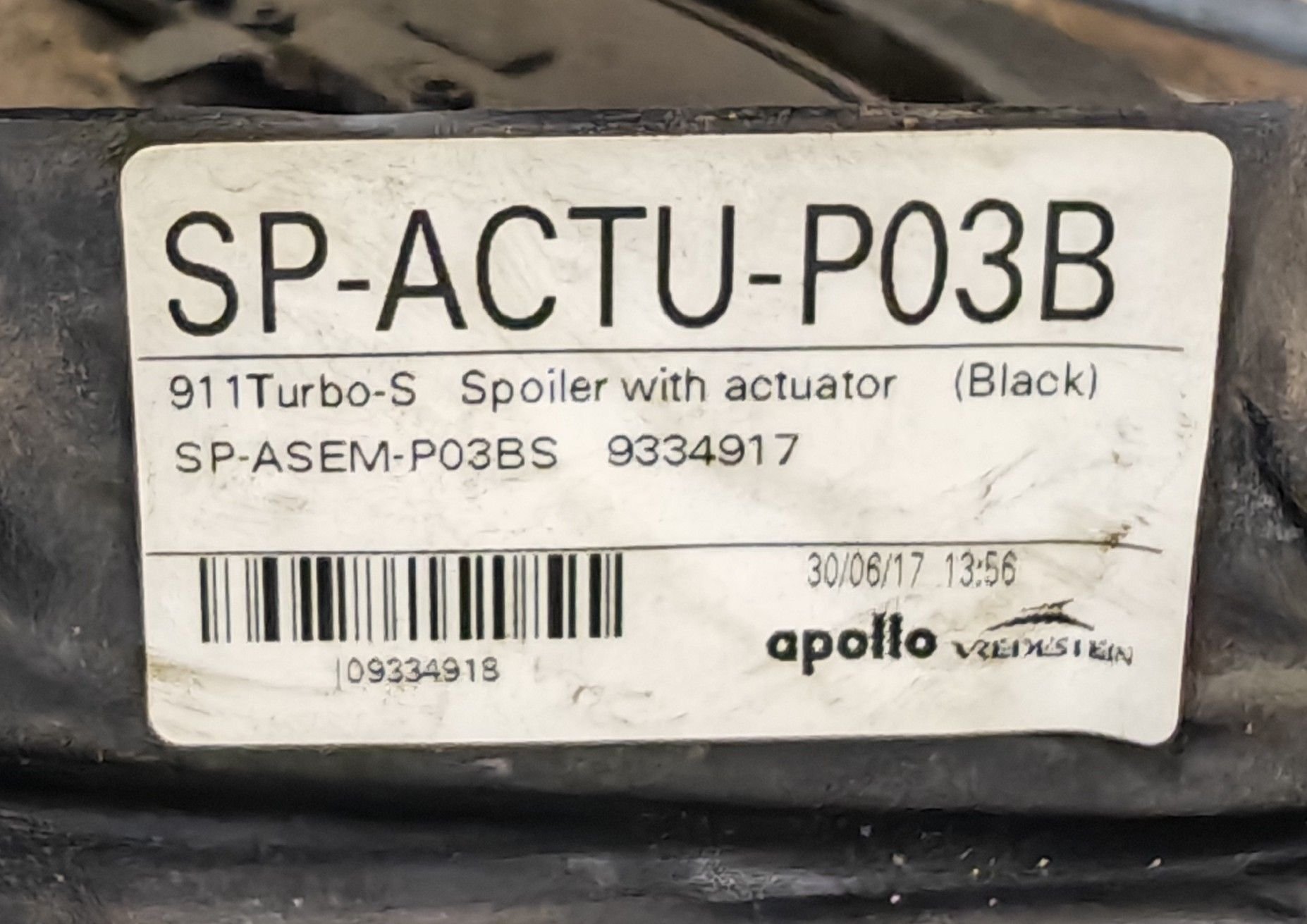

Last photo is a part number of this inflatable part, if somebody would like to source and buy it (if that is possible) instead of repairing it
