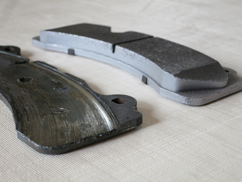

Check your brakes regularly
I have put a Brembo BBK (15" front and rear) on the 991S and the stopping power (combined with track tires) and absence of fading is remarkable.
When you push the car hard (and you will if you know that stopping the car is not a problem ) you pay of course attention to your brake pads. I noticed I was running thin at the end of the day at the front but failed to double check the inside pads more closely before the last session. Bad call. There was no braking issue but quite a bit of grinding on the way back, which is perfectly understandable when looking at what is left of the inside pads:
There is in fact no pad material left at all ...and even some metal of the backing plate is gone No big deal, Vividracing has been able to overnight new pads and rotors are still in good shape.
My best estimate is that I lost 25% of the pads per track day (at the front) and probably half of that at the rear.
It basically means that a set of front pads would roughly last for 275 laps on Road Atlanta... so let's say that pads will cost you ~$1.5 per lap and some change.
Nothing dramatic if you know that gas, at 8 mpg will set you back ~$1.6 per lap, track tires ~$2 per lap and track insurance ~$3.5 per lap. Even if you throw the car depreciation on top of it, you would still be below $10 per lap... and it is worth every penny of it
Your only problem is that once you get the virus, you will want to do many, many laps
Had a similar thing happen to me at Watkins Glen 2 seasons ago, but my expensive AP rotors were ruined completely.
Was really my own fault, my Pagid RS29s did not come in and I used the stock AP pads that they claimed were dual purpose...which melted like butta at the track.
Road Atlanta is tough on brakes.
Are you using the stock pads in the Brembos for street and track?
Totally my fault too. I did not check the inside pads, just assumed that the wear would be the same as for the outside pads (and even went a little too far with those...). Will not make the same mistake twice!
The Brembo BBK came with FM1000 pads which are street + 'beginner' DE events. They clearly are not suitable for a more intense use. Vividracing shipped me HP2000 pads that should do better. Still no true race track pads but should offer a good compromise for street and track use.
Here's what Brembo says (to take with a grain of salt of course): "Tested to the highest levels on the track with decelerations from 270kph (168mph) the HP2000 material is capable of operating in the most demanding conditions.
With excellent cold performance & bite, high resistance to fade, frictional stability throughout all operating conditions, reduced pad & disc wear and low dust levels, the all new HP2000 friction material offers significant advantages over its rivals."
I checked online and could not find more aggressive Pagid pads available for the 991 15" Brembo GT kit.
I'll give a try to the HP2000 at Barber in 2 weeks and provide some feedback. Barber can be hard on brakes too if you really push hard (lower top speed than at Road Atlanta but more repeated heavy breaking).
Just for the fun (?) here's a pic of what is left of the inside front FM1000 and the replacement HP2000:

Originally Posted by ChuckJ
The last couple of turns must have been hairy and noisy!
ChuckJ
Noisy for sure (even though with the windows rolled down and the sound of the engine and tires you did not hear the brakes so much).
Surprisingly, the stopping power remained good, hence why I dod not get too worried. I even got almost rear ended by a BMW E12 that gave me a point by getting into 10A and then was not able to slow down hard enough (coming in at 140mph+ and taking an early apex while passing him, I had to brake a bit harder to keep the car on an OK trajectory).
I think I read a while back why you upgraded to Brembos...but was it because you felt the OEM set up inadequate??? Feel, endurance???
I had a very 'hot' week end at Barber. Brake fluid was taken care of but there were not aftermarket pads available for the 991. I ended up with glazed/damaged surfaced rotors (and even slightly warped) and a lot of fading: the brakes even almost died on me before the hairpin during the last session. I went to 15" Brembo's back and rear and never had a problem anymore (but then sold the 991S, tried a GT3, got into a 991S again and put 15" Brembo's but did not check the pads I got with the BBK which ended up being FM1000 that did not do a good job).
