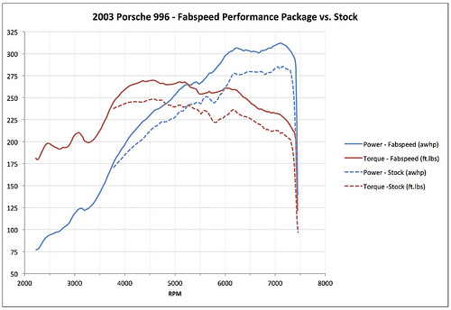

This is in fact a very good question... I had a thread going on on Rennlist about exhaust options and I have been -very logically- warned to take the claimed numbers with a BIG grain of salt.
I also did a quick recap of some previous experience with exhaust mods and an interesting article I found on a similar topic (not the same cars, not the same exhaust, but relevant reference points).

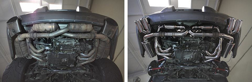

Fabspeed Performance package (Maxflo mufflers, headers, X-Pipe sportcats, tips, ECU upgrade, Competition Intake) on my 2003 996 C2:
The results were satisfactory with a gain of 24hp at the wheels and 21 ft.lbs of torque. The dyno shows a max power of 312 hp at the wheels at 7,100 rpm and 270 ft.lbs of torque at 4,500 rpm (not too far from what Fabspeed claimed)
The significant increase in torque around 3,500 rpm is clearly noticeable and given the performance improvement and the nice sound of the exhaust, I would recommend this type of upgrade.

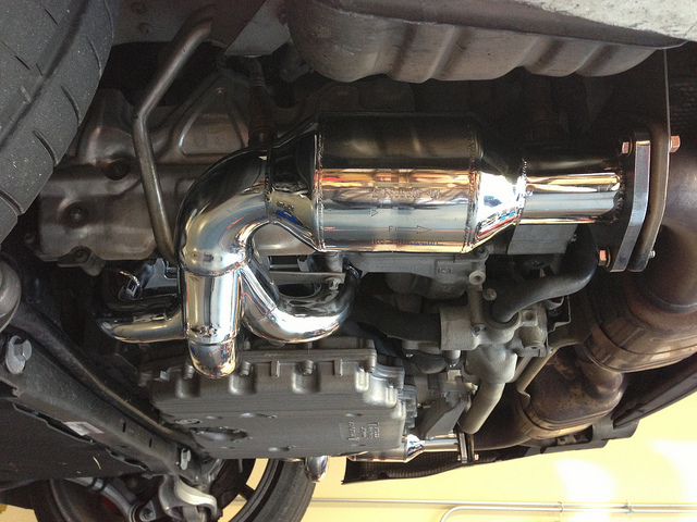

Fabspeed headers with sportcats on my first 991S:
No dyno data here. Fabspeed claims +17hp and +14 ft.lbs of torque to the wheels at 6500 RPM (does not mention if it is for the catless or sportcats headers though). This is probably a bit optimistic.
My subjective feedback is that it made the throttle feel a bit more responsive and there was a bit more sound (in both PSE mode). Hard to put a number on this. I liked those headers as they made the 991S feel different (read 'personalized').
I had also installed BMC air filters, but I think that the hp gain there was mostly psychological
