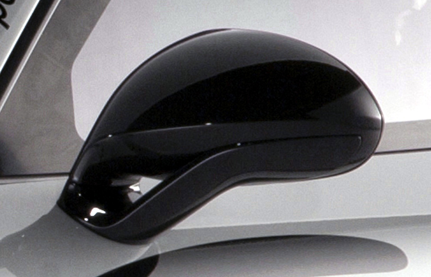

Originally Posted by HotHonda
Closer view:
Not sure if it will fit on the "regular" 991. The door looks a little more concave, I may be wrong.
Closer view:
Good stuff, thanks for doing some photoshop on that image.
I don't think Porsche has changed the shape of the doors on the 991 just for 1 model... it would be very, very costly to do so.
In the past they've used the same dye's moulds, tooling etc but did use a different light weight material for the doors etc of the GT3 Cup car... same dimensions though.
But I guess we'll find out soon enough if the mirrors fit... I see them in my future, soon!

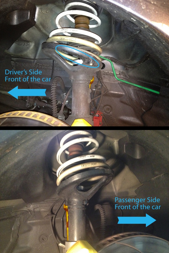

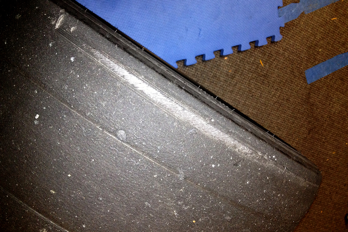

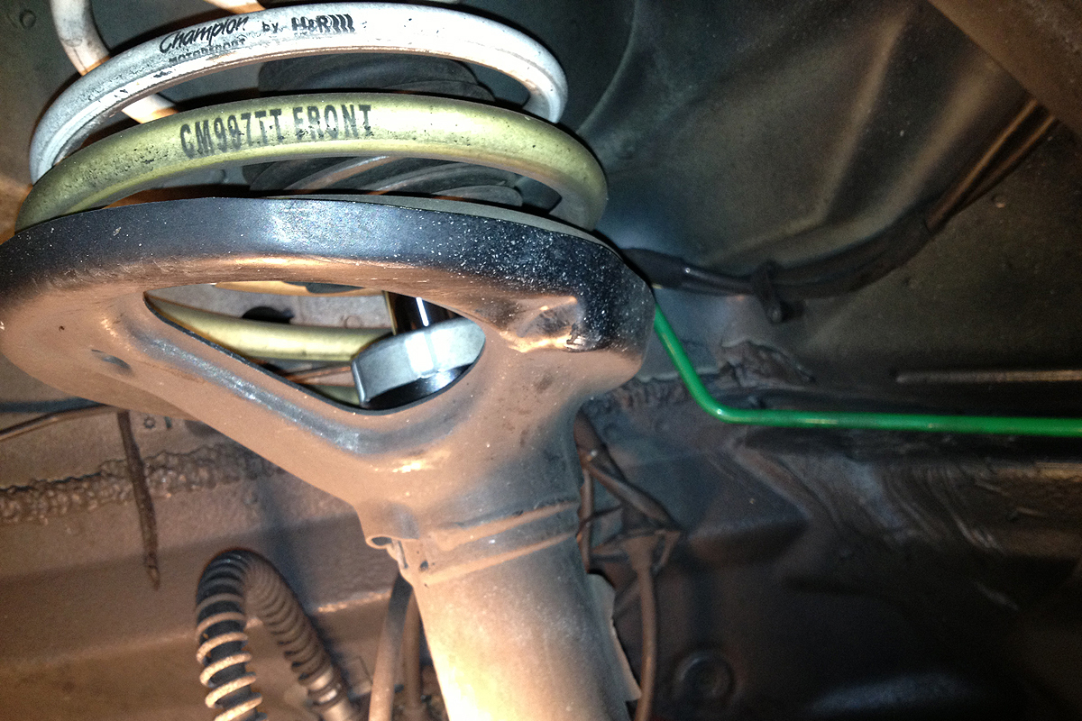

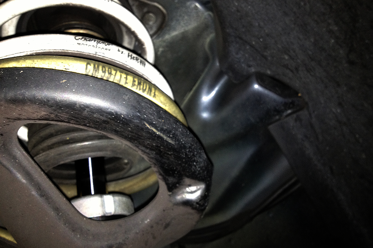

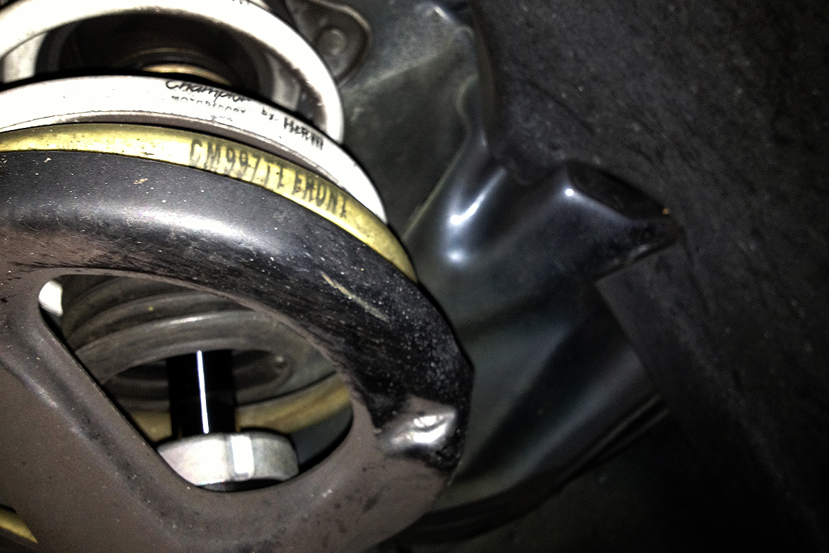

Jeez Sid, you wrote all that! My head is spinning, and I have only had one martini!
Big dilemma with the Turbos as well. Attached is a picture of a 2009 OEM Spec'd tire size on 19 inch GT2 8.5 front wheels with stock shocks, but with CMS springs:
The OD's matched up with the correct OEM recommendations within the tolerances allowed. However, when driven at speed and conviction look what happens. Although when street driving there isn't an issue....its when physics take over and distort reality...less than 3 days on these tires...meaning 6 to 7 hours of hard track driving.
ID:	212185   Click image for larger version
ID:	212186   Click image for larger version

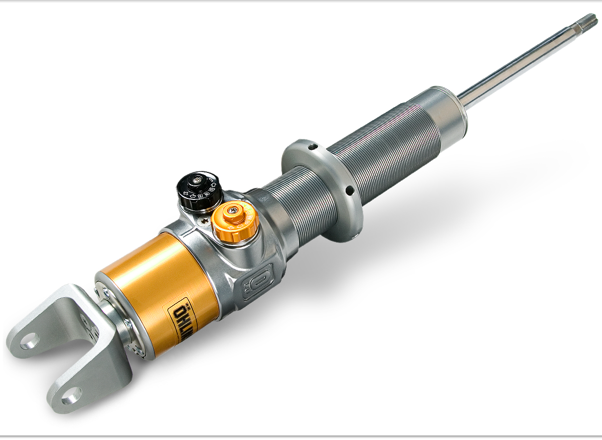

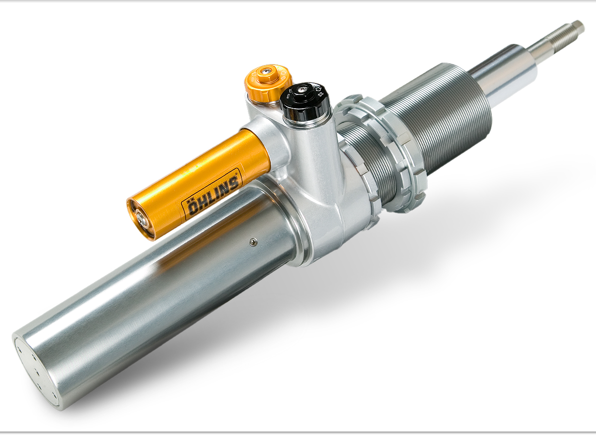

I'm addressing the issue though....
ID:	212189   Click image for larger version

Yeah it's enough to make your head spin independent of alcohol intake!
But I'm in the middle of this so it actually helped writing it out like that (rather than copious amounts of categorized numbers...).
You sure did a number on those tires, damn!
You're lucky you didn't get a blow out with that type of damage.
Yep, perfect example that everything is connected to everything...looks like you've got a pretty good solution though, very nice!
Cheers.
