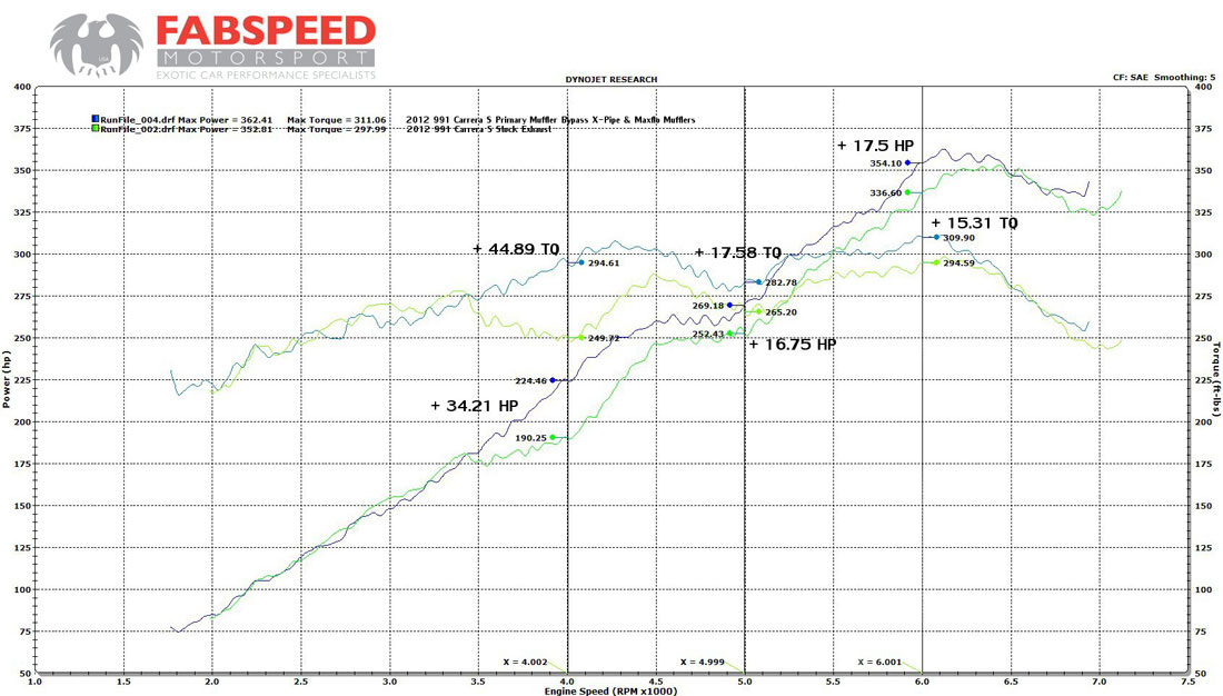

after doing some research on aftermarket exhaust I noticed that almost every stock dyno plot on the S shows a dip in tq and hp in certain rpm ranges. Here is the fab speed dyno of their car before and after. Vivid Racing shows the same too--- very interesting and maybe the cause of the feelings some are reporting- the tq dip is particularly disturbing
