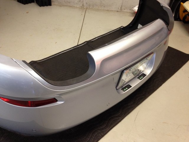

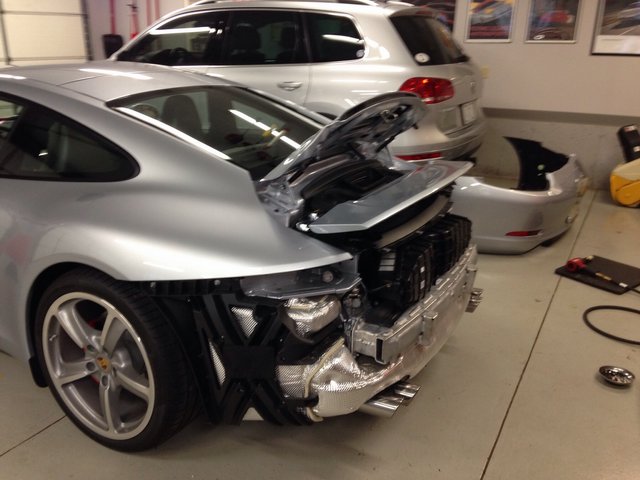

Having taken the bumper off once, I can say that as far as difficulty of 1-5 I would call it a 2. It's not hard, but a bit cumbersome. I put blue painters tape on the edges of the bumper and also where it mates with he car to help avoid any possibility of scratching. Probably not necessary but I'm a bit OCD with stuff like that. If I had it to do again I could probably get the bumper on the ground in 20 minutes. Removing the valence is quite fiddley and it took me a couple hours of prying and unclipping fasteners making sure I didn't break or scratch anything. Patience pays off with this DIY.
