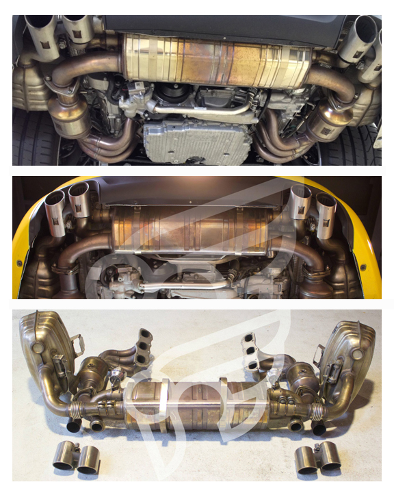

Since you got most of the PSE info already, here's some more on the stock exhaust.
Cheers.

Questions Stock S Exhaust
Interpreting the diagrams it appears on the stock S system without PSE with the "flaps" closed all the exhaust goes out the side mufflers. With the flaps open most of the exhaust would go out the inside tips bypassing the side mufflers as the exhaust followed the path of least resistance. It appears the PSE works the same way but the lessor back mufflers are connected when the valves open.
I heard from an aftermarket manufacturer that reducing back pressure too much in the lower RPM's reduces power and that is why there are valves. Simply keeping them open all the time might sound good but actually rob performance. I am not sure how that logic would apply with PSE?

You're right, there are 2 reasons why both the S stock exhaust and the PSE have valves which open above 3500 rpm...
1st is the noise pollution regulations...
2nd back pressure...
That said when the PSE is engaged the valve does not just open above 3500 rpm... it's rather more complicated than that (Porsche loveeeeees to "over" engineer after all hehehe).
Most people think that the PSE valves open 100% when engaged but in actuality they function very much like the valves in a musical instrument and are opened and closed to varying degrees as per designers/engineers specs and take into account the dB levels, frequencies, flow dynamics (back pressure), etc.
This orchestral crescendo of rising and falling notes includes the artificially created popping, barking, snarling and barks which originated from the ignition timing specifically designed (in Sport+) to create unburned gas fumes (which then ignite) as well as the cold-air intake flow dynamics/volume and an actuated valve on the Helmholtz resonator (see pic.).
Lets just say it's no coincidence that the 991 sounds as awesome as it does!

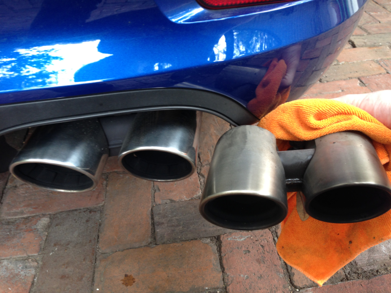

I was wondering if somebody could post a picture of the PSE tips Vs the non-PSE tips. I am trying to understand how different they are.

Here ya go. The PSE tips are the shiny installed ones.
Hope it helps
