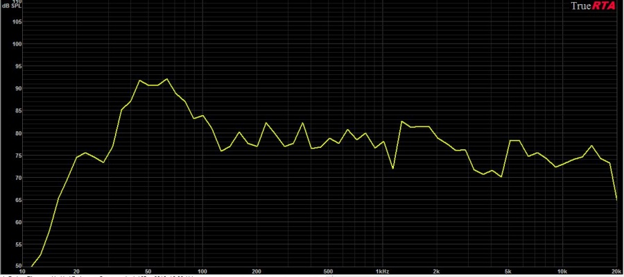

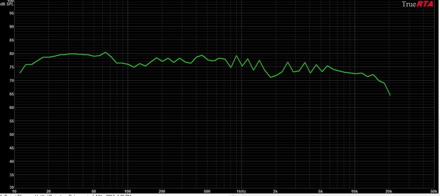

I consider myself a bit of an audiophile..over the course of the last few years I have built a combination HT and two channel dedicated system which has a failrly flat response. I finally had time to do a sweep of my Bose system in the 991 as I wanted to try to understand why the system was prone to rattleing and distortion. I located the microphone in the driver's listening position. All settings were left at zero with the dolby surround option off. The response is bass heavy, perhaps as expected for a car system. More interesting, ther individual frequency responses in the bass region show the excitation of higher frequencies as a result of rattling parts. This effect stops past 125 Hz. I believe the rattling is caused by the door panels. I will try to have the dealer fix this issue and report back.
good report.
I had the "speaker rattle you describe with my Bose. It was the door panel plastic cover for air bag at front edge rattling against the door metal- simple dealer fix to adjust, but can recur. To my old too many rock concert ears the Bose the car came with is just fine- but the Burmeister is very obviously just finer.

Brought the car in yesterday. No rattling parts according to the dealer. Everything seems to be tight. They have ordered new tweeter from Germany. I have not had a chance to discuss this strategy with them as of yet..just an FYI. The speakers will take weeks to come in.
My measurements clearly show that the rattling occurs in the low frequency range, nothing to do with the tweeters. Regarding the Burmester package, I understand that the driver implementation strategy is similar to the Bose strategy, just higher quality speakers? Can someone confirm? If this is the case, the Burmester system should also be prone to rattling in the low frequency range?
