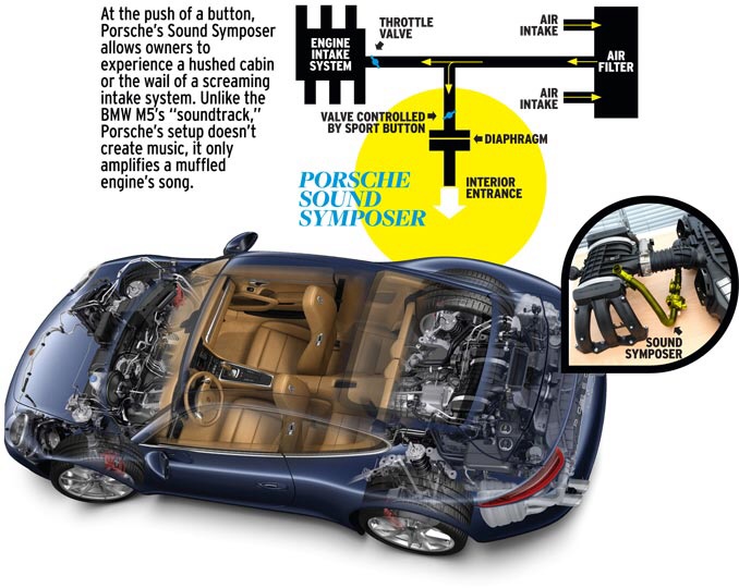

Originally Posted by hawc
Are we sure about this one? Does the throttle note actually change on a base car without PSE? It obviously can't make it louder, does it just add a little extra burble when you let off the gas? How can it make the exhaust any more aggressive when applying throttle? It can't open any valves in the normal non-PSE system.
Sound symposer kicks in. That's what accounts for the sound
Sound symposer is just there though. It's just a permanent pipe. It doesn't 'kick in' or 'kick off' it's just there. There's no way of changing it. There's no valves opening or closing in this pipe. Sound symposer can't change.
Yes there is a valve, the sport button activates the sound symposer, sound is noticeable deeper inside the car with the sport button engaged.
I stand corrected. My apologies.
