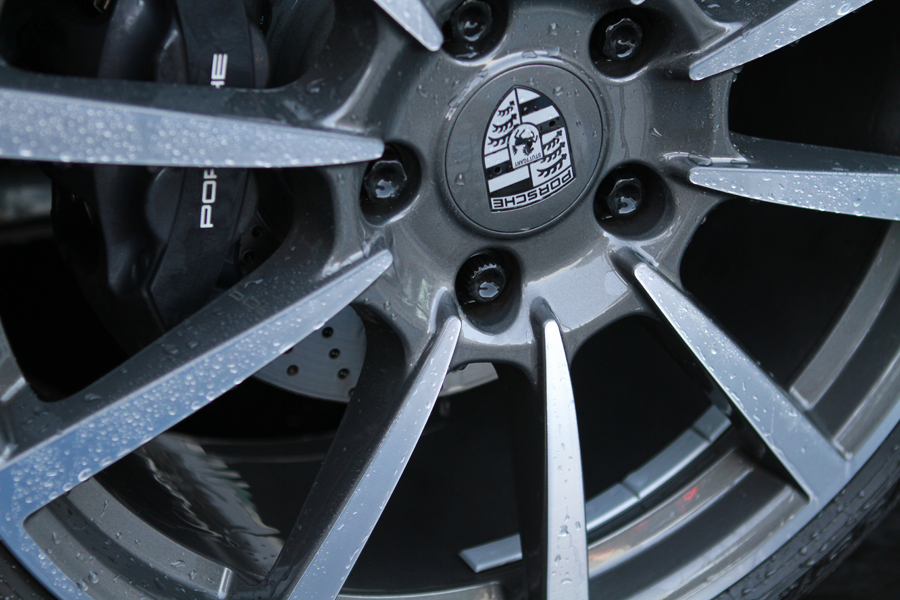

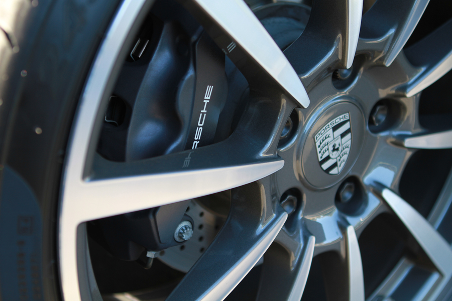

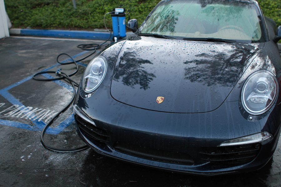

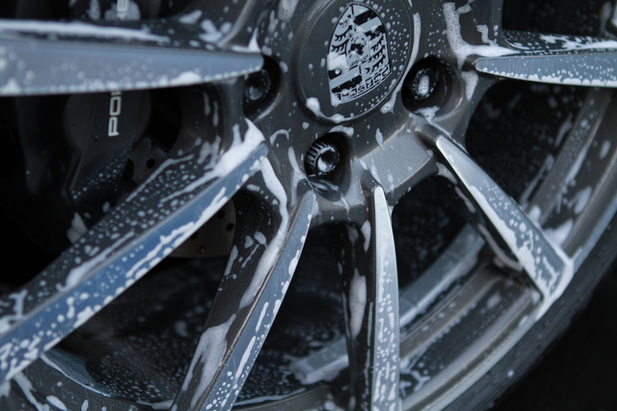

Initial wheel cleaning using non-acidic wheel cleaner gel
Wheels further cleaned using a unique polishing soap
Wheels rinsed

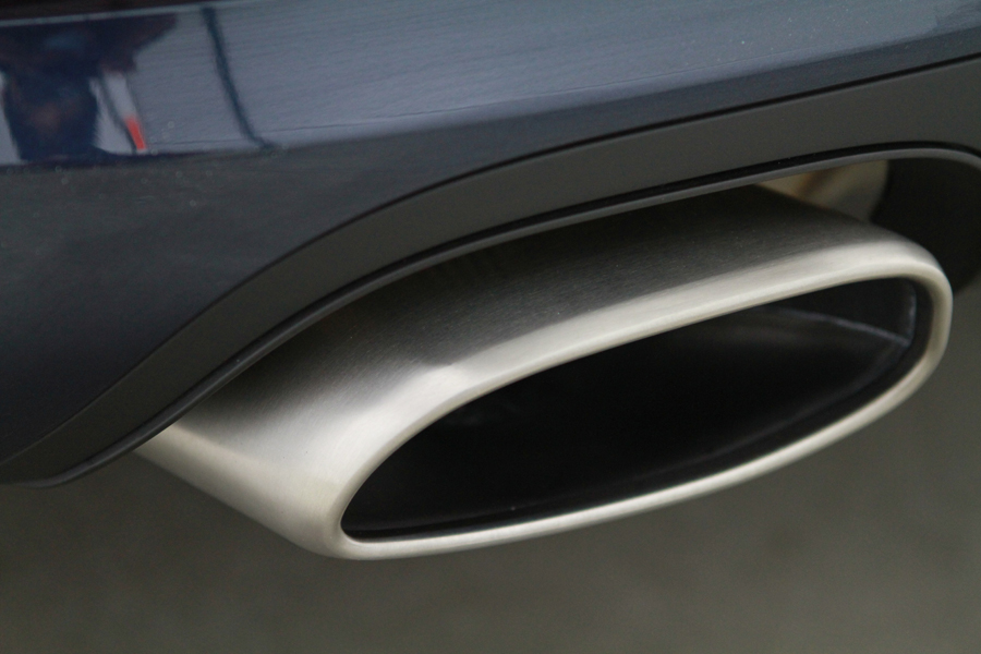

Tailpipes cleaned using polishing soap

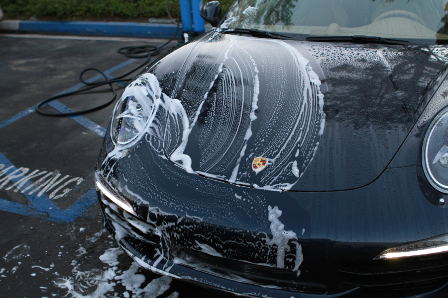

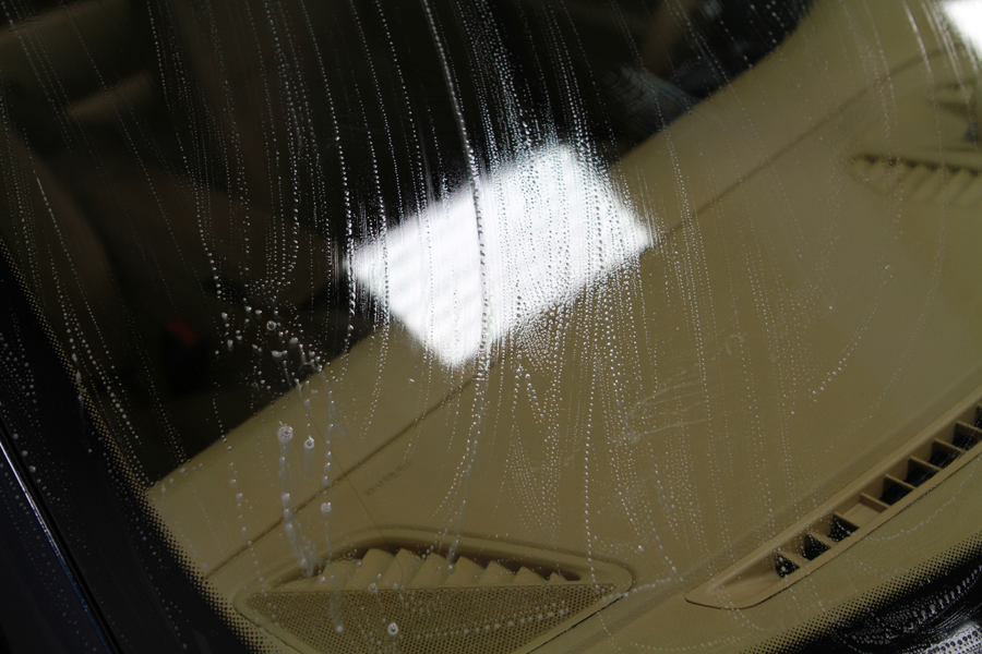

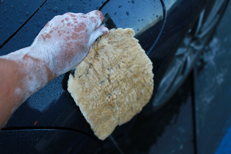

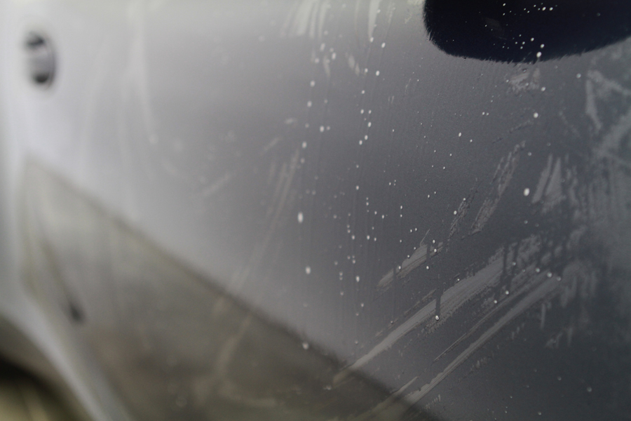

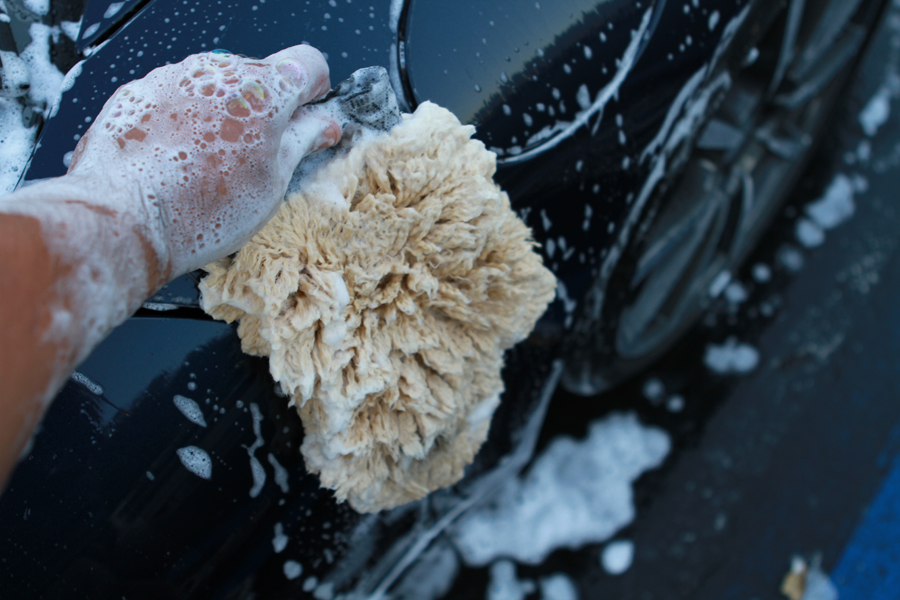

Initial wash using All-Natural Soap
Wash mitt rinsed after every panel. Assures no contamination put back into wash bucket
Exterior rinsed after every panel. Dirt encapsulated in soap suds, and quickly rinsed off
Exterior dried using microfiber drying towels and forced filtered air

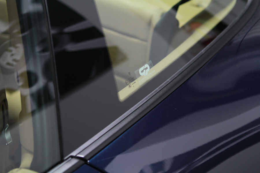

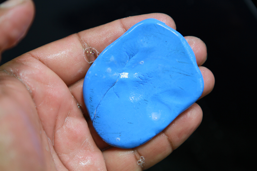

Paint and glass surfaces decontaminated using clay
All surfaces were in pretty good shape

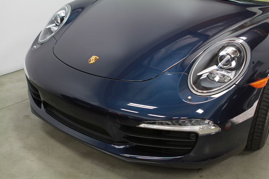

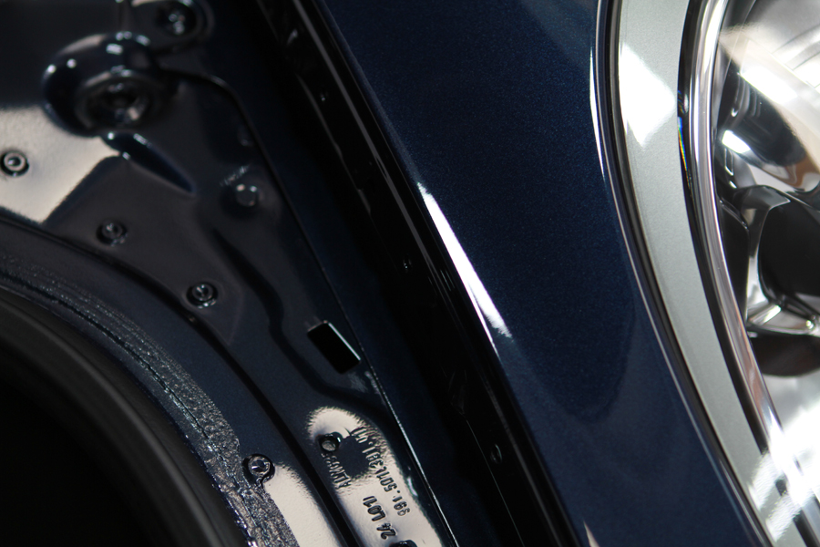

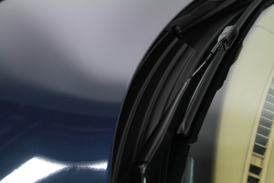

Initial clear film condition. This film was installed only a few months ago

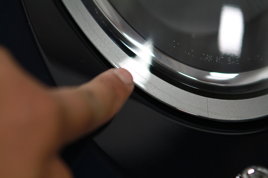

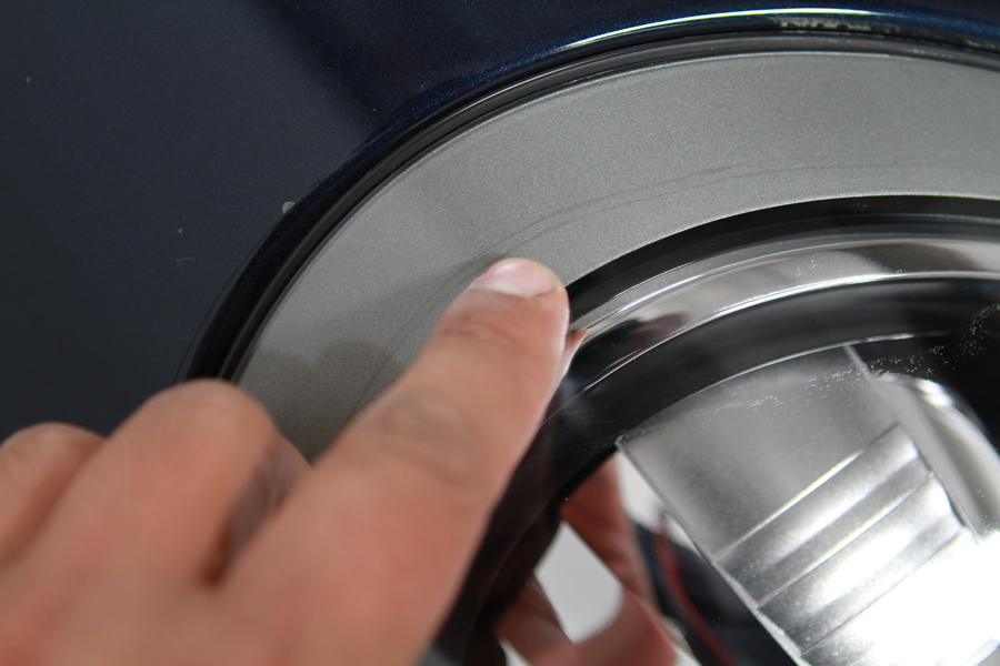

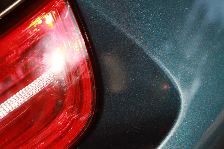

Cut marks into plastic lens

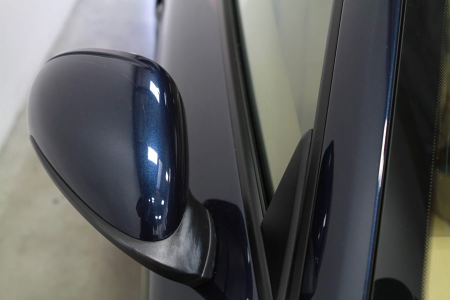

Cut marks in mirrors
Light sanding and polishing slightly minimized cuts, but unfortunately, cuts are too deep and require repaint of both mirrors

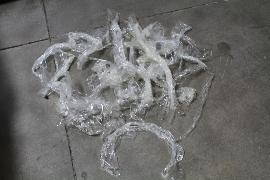

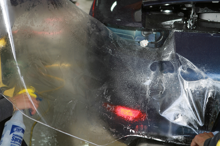

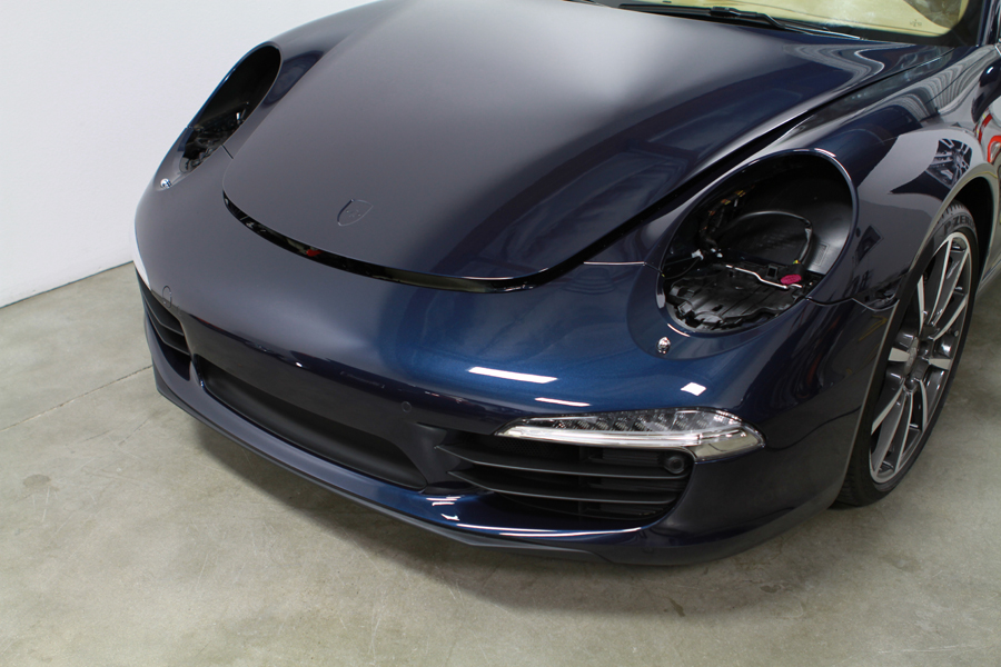

Nearly four hours later, and all film removed. This 991 had a full hood, full fender, full bumper, headlights, and mirrors covered with film. We take our time and remove film slowly to minimize chance of paint lifting from panels. There is definitely an element of the unknown and each film we remove, we let client know of the risk of what may arise. In this case, the previous installation was simply unacceptable, and client was willing to take risk

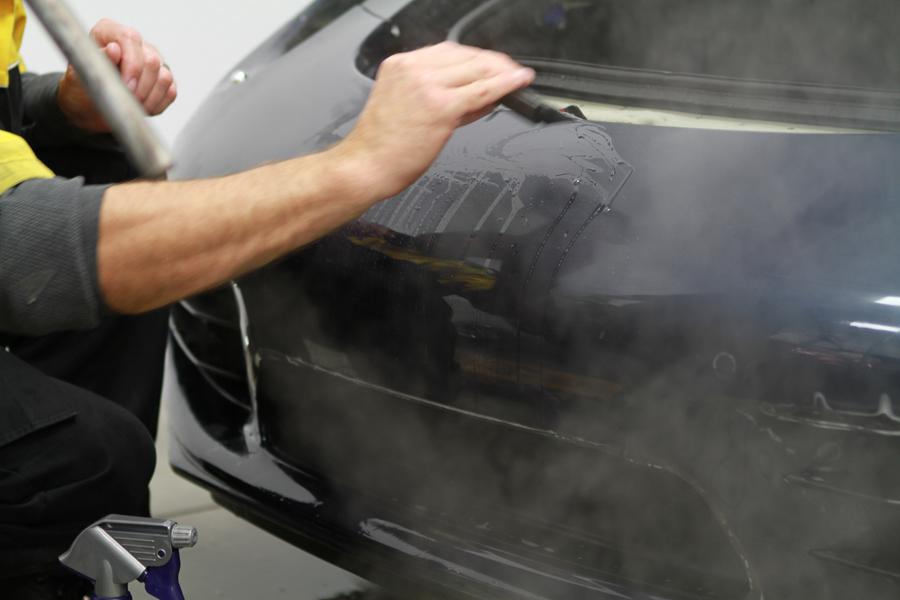

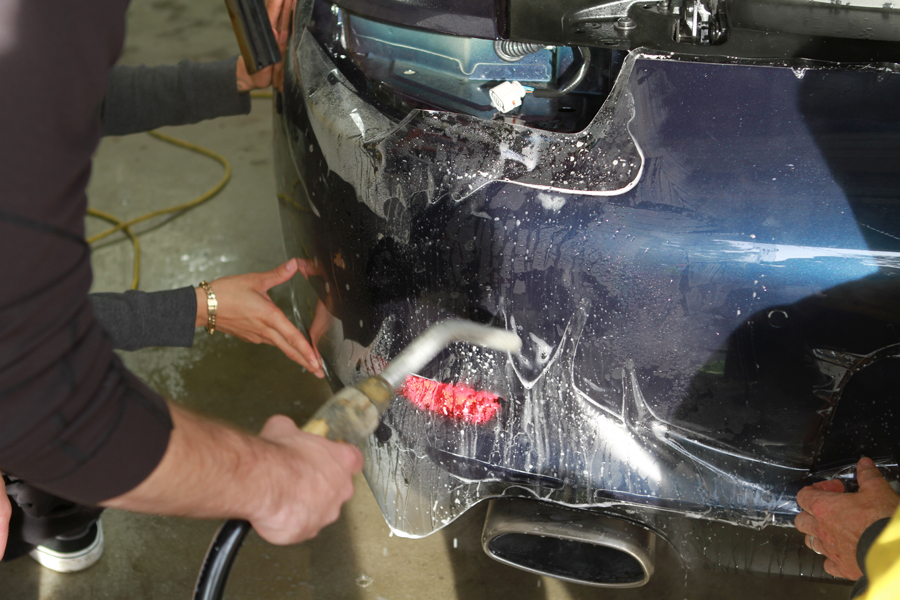

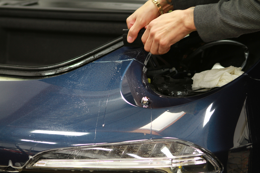

What sets our application apart is attention to detail. Every panel that is to have film applied goes through a process of paint decontamination and paint correction. All imperfections such as debris, tar, tree sap, swirls, scratches, etc. are removed to best of our ability. We also touch up small rock chips as well. This assures us a pristine surface that is optically void of imperfections.
We use a unique technique of steaming the film to allow it to properly wrap around complex curves. This allows us to push the envelope and have few relief cuts as possible

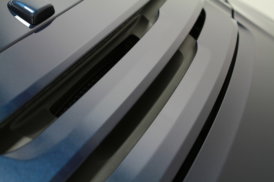

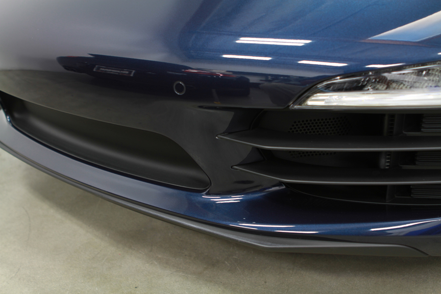

Clear film installation complete

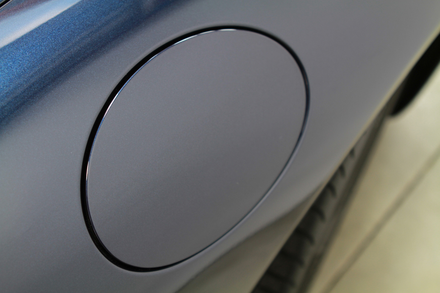

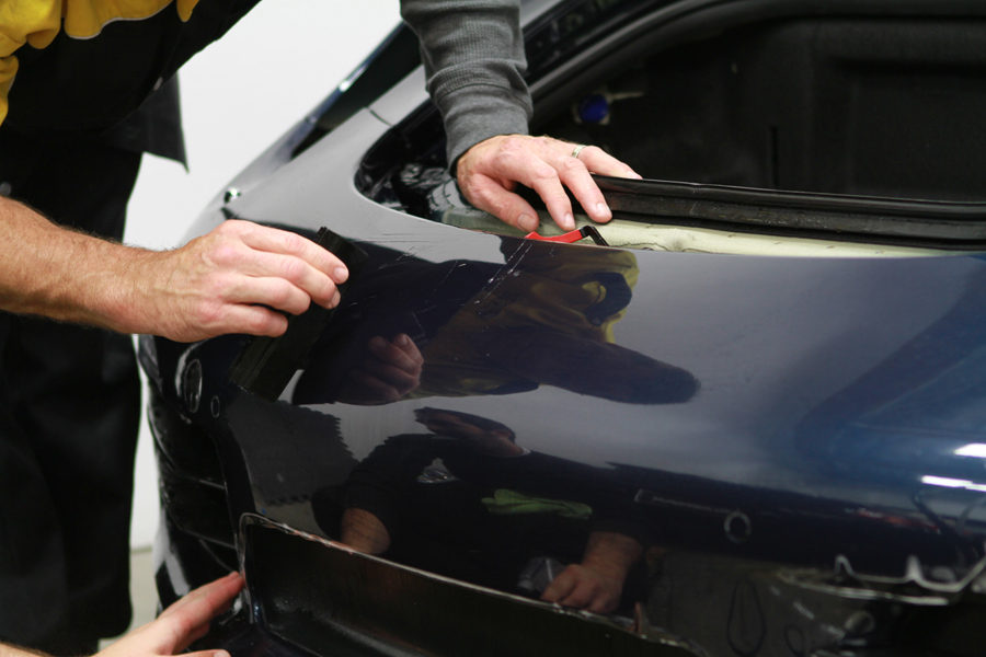

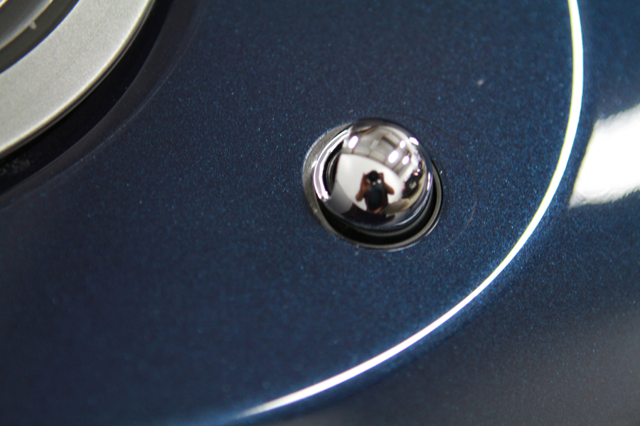

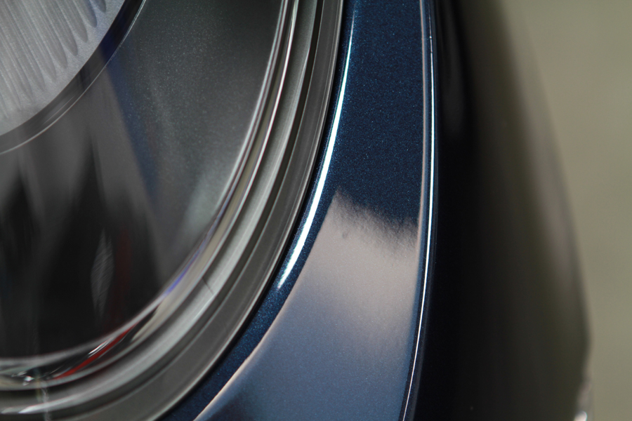

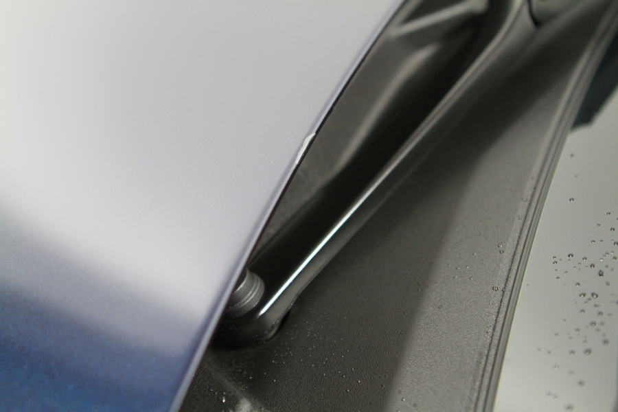

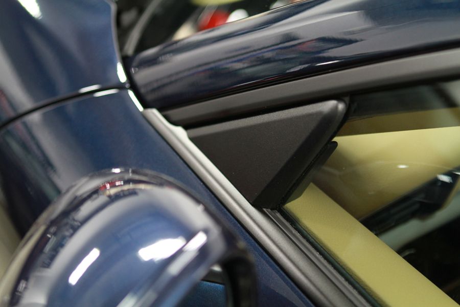

Fuel door wrapped and tucked around. Most installs only come to the edge of door leaving the film with exposed edge

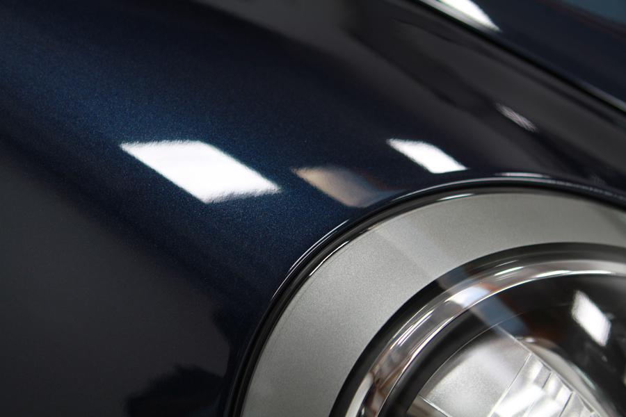

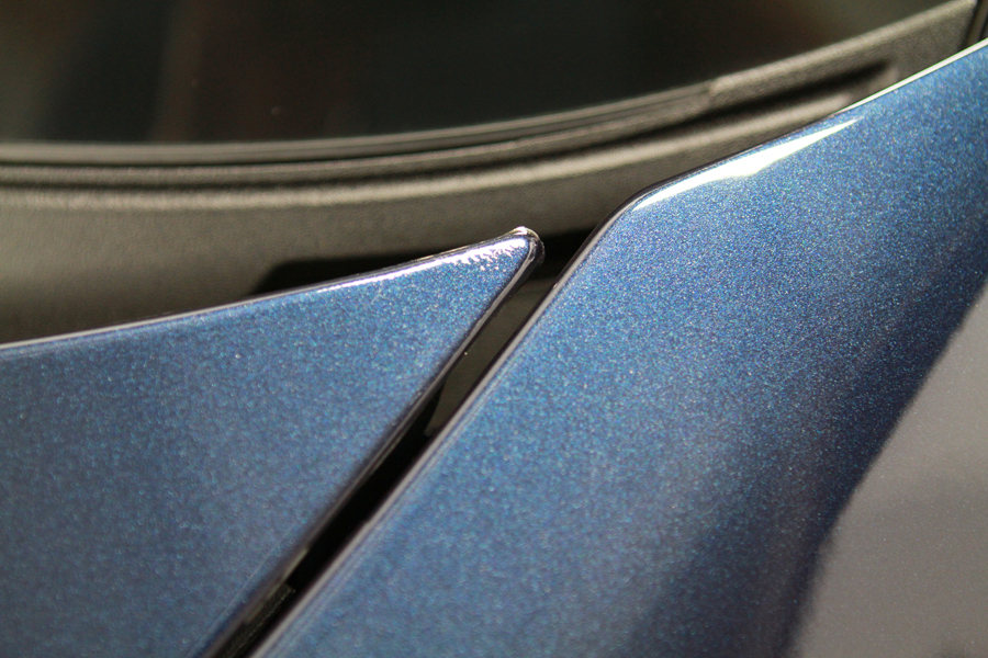

Close up - top corner edge on hood and fender intersection

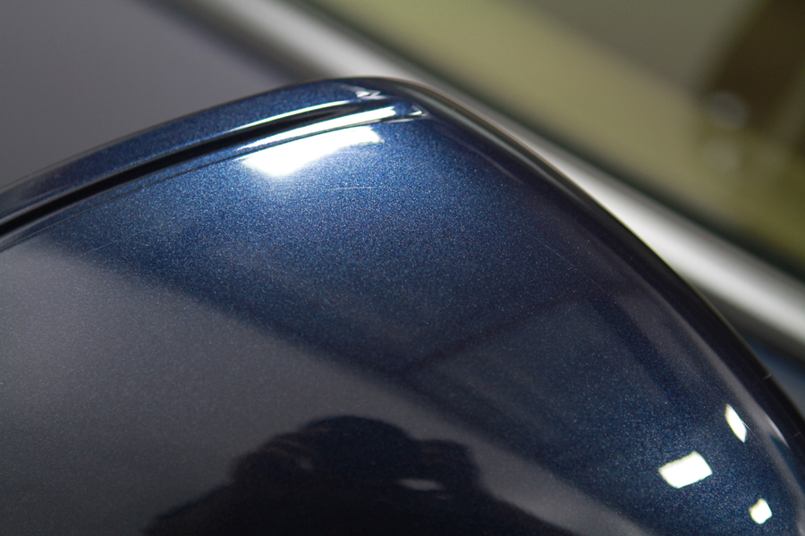

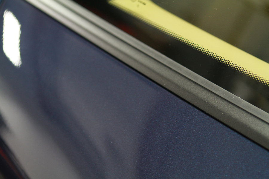

Film wrapped all around the mirror, instead of partial from previous install. Since Xpel Ultimate is so optically clear, the cut marks from previous install show through

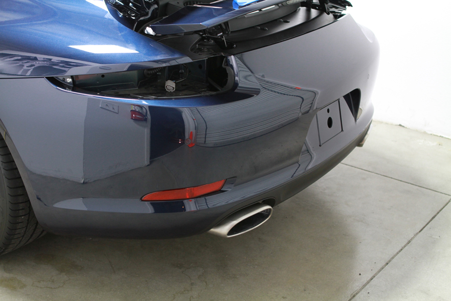

Rear bumper tucked in properly. Tail light will later be polished to remove light scratches

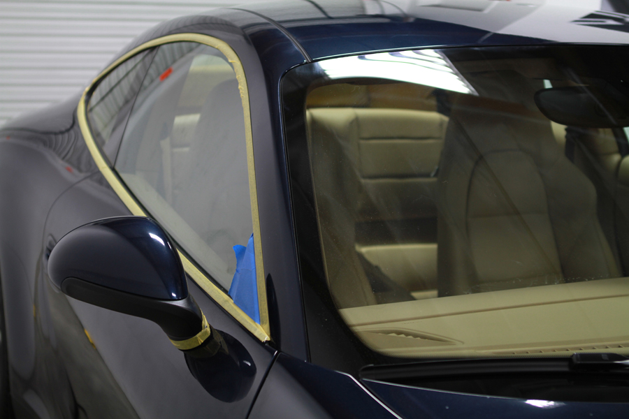

Exterior taped up and ready for machine polishing

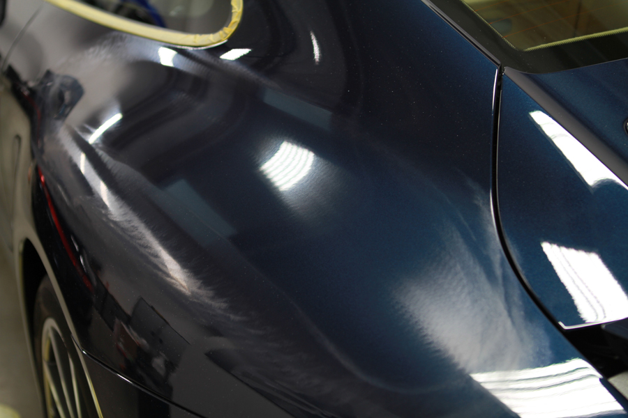

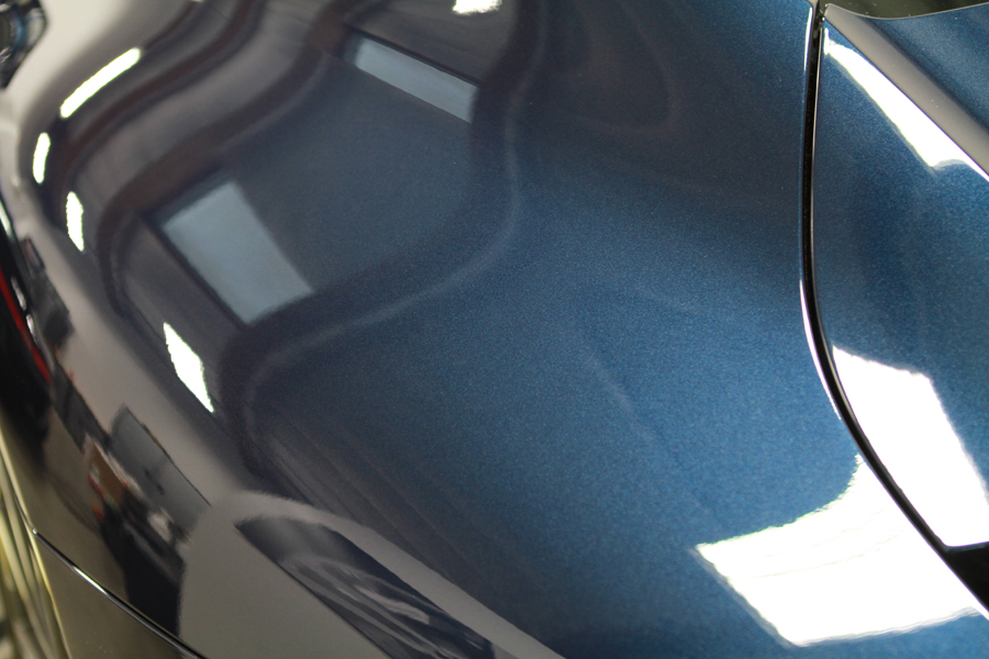

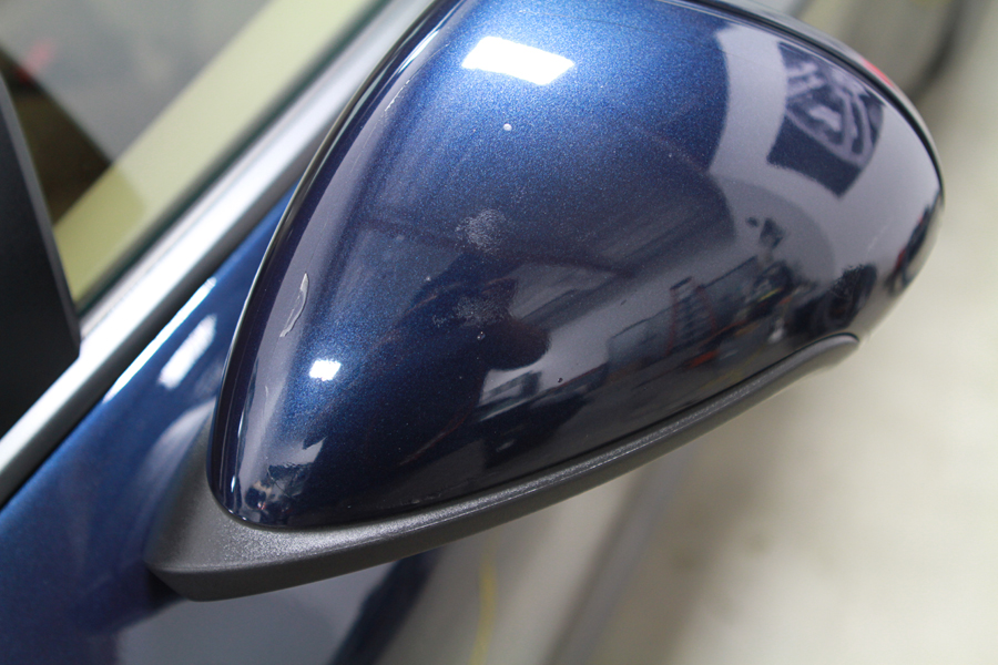

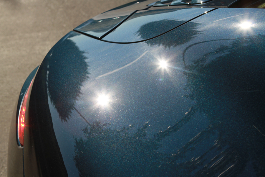

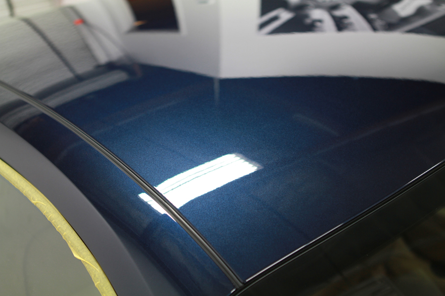

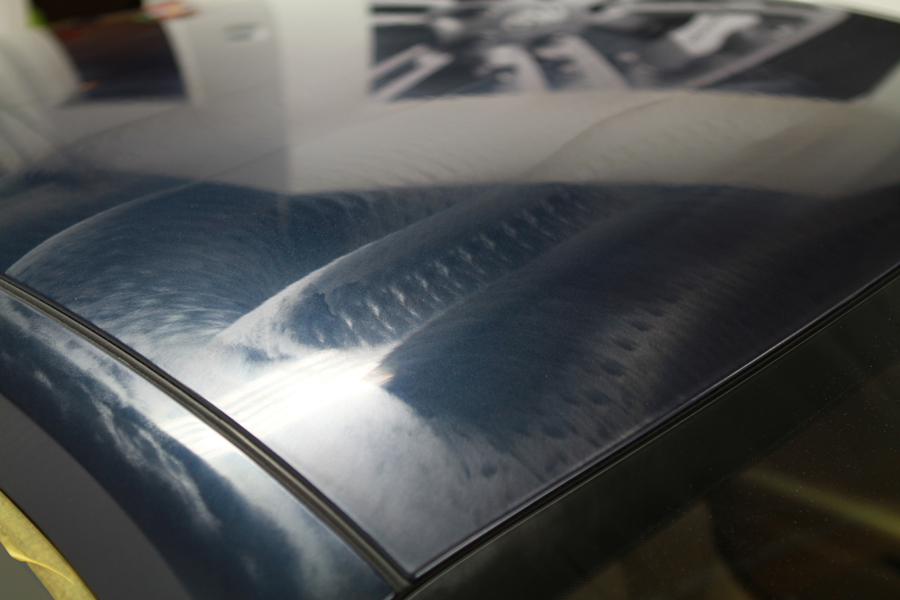

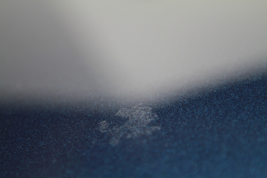

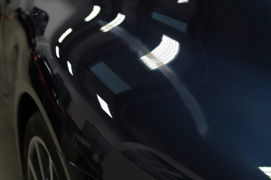

Some bird droppings etched certain areas on roof

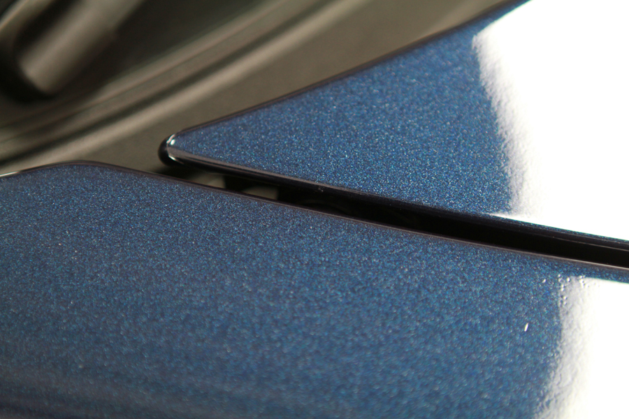

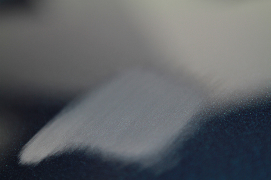

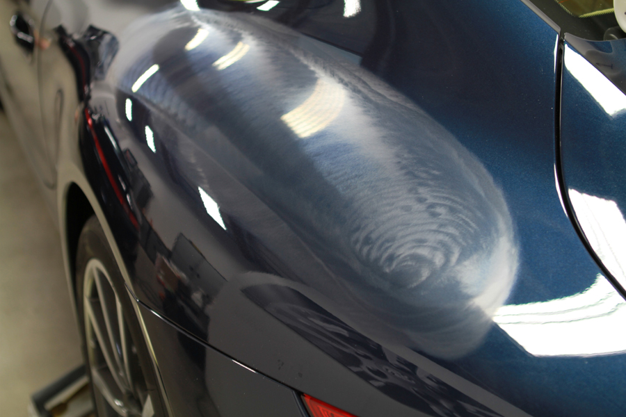

Light sanding of paint

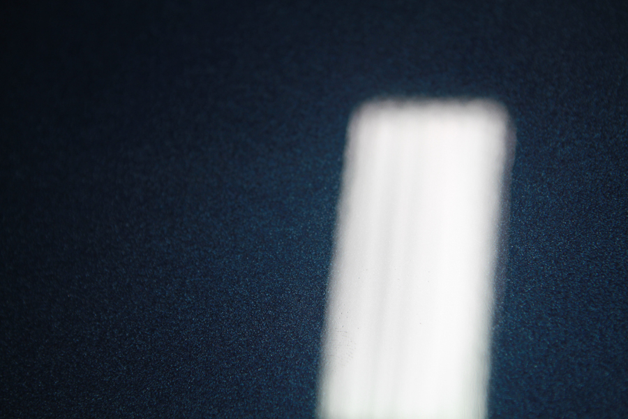

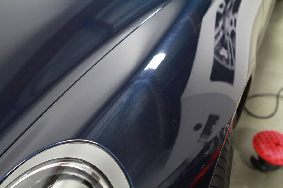

Sanding and polishing complete

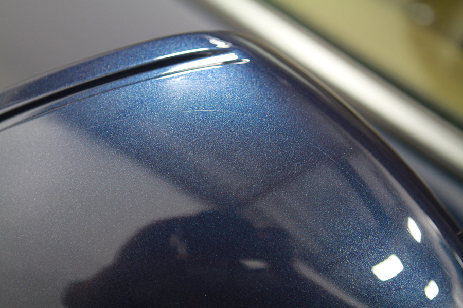

A very deep scratch required light sanding as well

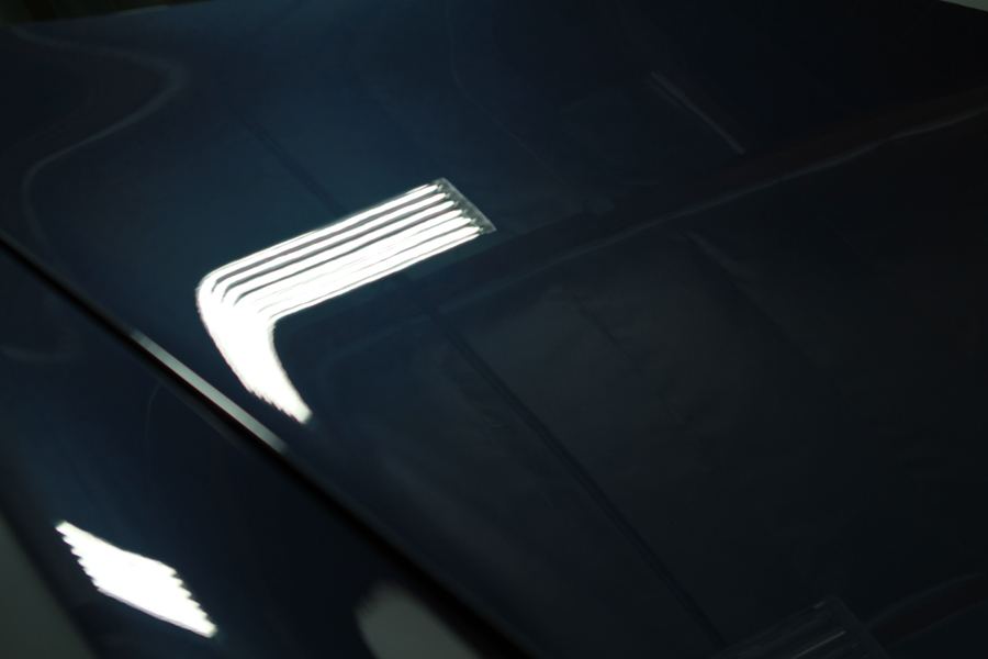

Compounding paint
Polishing paint
Complete

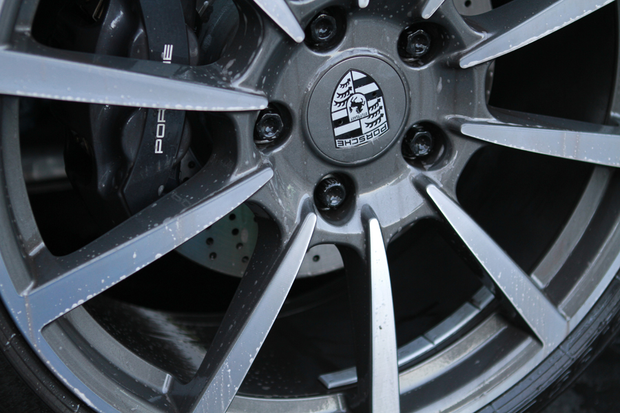

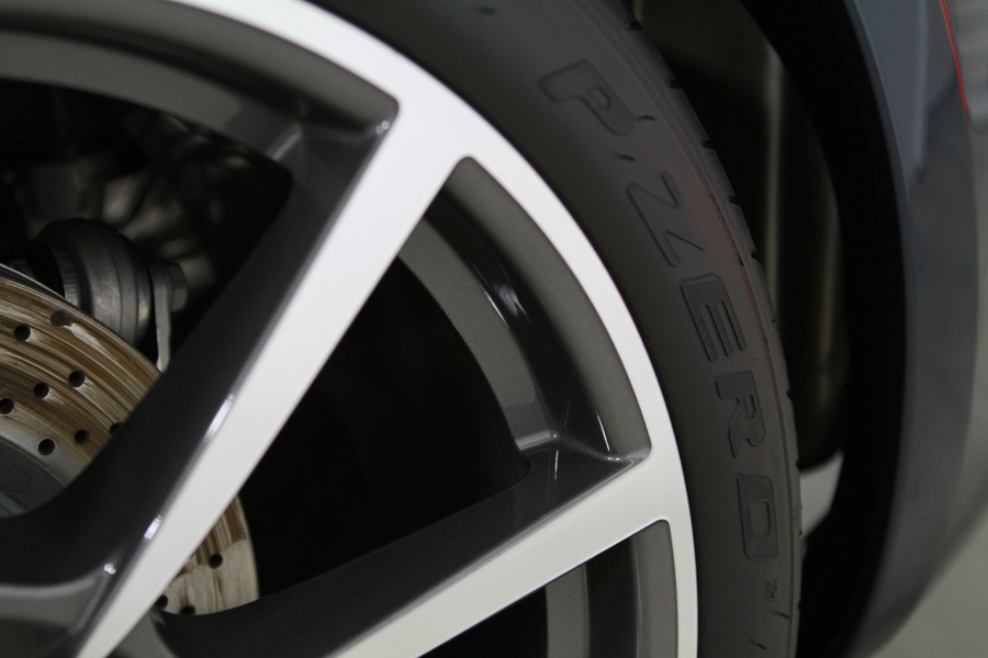

Wheels are cleaned and waxed
Tires are cleaned and conditioned

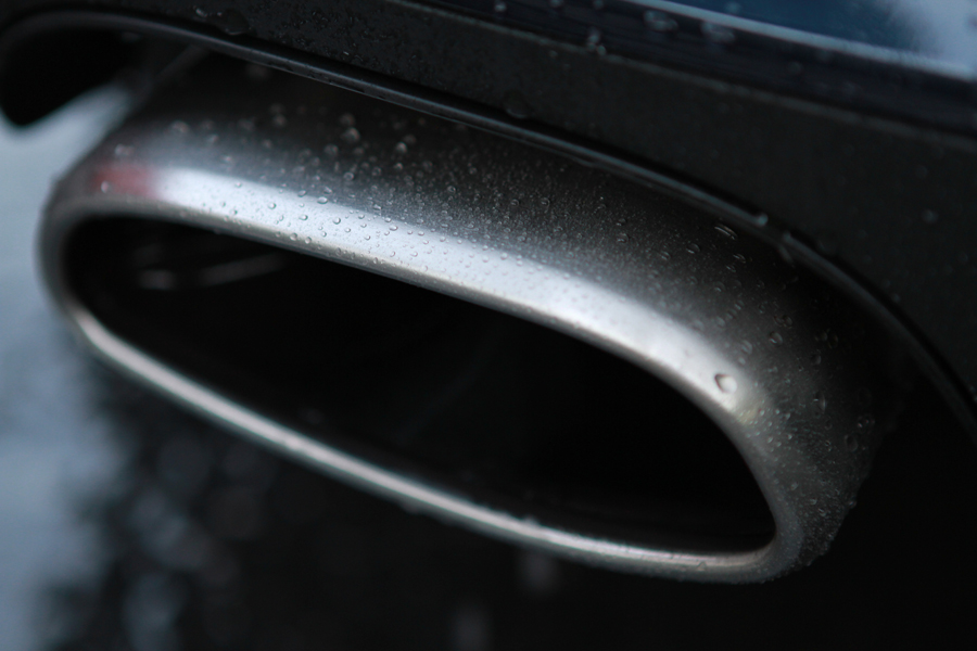

Tail pipes polished

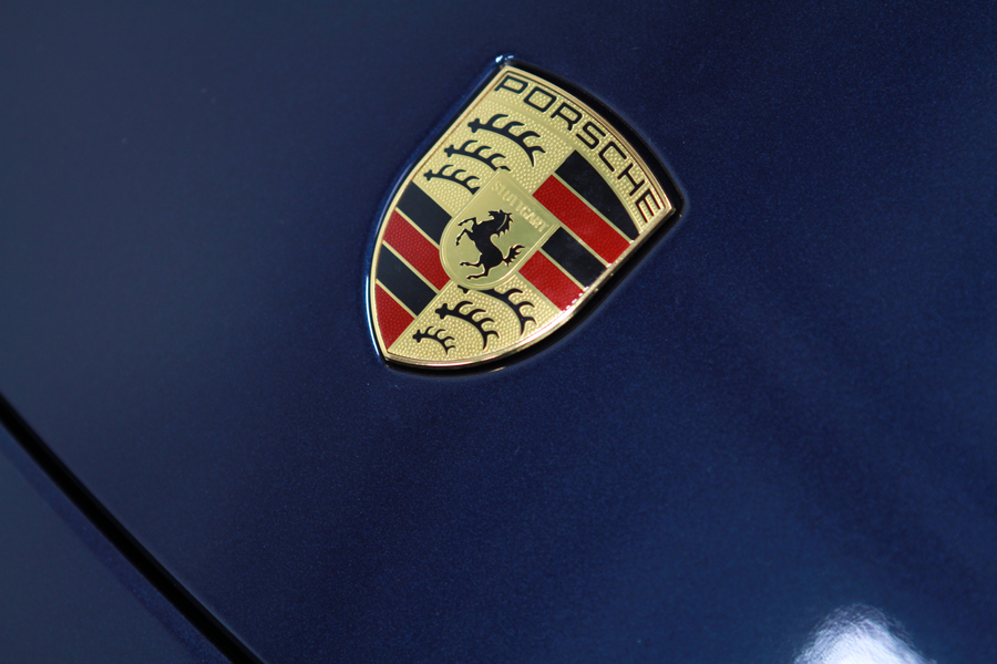

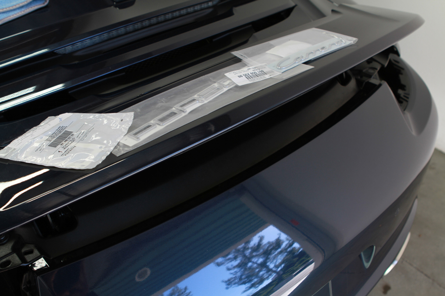

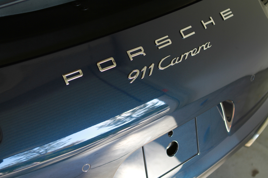

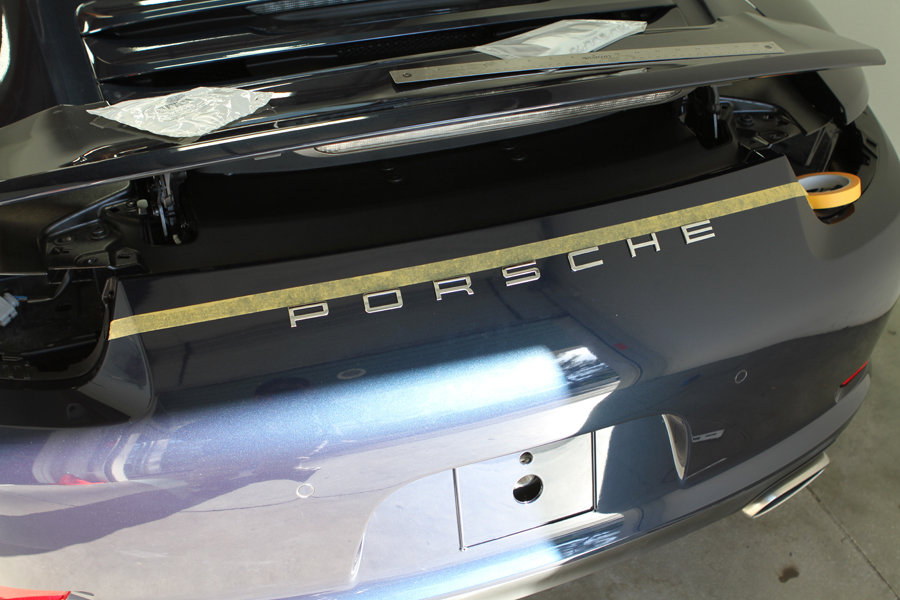

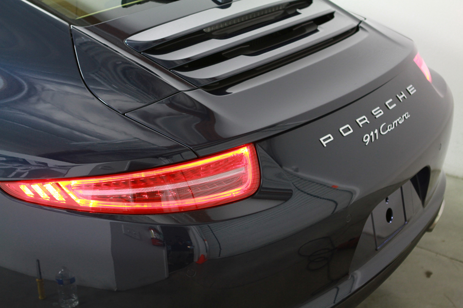

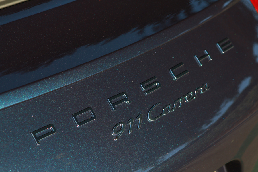

We only use genuine Porsche replacement emblems
Porsche doesn't make it easy to replace these things. Each letter has to be placed back into correct spot. This is when attention to detail and experience comes in

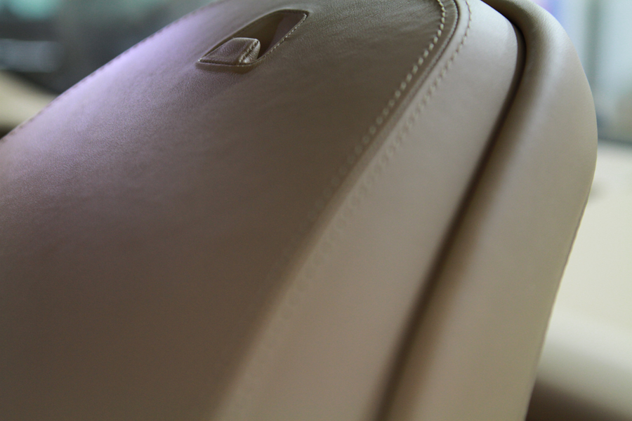

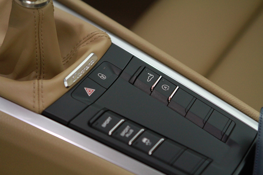

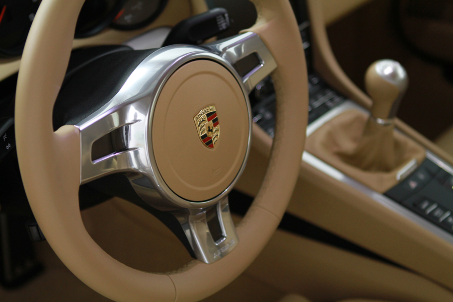

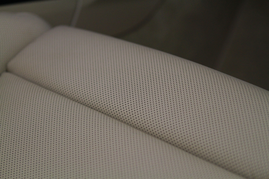

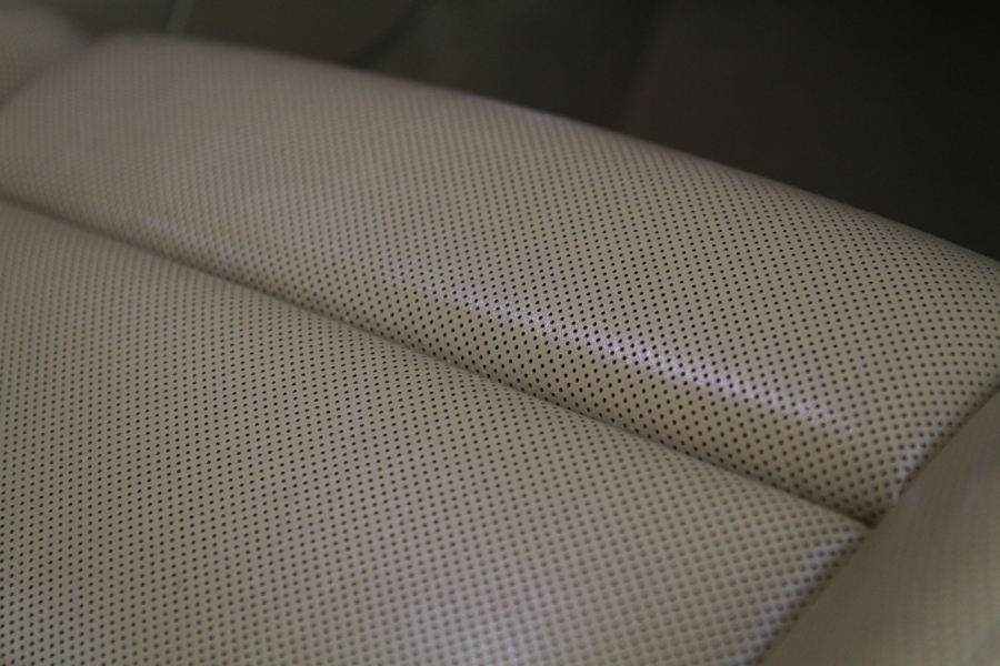

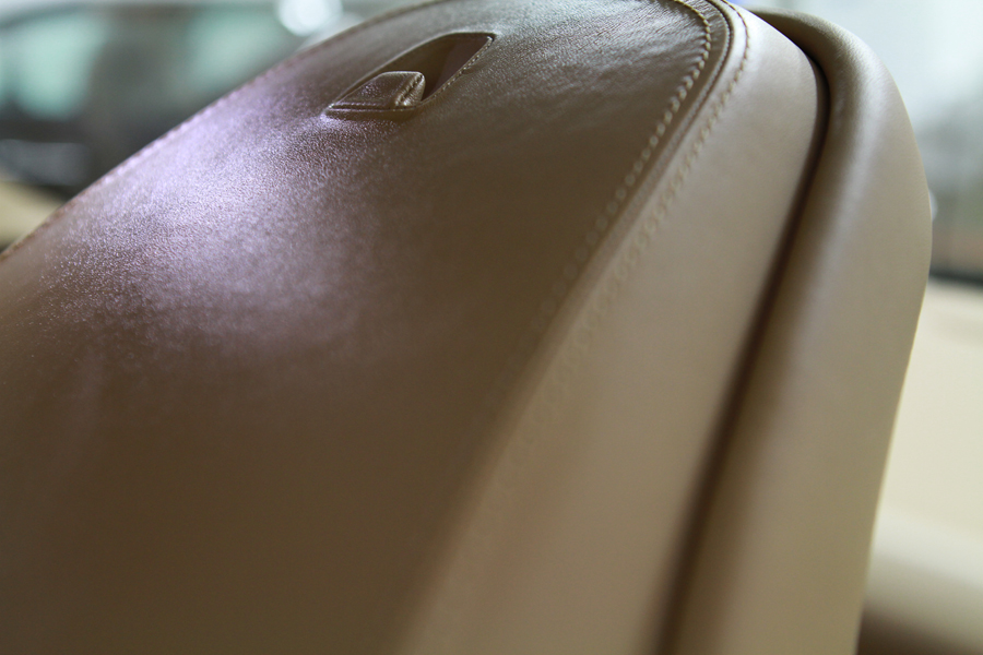

After a proper vacuuming of interior, leather is cleaned using an All-Natural Leather Cleaner
Ready for leather conditioner
Leather conditioning in progress
Once conditioner is absorbed in leather, all that remains is a supple feel and a clean satin look

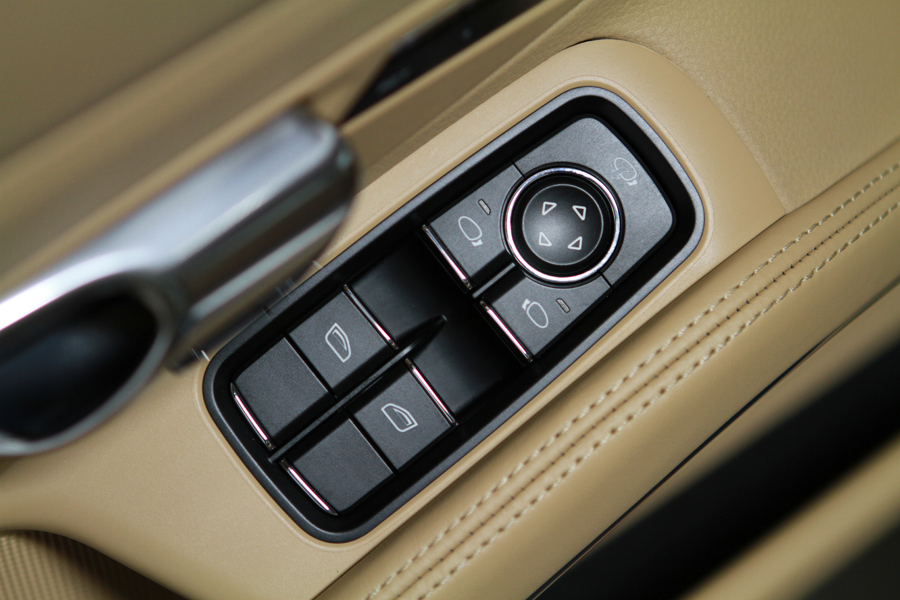

All plastic and vinyl surfaces cleaned and conditioned

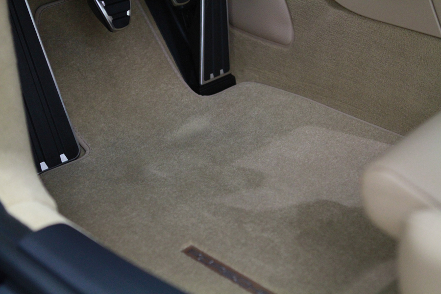

Carpets cleaned

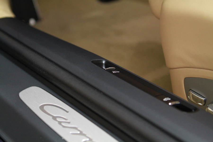

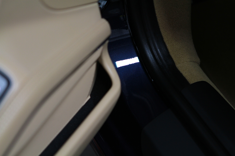

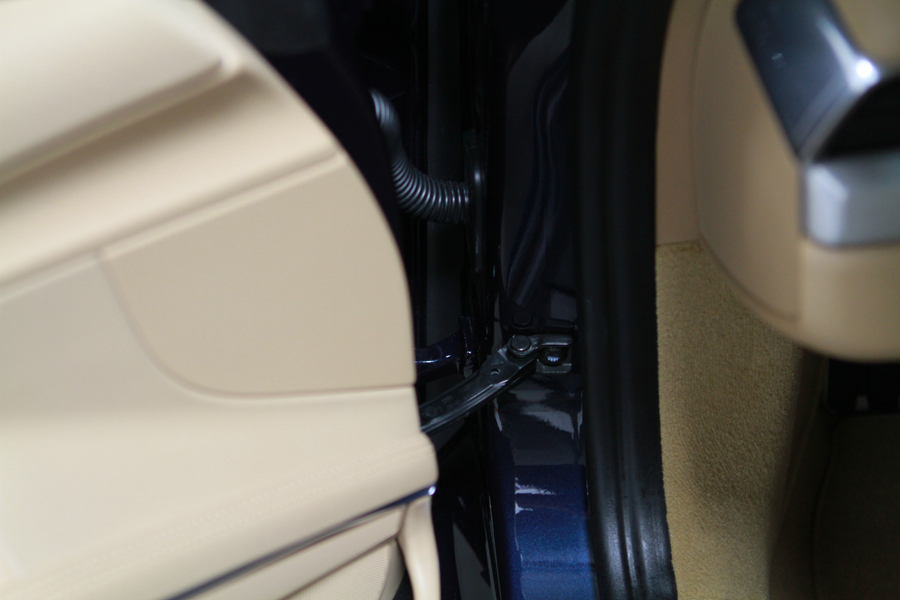

Door jams cleaned and waxed

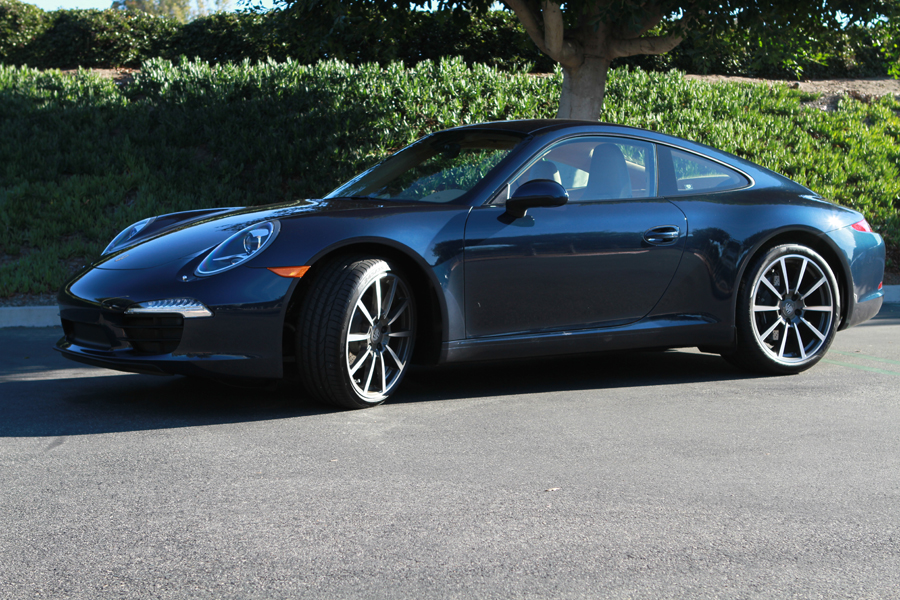

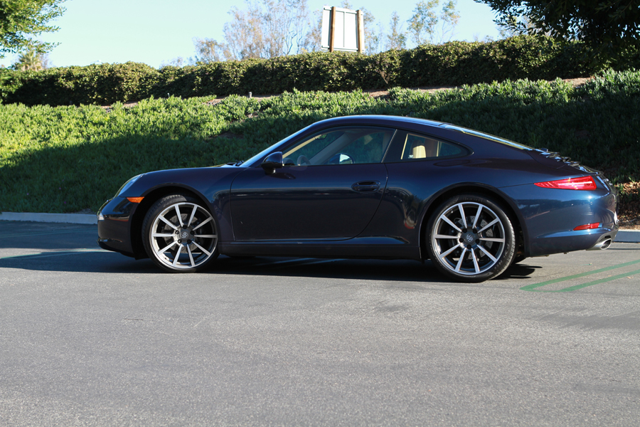

5:30 AM...We delivered this 991 to our client at Cars and Coffee. She was joined by a 993 and 997.2 that day. It was a chilly 34 degrees; too cold for us SoCal folks
