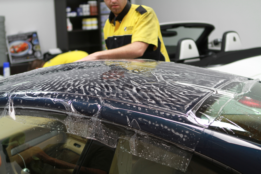

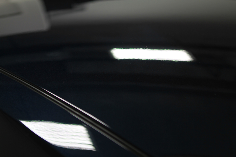

Thumbs up Update: 3-29-13
Client came back a few weeks after the renewal service. Unfortunately, the areas on the roof that were sanded down, re-appeared. This was quite puzzling as the damaged clear coat was removed. It turns out, the acids in the pelican droppings were re-activated with moisture. This could have been done with the moist air, rain, or a simple wash.
We weighed our options:
1. Repaint: Several pros and cons, and a cost of around $1600
2. Sand the roof again and see what happens
3. Sand the roof and apply a temporary film piece to see what happens
Two weeks later, client reported back the stains have not reappeared on both sanded areas and sanded/temporary film applied area
Client ended up opting for option 3, temporary piece removed and custom piece applied, as this will protect the roof from future "accidents" by those pesky pelicans

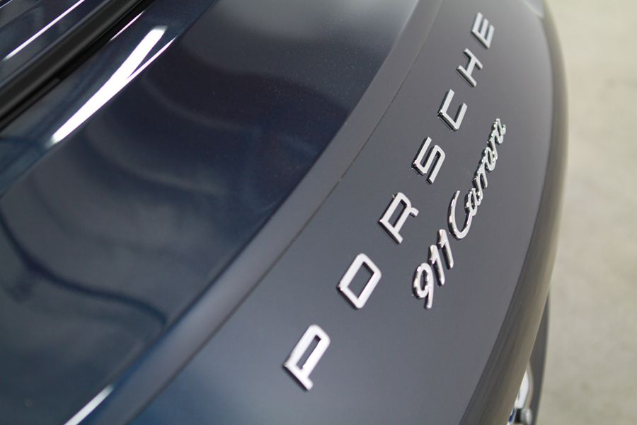

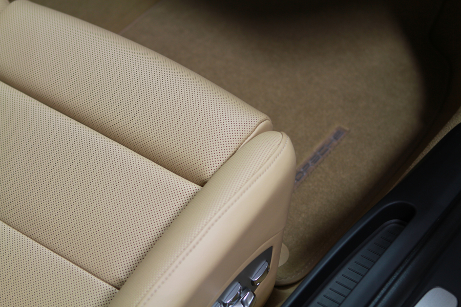

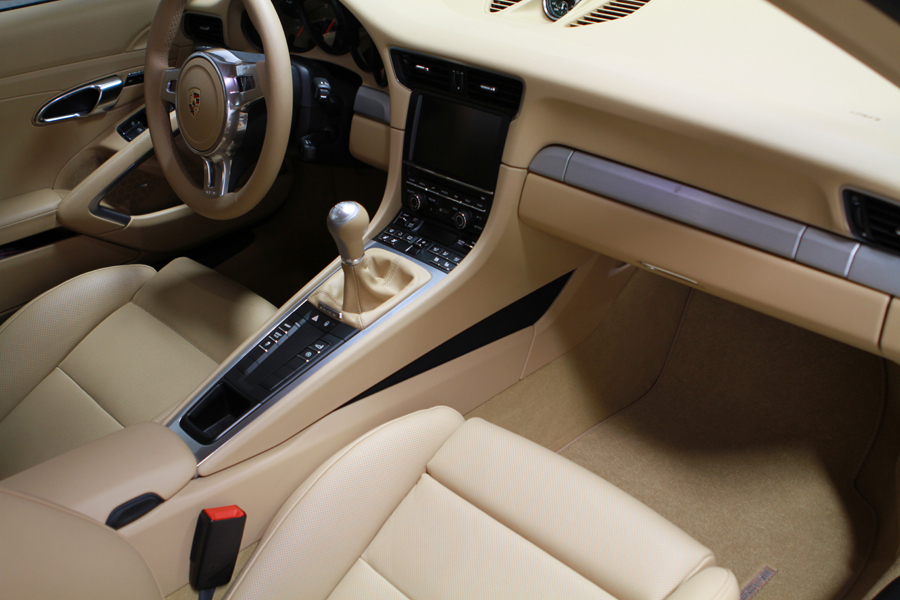

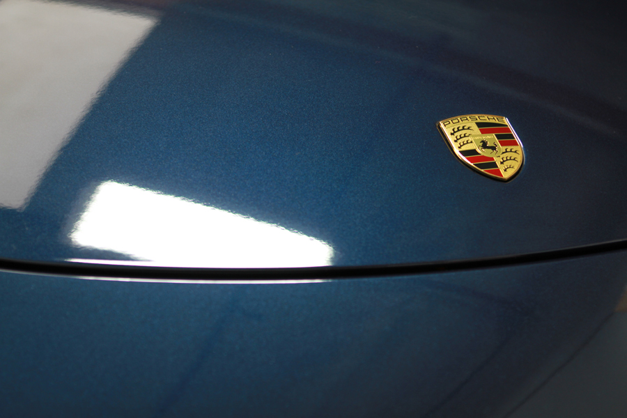

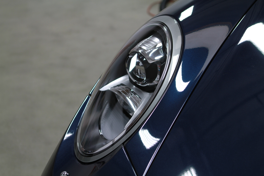

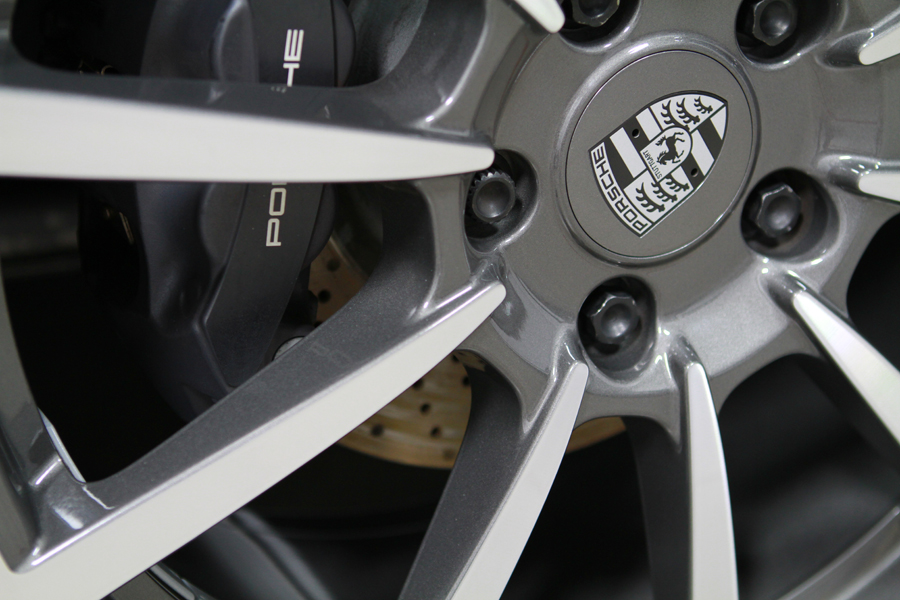

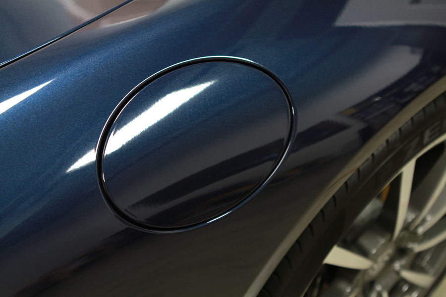

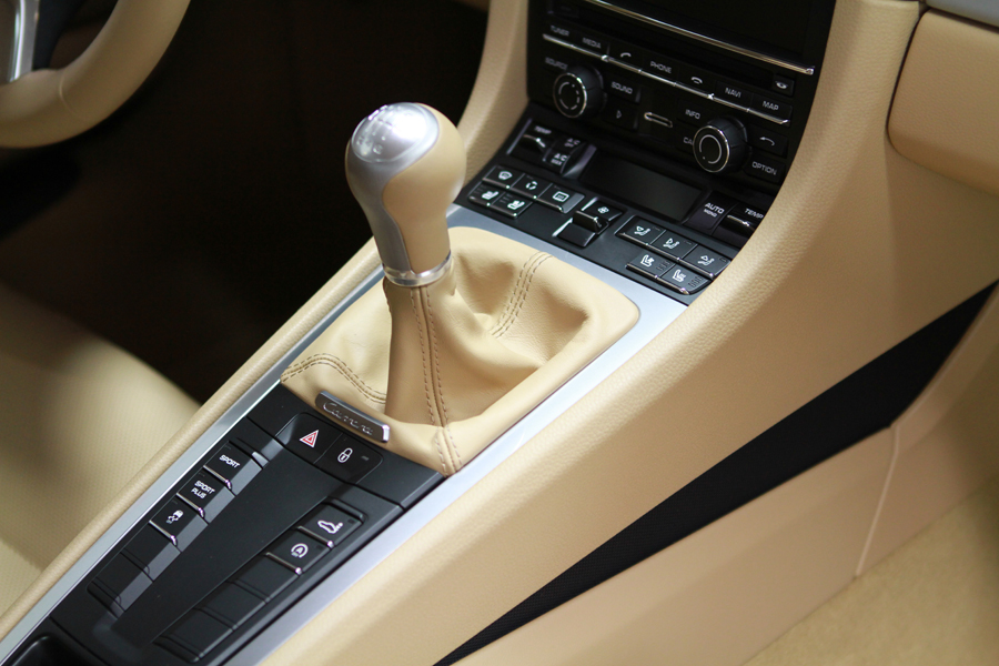

Hard to believe six months have passed and this 991 is back for her renewal service. As you can see, with proper care, proper prep, these cars look amazing and a quality renewal service lasts the battering of mother nature.

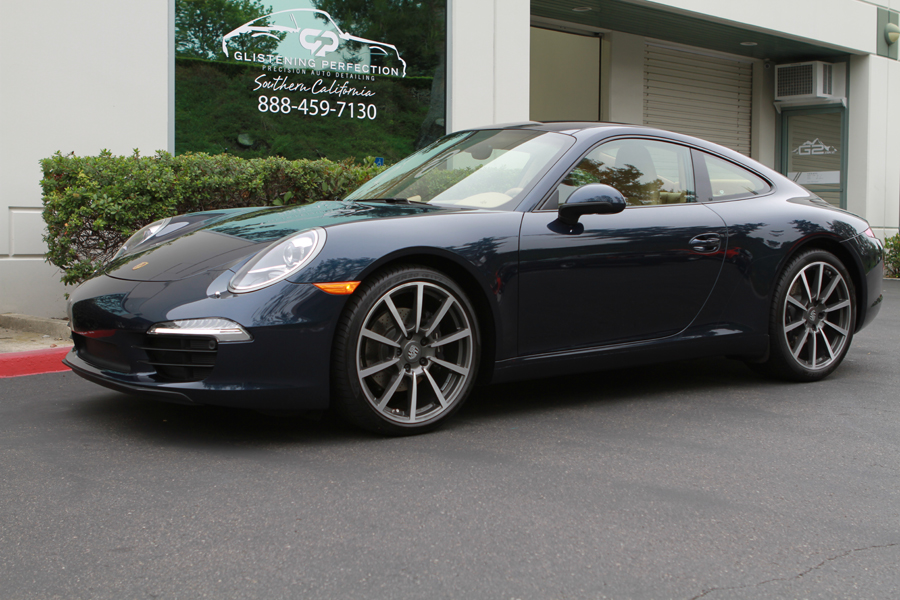

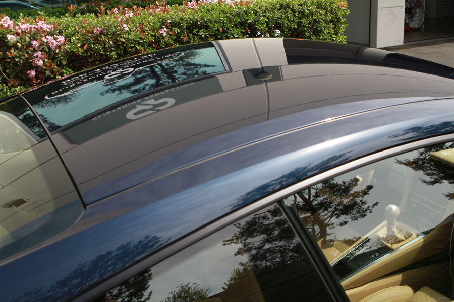

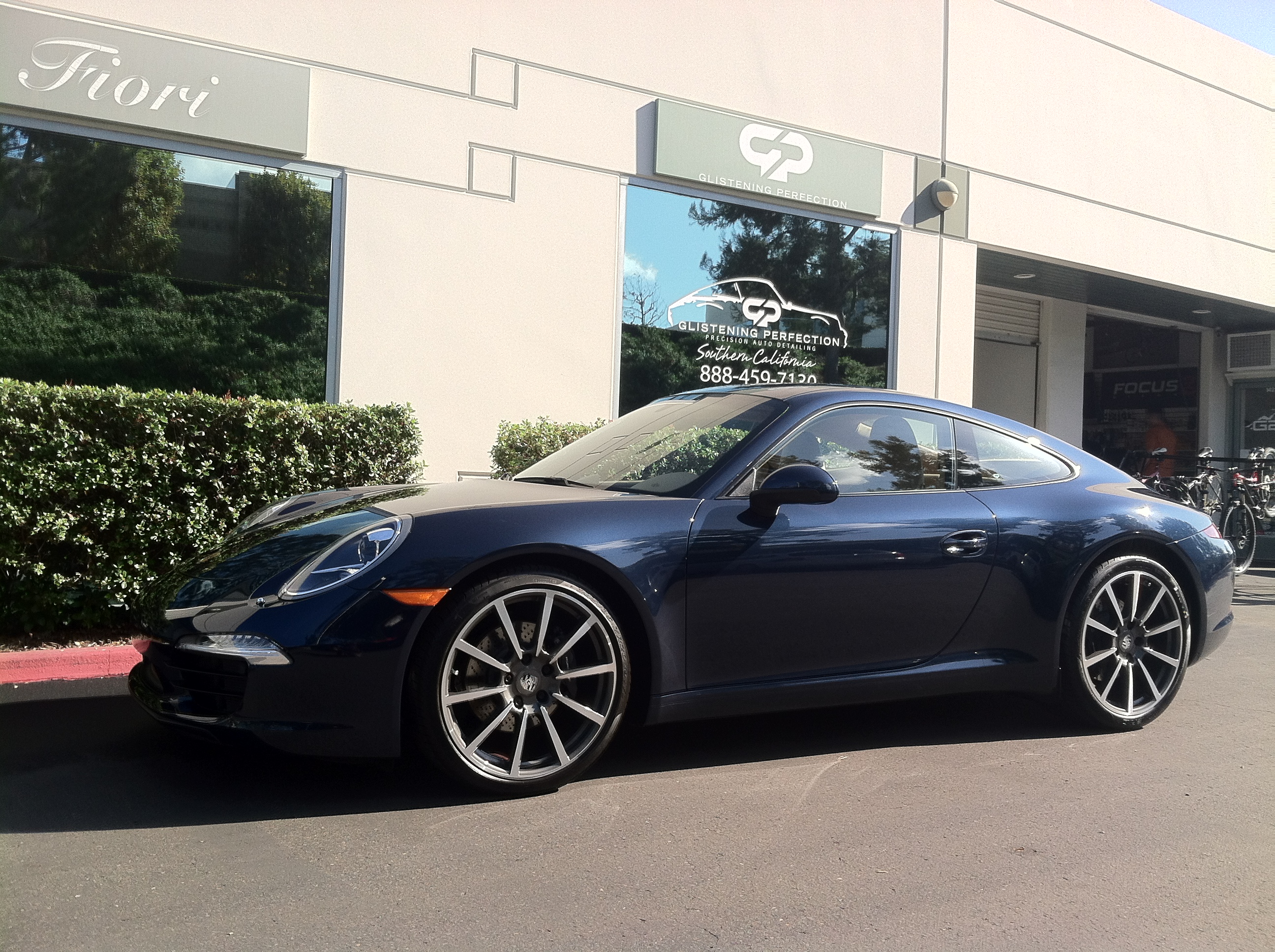

Here she is one year since we first saw her. Aging very well.
