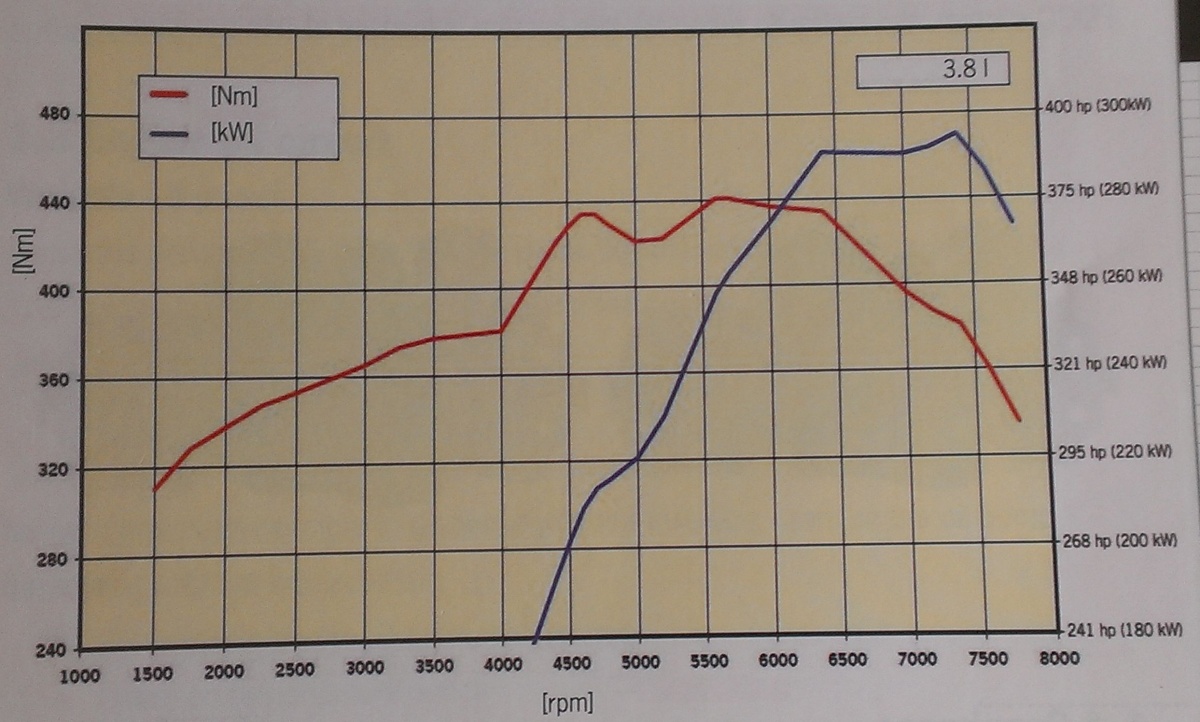

Runner is right and that's why I made my comment earlier to take it to another dealer as some dealers, like Boardwalk Porsche in Dallas, are more aggressive, industrious and persevering at finding challenging problems. Just make sure they are not biased by the knowledge that someone else has tried to fix it and failed.
BTW Attached is the torque / power curve. The car should respond relative to the RPMs shown. Note that the slope of the curve is much greater at 4000 (probably why the RPMs are allowed to spin up to near there for quick starts in a PDK equipped car).
ChuckJ
