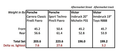

If you want track wheels, I would strongly recommend to go for 19" as they will be lighter, but most of all, they will be a lot cheaper and offer more options (very few track tires are available in 20").
The only 20" track tires you find on Tire Rack for the 991 would be PZero corsa that will cost you $2,200 a set. Go for 19" and you can get Toyo R888's for $1,300. I am running aftermarket 19" on the track with 888's and found it to work perfectly.
I would personally keep the Carrera Classic as a Winter set. Run them with spacers (5mm front, 14mm rear) if you want them more flush.
As far as weight is concerned, here's what I have measured myself:
thanks SM! that makes sense. any aftermarket brands that you recommend?
