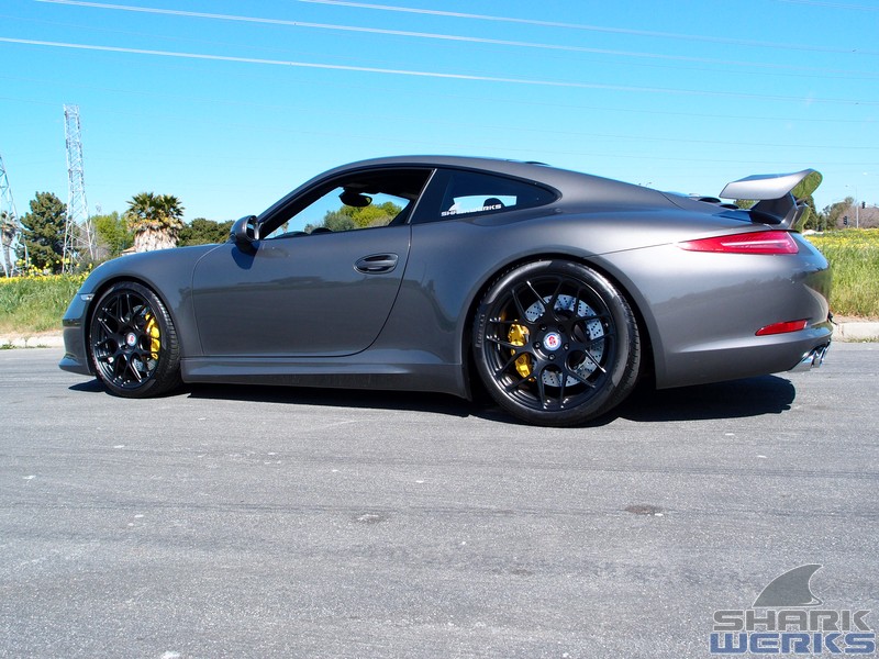

This agate grey SharkWerks project 991S graced the cover of Total 911 Magazine Issue 97, titled "991 Perfection" but that was round one. For a second helping an even lighter-weight set of HRE P40SC wheels and larger 380mm Brembo Brake kit was on the menu:
Just a quick test fit of the satin black HRE P40SC's...

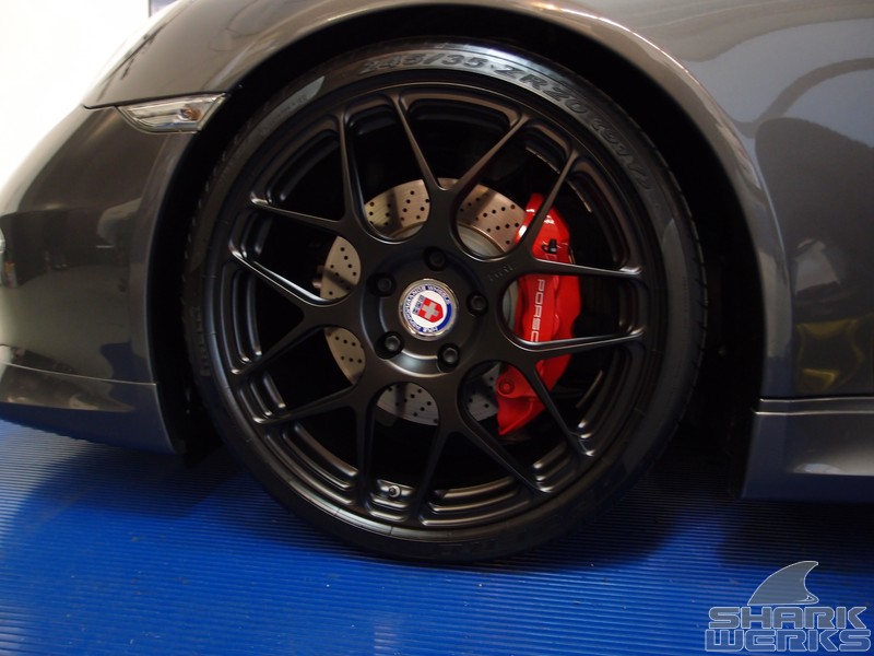

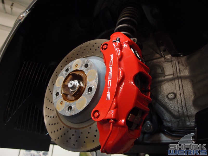

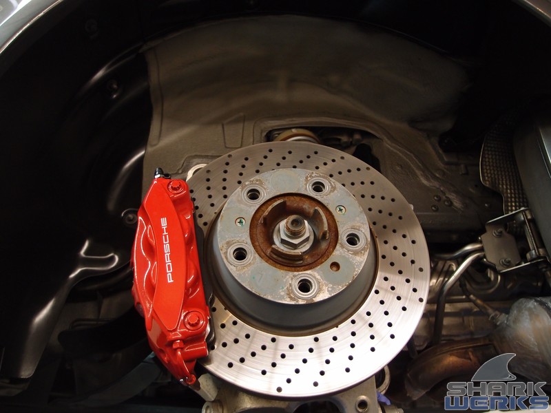

Factory 4-piston rears:
And 6-piston fronts straight off of a Cayenne:

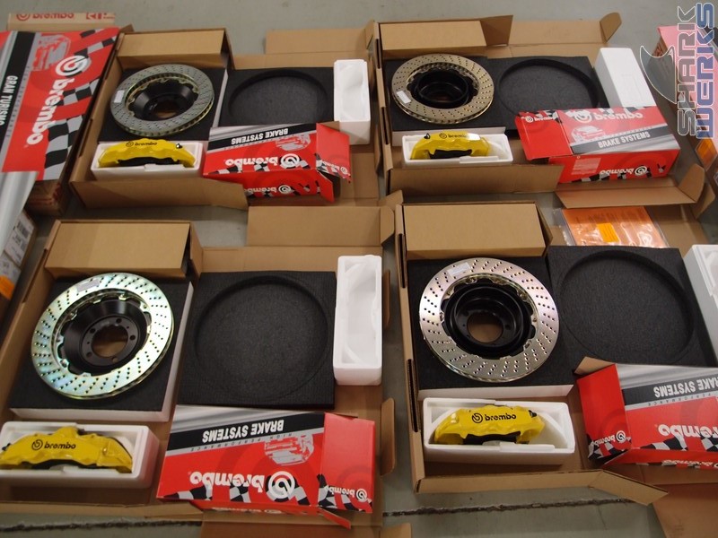

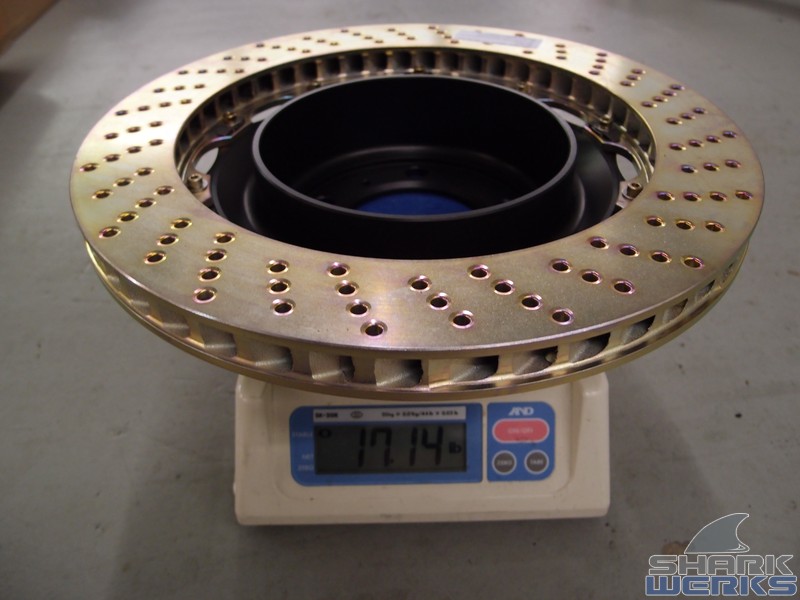

The Brembo big brake kit laid out. Including 380mm replacement rotors, SS lines et al:

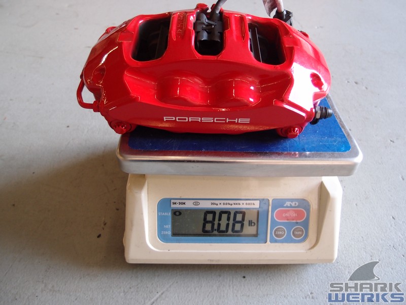

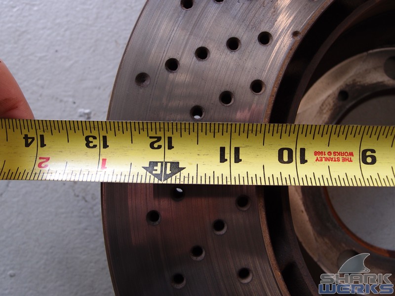

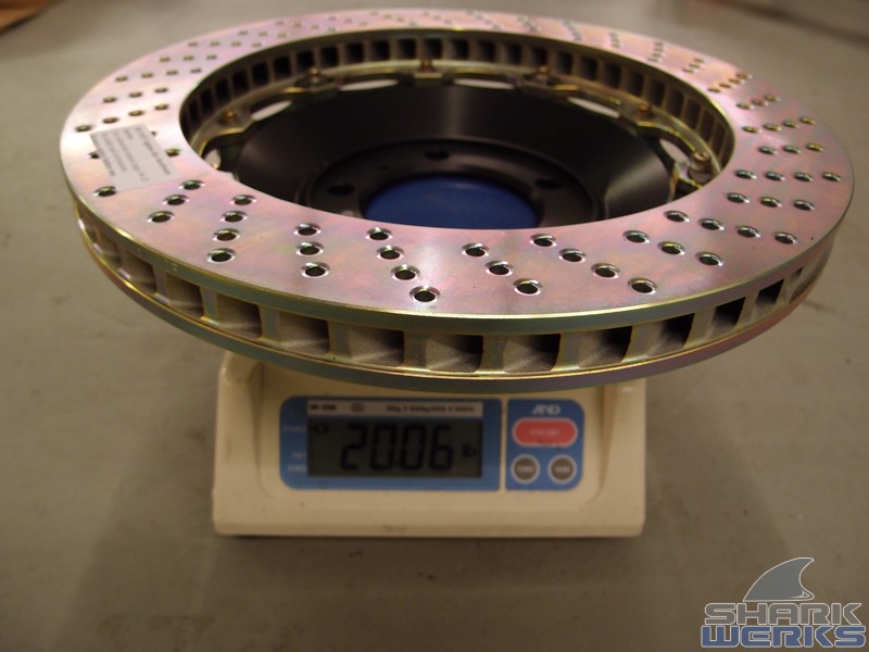

Not only are the new rotors significantly larger vs stock but their two piece design (aluminium hat) is also lighter of course. So for those of us 911-weight watchers out there.... here come the fronts at 20.1 pounds:
vs stock 23.8 pounds

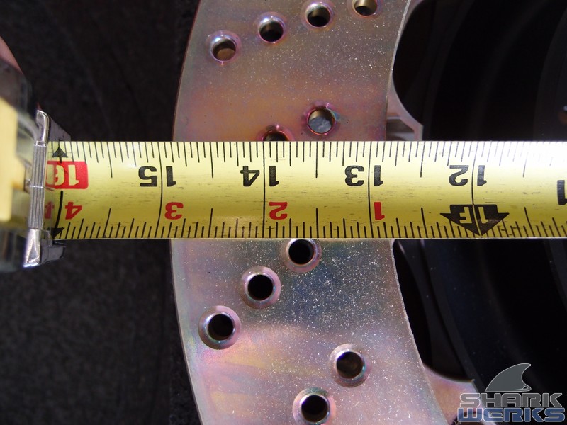

Front measurement
vs stock:

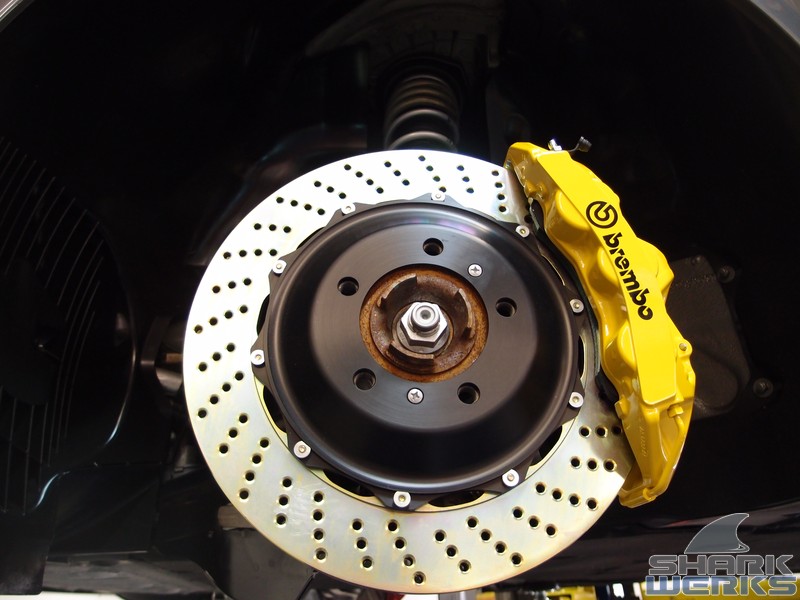

Front assembly installed:
Now the rears at come in at 17.1 pounds:
vs stock at 19.33 pounds
Rear measurement:
vs Stock rear:

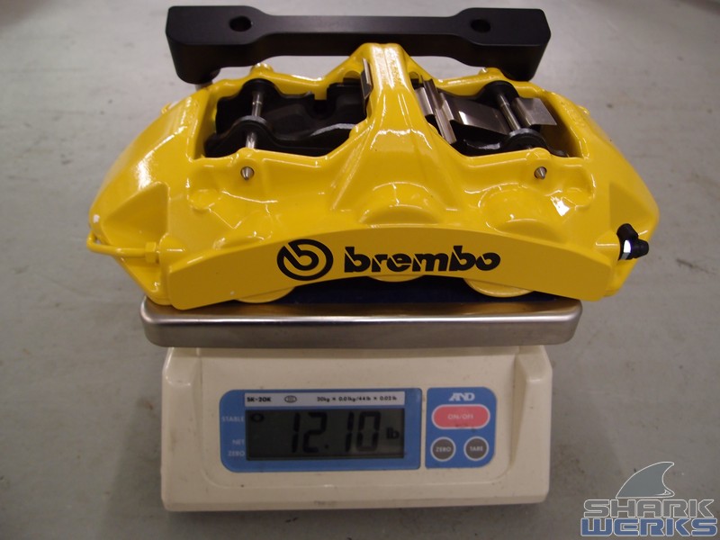

Larger calipers and improved piston design does add a bit more weight back again. The new front 6-piston Monoblock Brembo yellow calipers come in at 12.1 pounds:
vs stock 11.4 pounds:

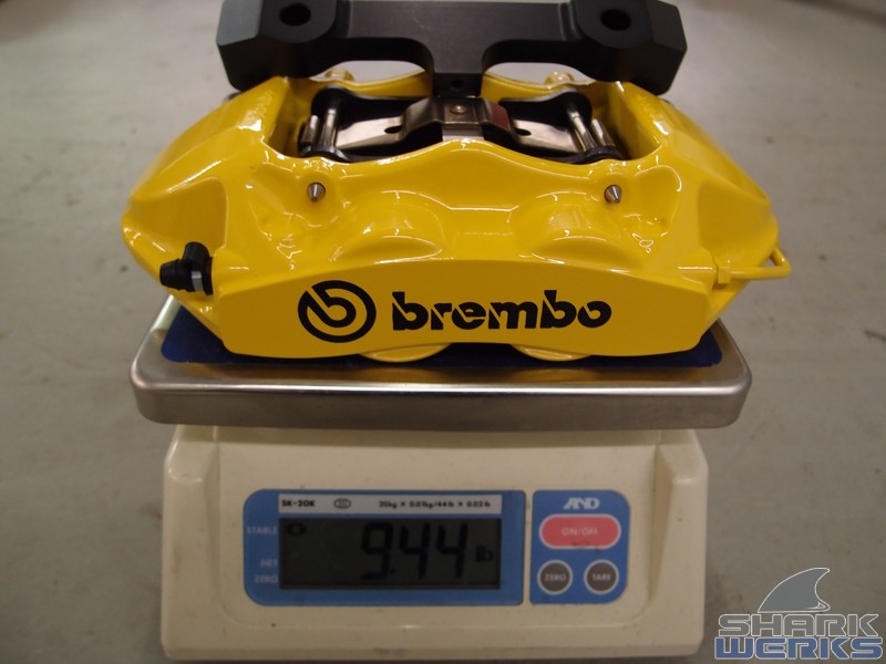

And the new 4-piston rears come in at 9.44 pounds:
vs stock 8.8 pounds:

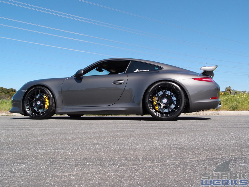

The newly released 991 TechArt roof spoiler was also added in addition to the full Type 1 conversion:

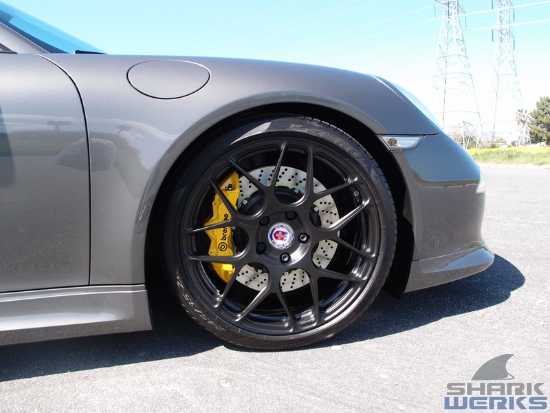

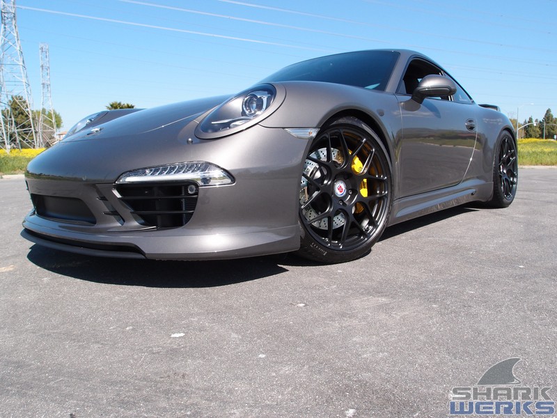

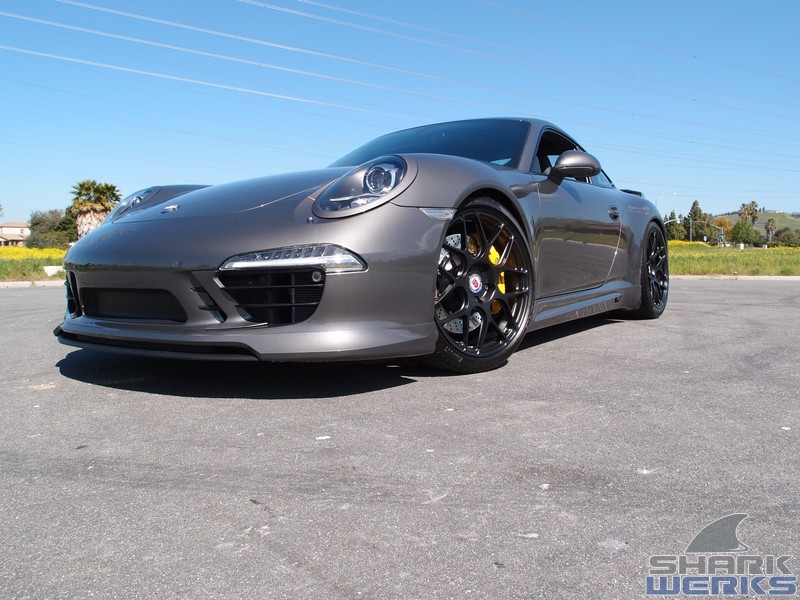

And a few beauty shots of HRE's satin black 20-inch P40SC Monoblok wheel:
The fronts:

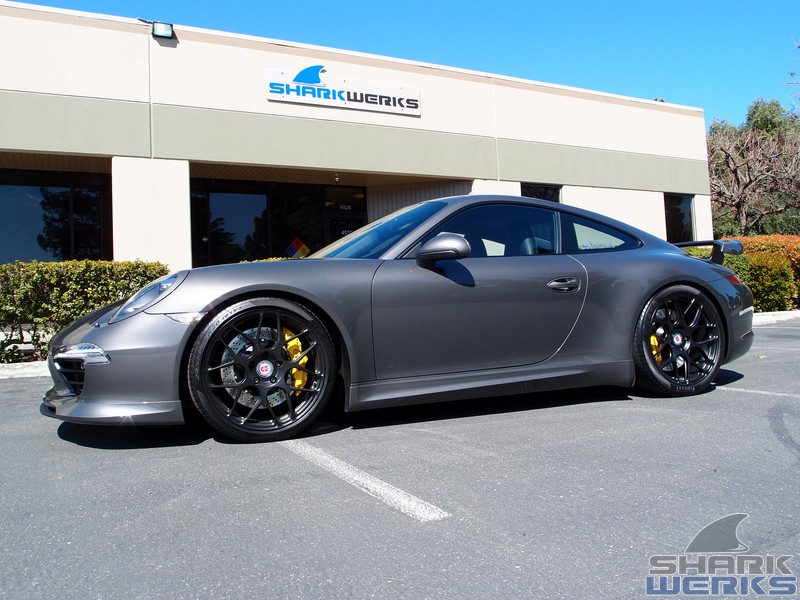

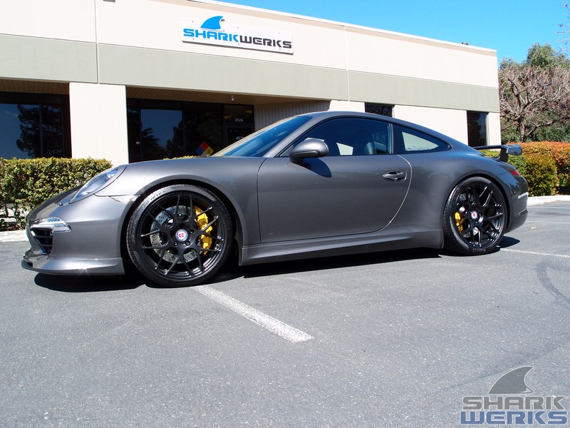

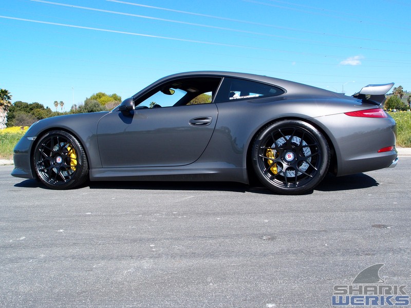

And lowered with TechArt springs:
The full monty:

Because it was early/break-in etc... it's hard to give you a full report. I can say this, the 991 calipers are light but they are carried over from the Cayenne vs the 997TT or GT3 (which is a shame). I've never really liked the Cayenne brakes.. well on a heavy Cayenne. The bite is certainly better with these replacements and more what I'm used to now on GT3s or with PCCBs. I'm a shark so I like bite The rotor diameter is significantly larger too and has better cooling properties so I'm more comfortable using a more aggro pad

Factory sizing in 20 however with more aggressive offsets to counter the lowering springs

They're about 3 pounds per corner lighter and 5 per side in the rear....
