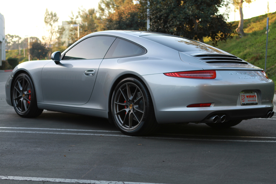

In this thread, we'll focus more on our Clear Film application. As you'll see, not all installs are created equal, and a vast amount of expertise is required to do a proper install. Sit back and enjoy
Each clear film project starts with our Phase 1 Clarification Service. When applying the film, we want to make sure the complete vehicle is as clean as possible to avoid any potential for cross-contamination

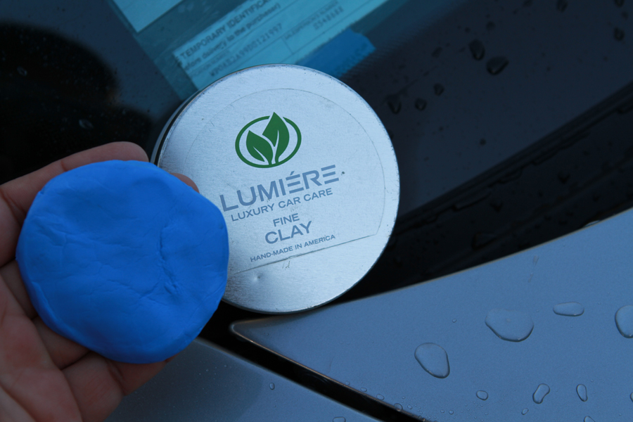

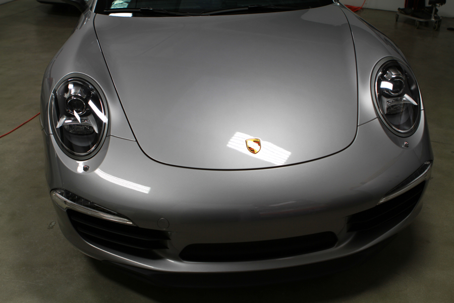

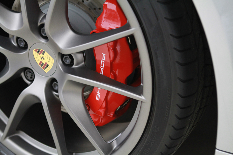

Update: 7:45am pst

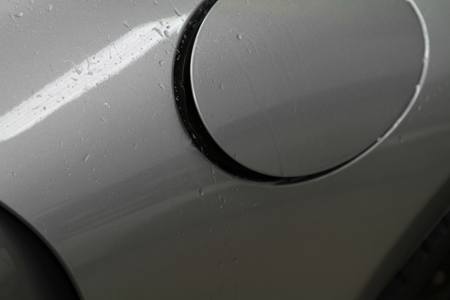

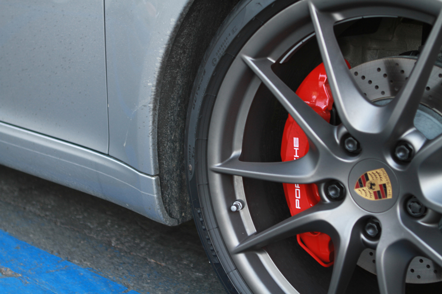

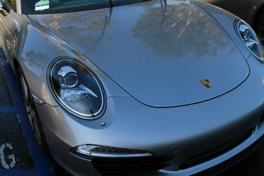

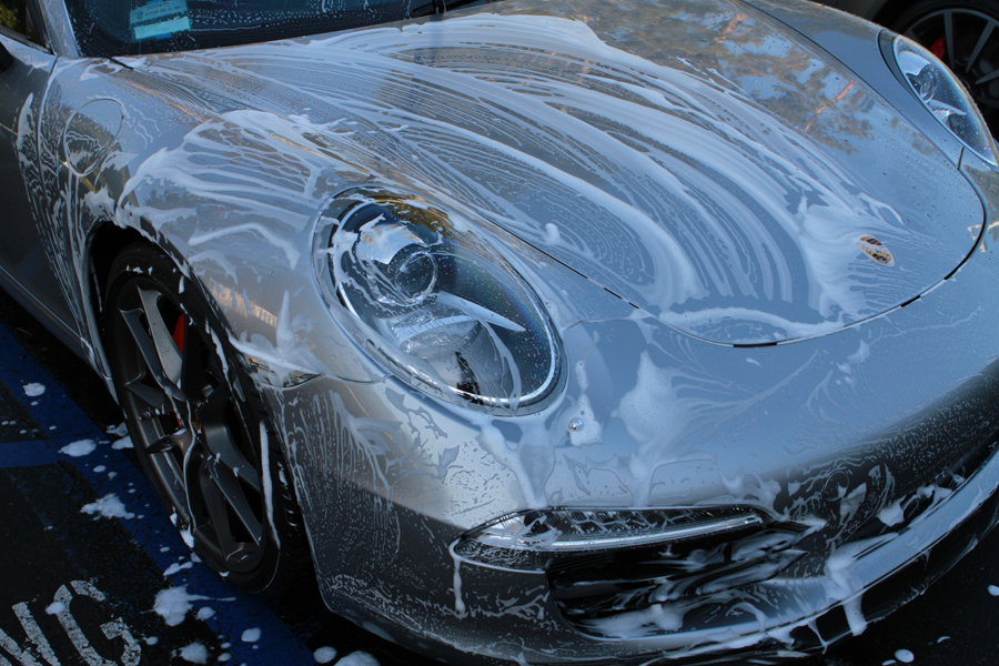

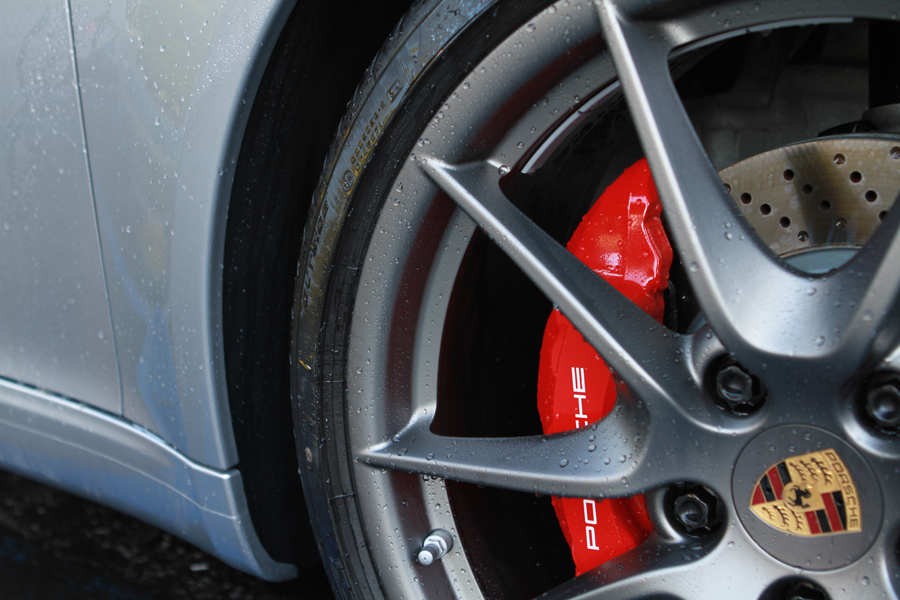

Wheels and wheel wells washed
Exterior washed

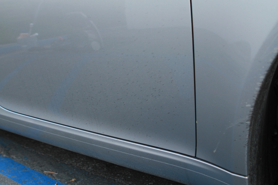

Areas to have clear film installed are properly decontaminated. In this case, since it's a new car and only a few days old, a FINE grade clay is used. Depending on age of NEW car, we may use a MEDIUM clay. Depends on how long it's been exposed to the elements
All clean and ready for pre-prep

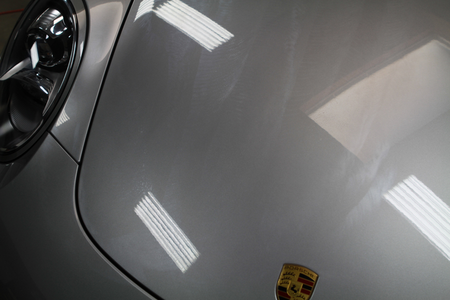

Update: 9:00am pst

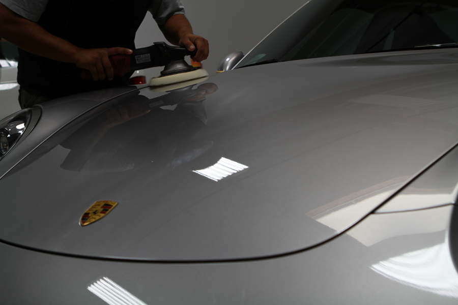

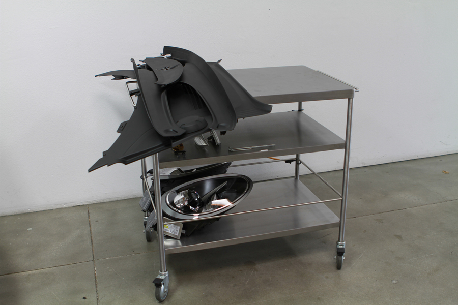

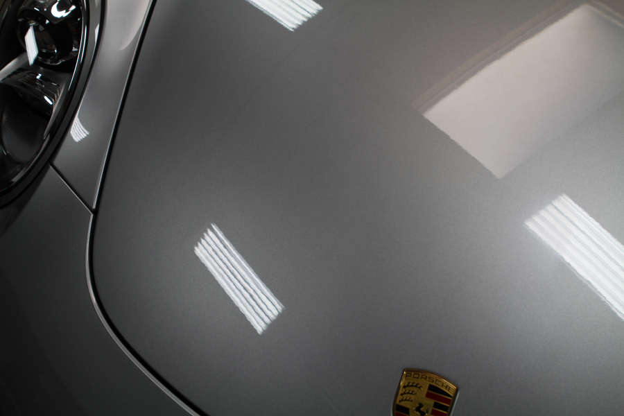

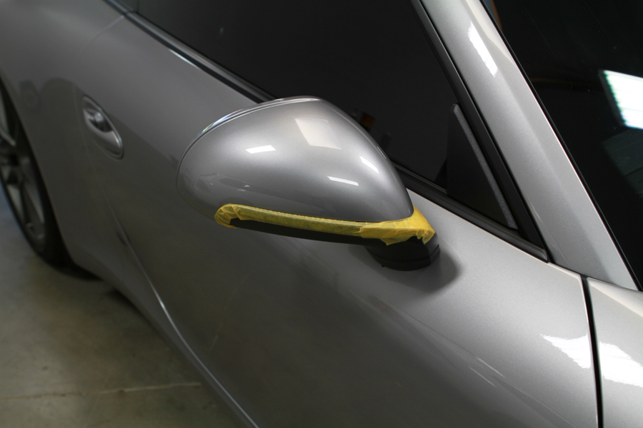

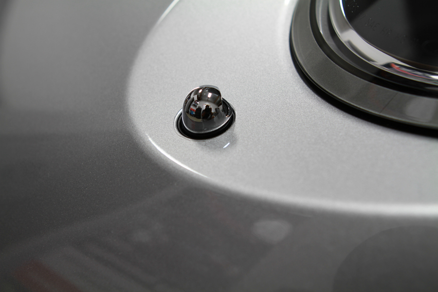

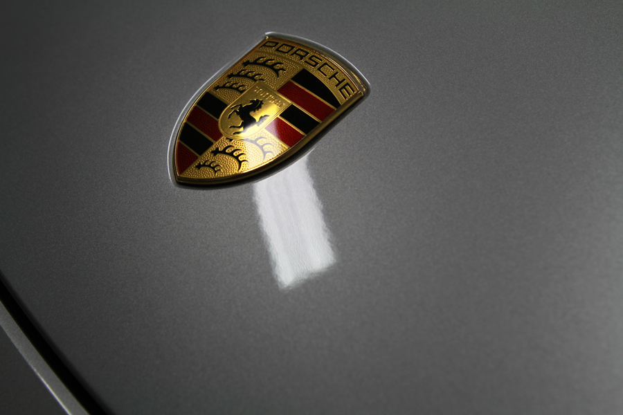

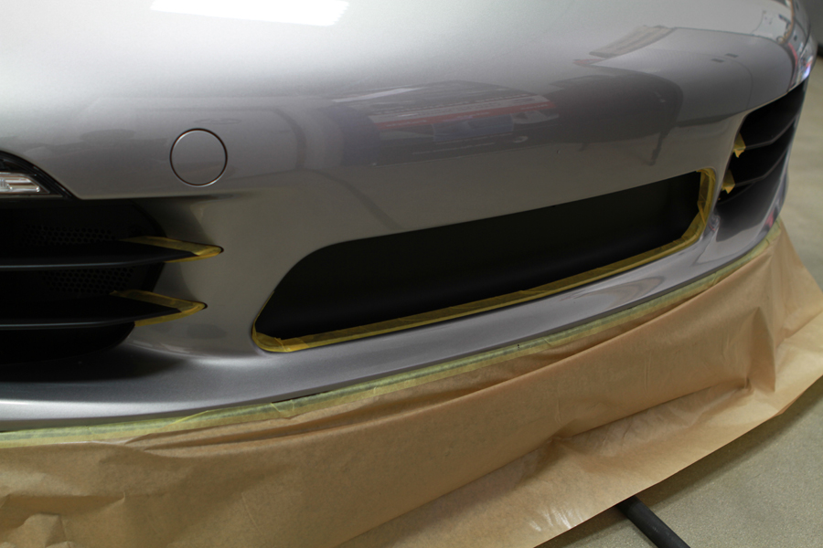

Pre-installation prep
All black trim taped to protect during polishing

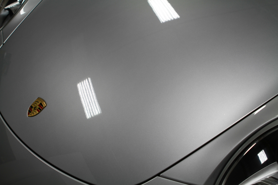

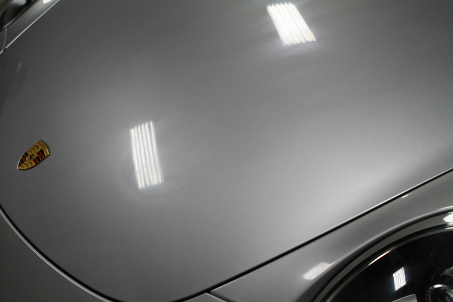

Various stages of polishing done to acquire desired result. In this case, a light polish/pad combo did the trick

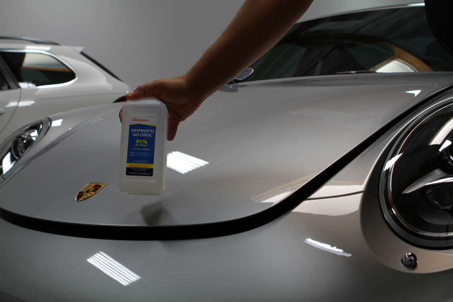

Surface cleaned using alcohol. We aren't kidding about getting a sterile surface

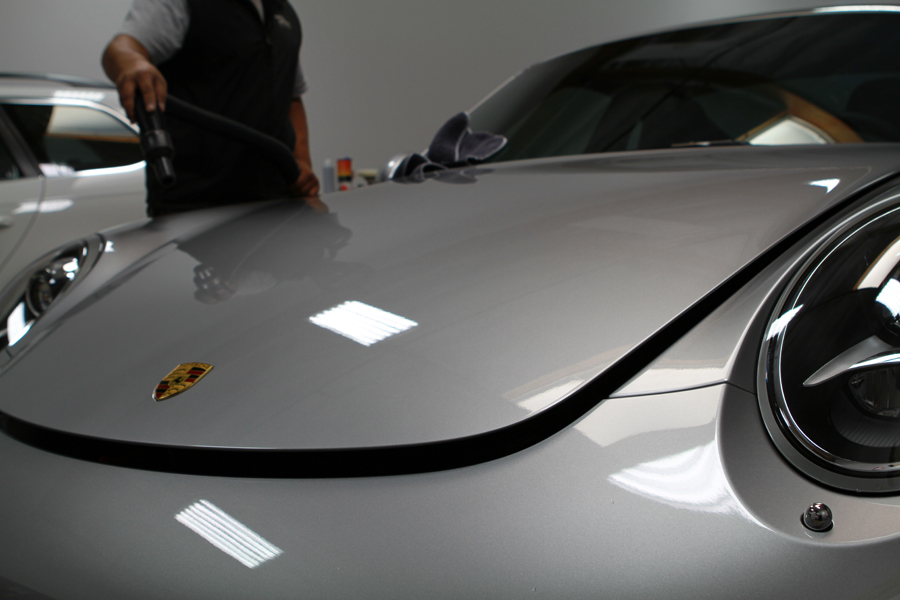

Forced air used to get any polish dust out of the seams

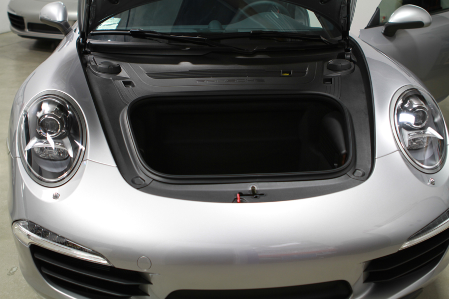

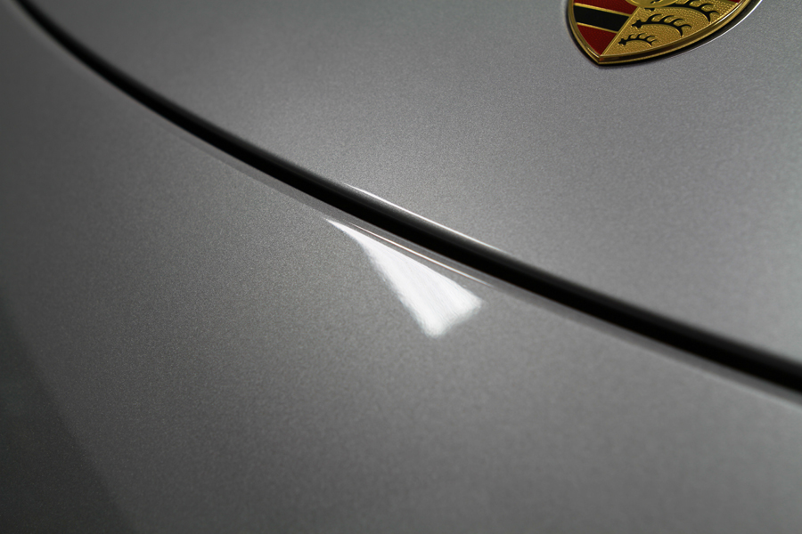

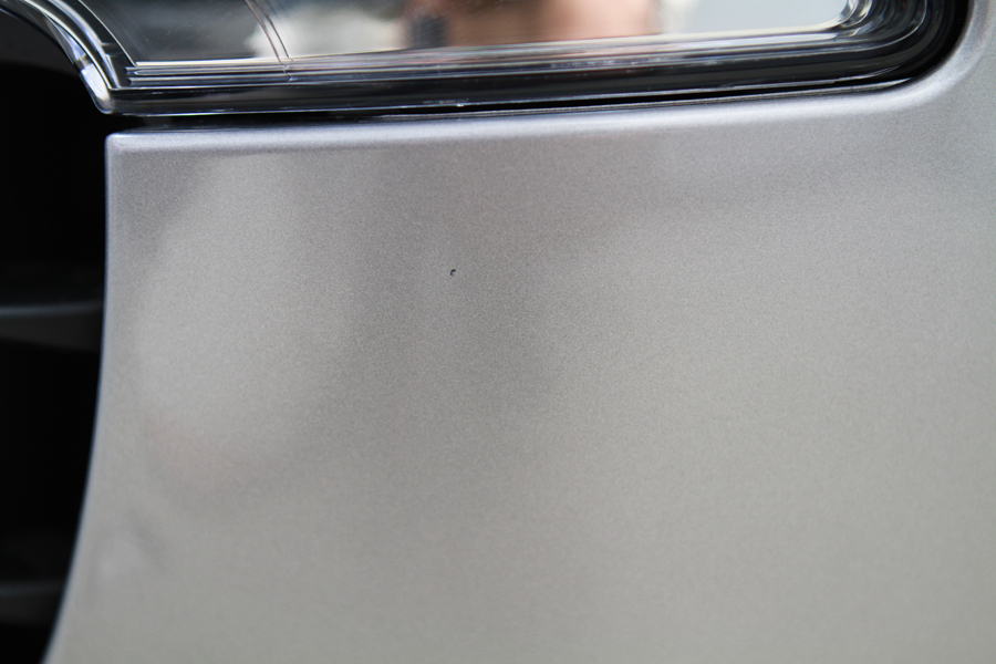

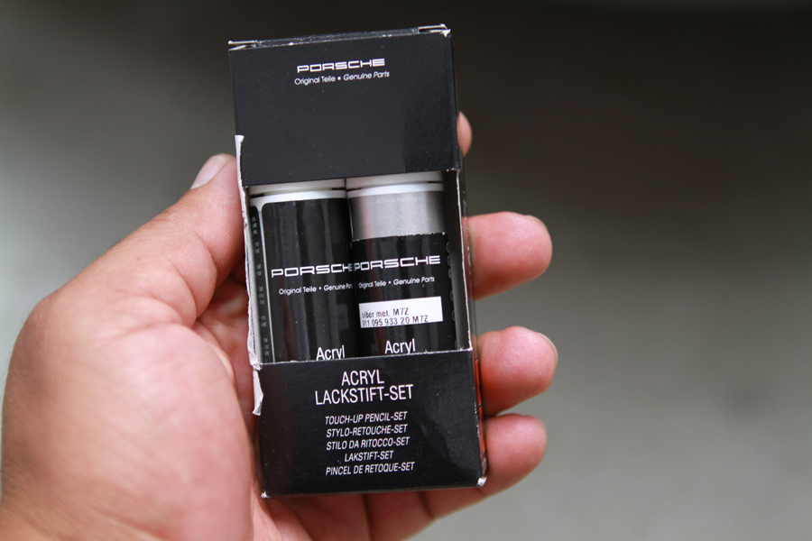

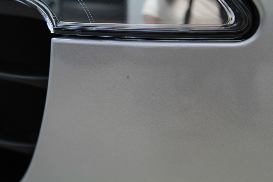

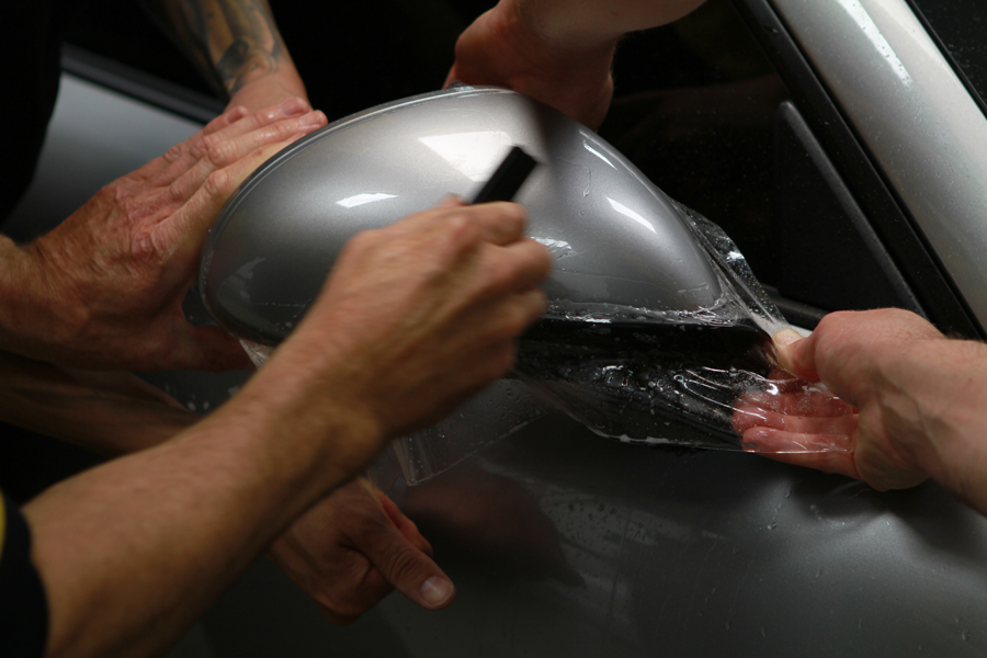

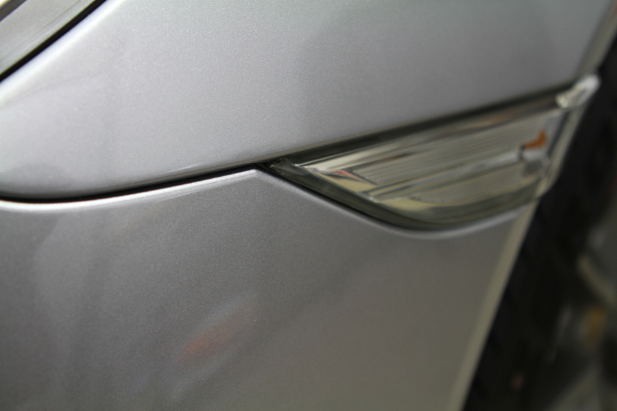

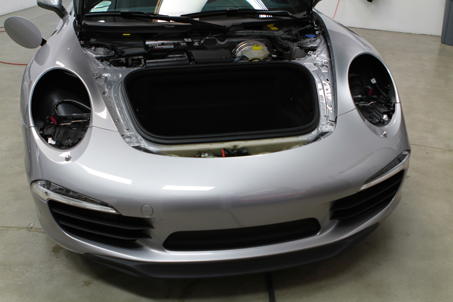

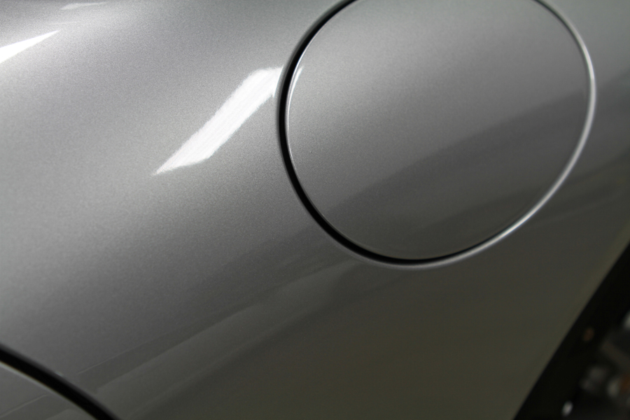

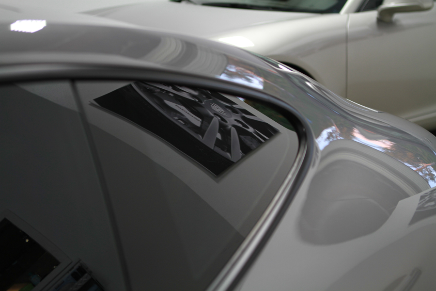

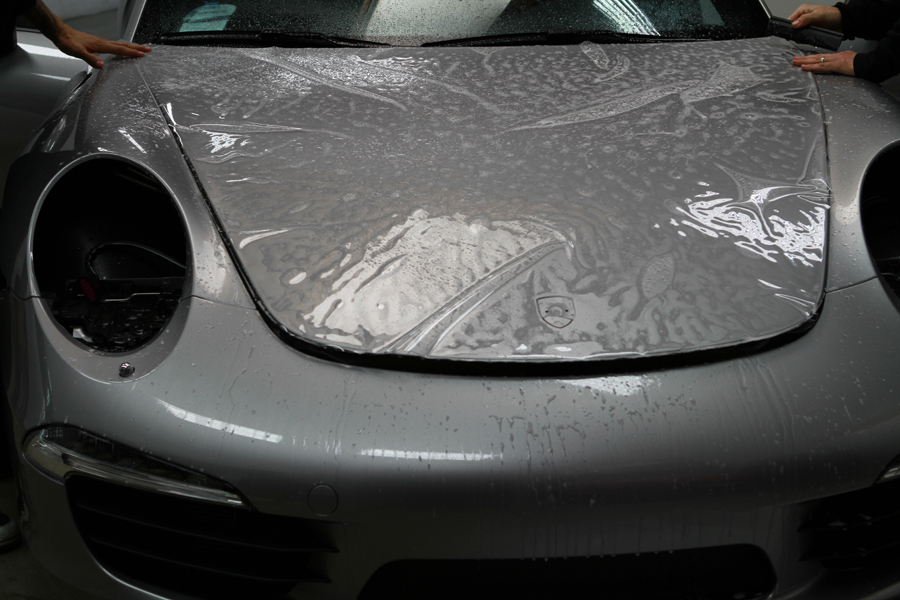

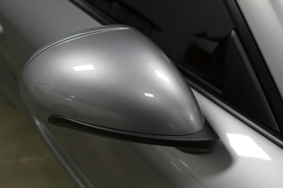

Final task prior to install, touch up any noticeable chips. With only 250 miles, this bumper had already two impact areas. GT Silver is probably the most difficult color to match IMHO. We did the best we could
Unless we feel there's a better substitute, we only use OEM paint

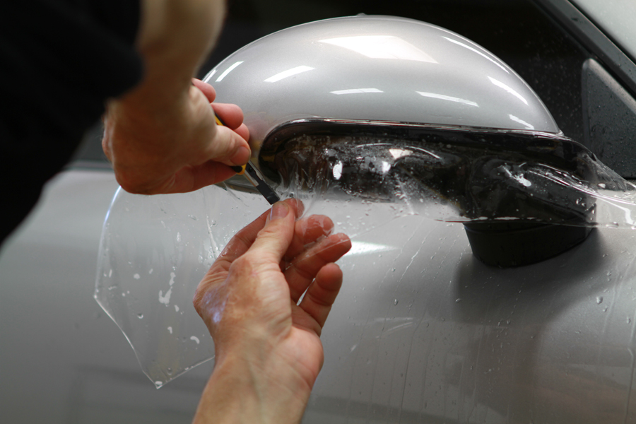

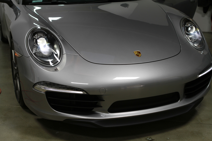

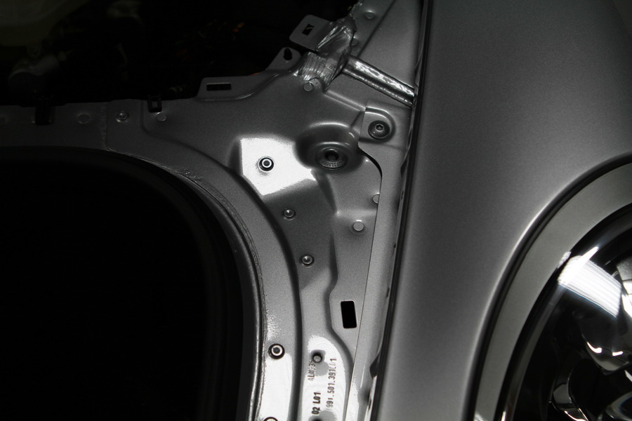

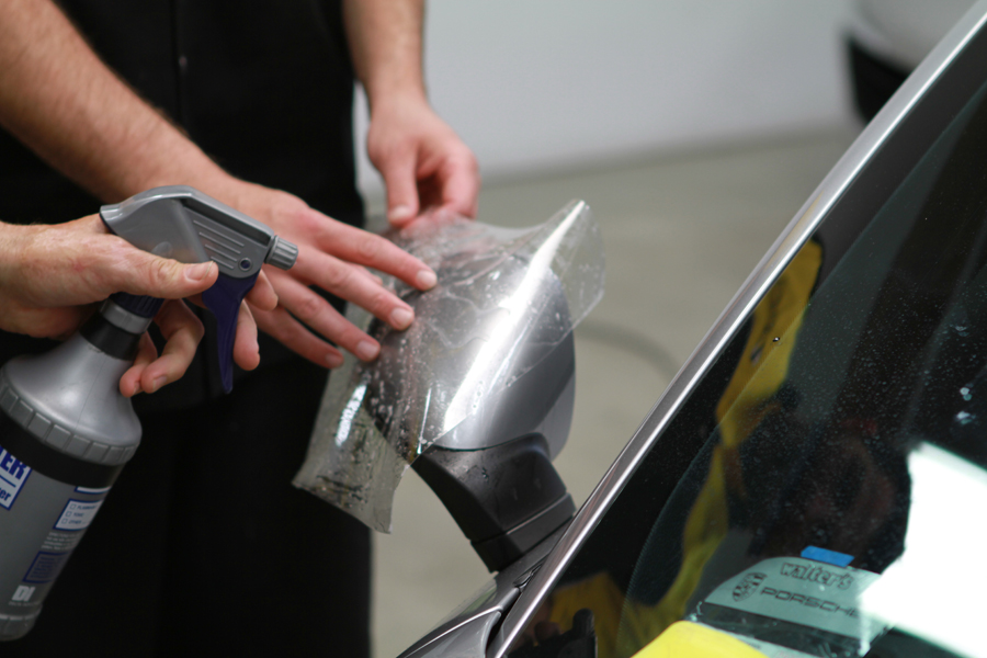

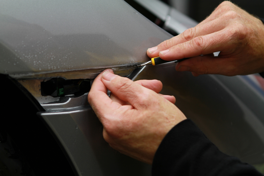

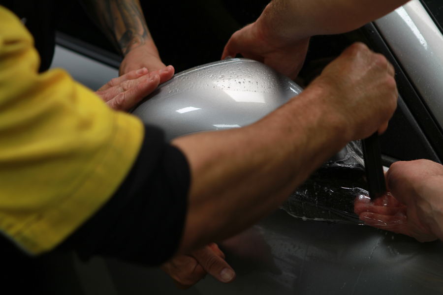

Now we begin installation. Our installs are somewhat unique. They combine the best worlds of a pre-cut to a true hand-cut application. In the software to cut the film, we're able to manipulate the overhang and coverage of the film. So, for areas such as hoods, it's simple to extend the edges and apply the film without cutting. For intricate areas such as bumpers, we extend edges, and cut to a custom fit. For mirrors, we simply cut by hand. So each install is unique and tailored to our specifications. This assures us maximum coverage while significantly reducing any damage to the paint surface while cutting
A Nano Coating is then applied to further protect the film
Lights checked for proper function

Once film installation is complete, we finish the remaining areas of the vehicle for the Phase 1 Renewal Service
Interior vacuumed. Carpets cleaned. And all surfaces cleaned/conditioned using a Dashboard Cleaner
Tires conditioned and wheels cleaned and waxed
Glass cleaned from exterior and interior

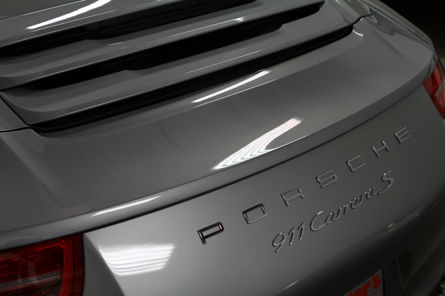

Remaining exterior surface waxed
