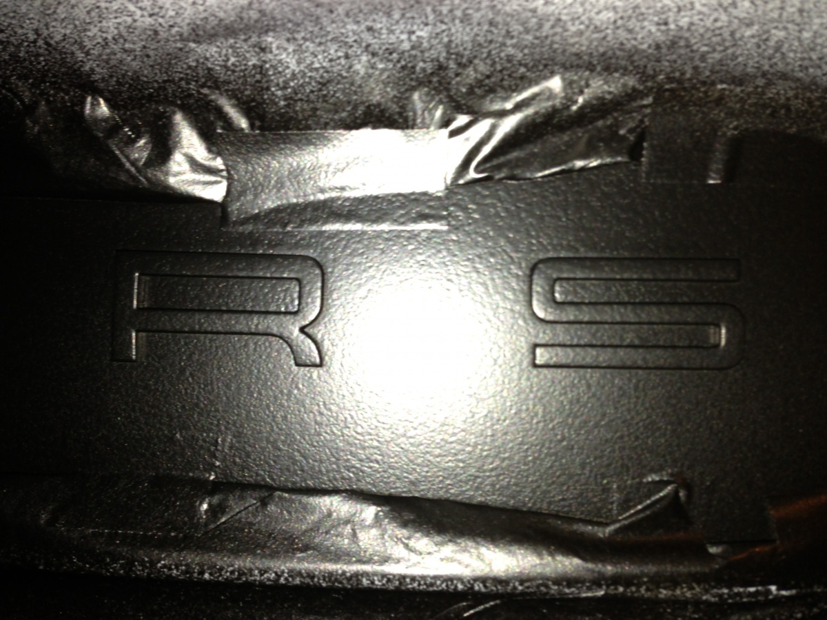

Thanks so much for this writeup! I'm right now waiting for the 2nd coat to dry on my rear Porsche Emblem. Super awesome!!!
Old Apr 1, 2013 | 08:11 PM
  #27
Haku's Avatar
Joined: Jul 2012
Posts: 1,564
From: TN
Rep Power: 162
Haku Is a GOD !Haku Is a GOD !Haku Is a GOD !Haku Is a GOD !Haku Is a GOD !Haku Is a GOD !Haku Is a GOD !Haku Is a GOD !Haku Is a GOD !Haku Is a GOD !Haku Is a GOD !
Nicoli, I'm eagerly waiting for an update.... It's been another 15 mins. I worry about the plasti stuff's ability to peel off paint with zero damage. I need a bit of convincing so keep posting with results and tips.
Old Apr 1, 2013 | 08:36 PM
  #28
nicoli's Avatar
Joined: Jan 2012
Posts: 859
From: Pacific NW
Rep Power: 78
nicoli has a reputation beyond reputenicoli has a reputation beyond reputenicoli has a reputation beyond reputenicoli has a reputation beyond reputenicoli has a reputation beyond reputenicoli has a reputation beyond reputenicoli has a reputation beyond reputenicoli has a reputation beyond reputenicoli has a reputation beyond reputenicoli has a reputation beyond reputenicoli has a reputation beyond repute

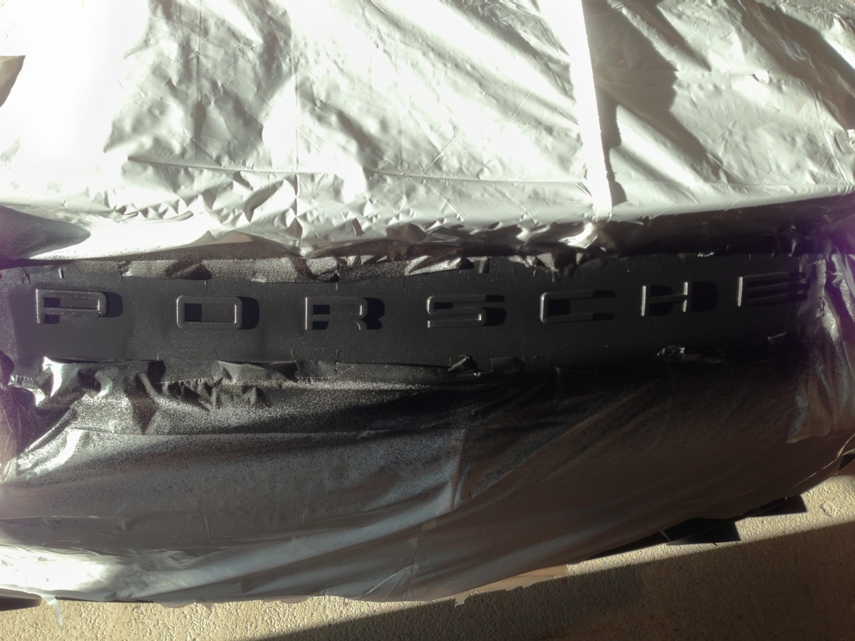

hehe, will do. The can says at least 30 minutes between coats, 3-4 coats is average, and then 4 hours until dry for use.
I was 20-30 minutes between applications (might have pushed this last one at 15 minutes apart) and I'm allowing a slight ancillary breeze through the garage for drying, and frankly, the fumes from the can are noxious.
I will now try to wait 4 hours.

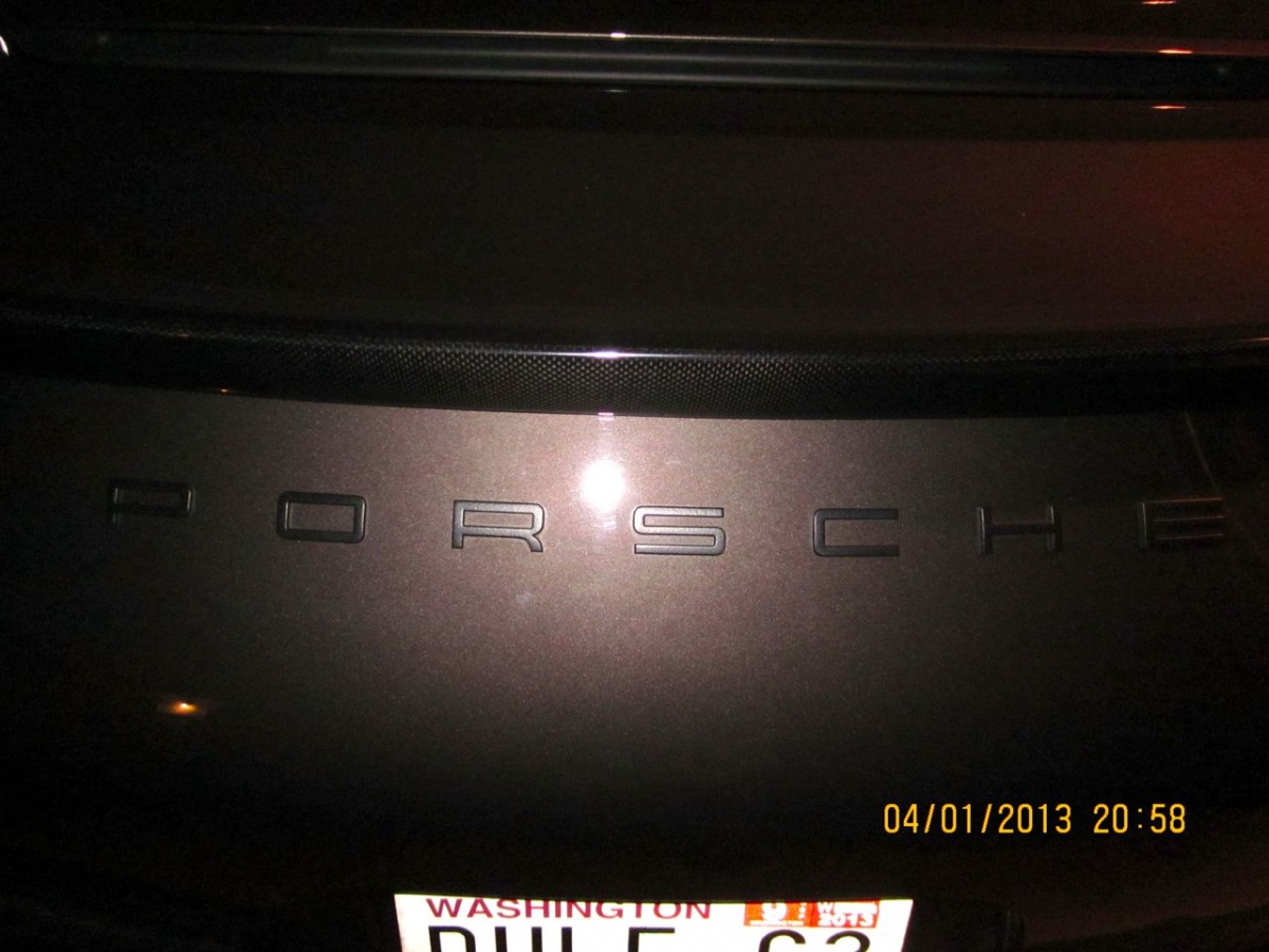

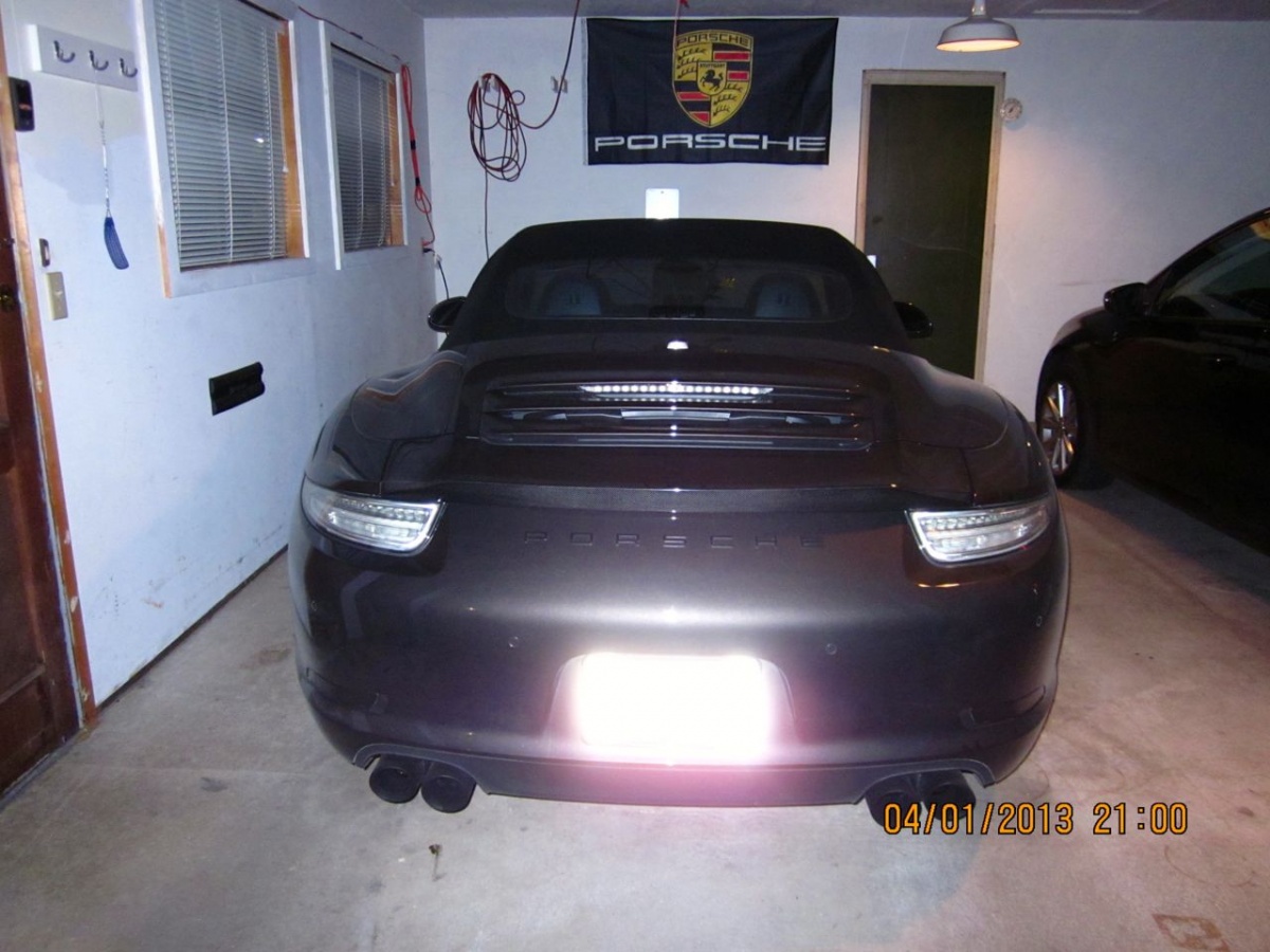

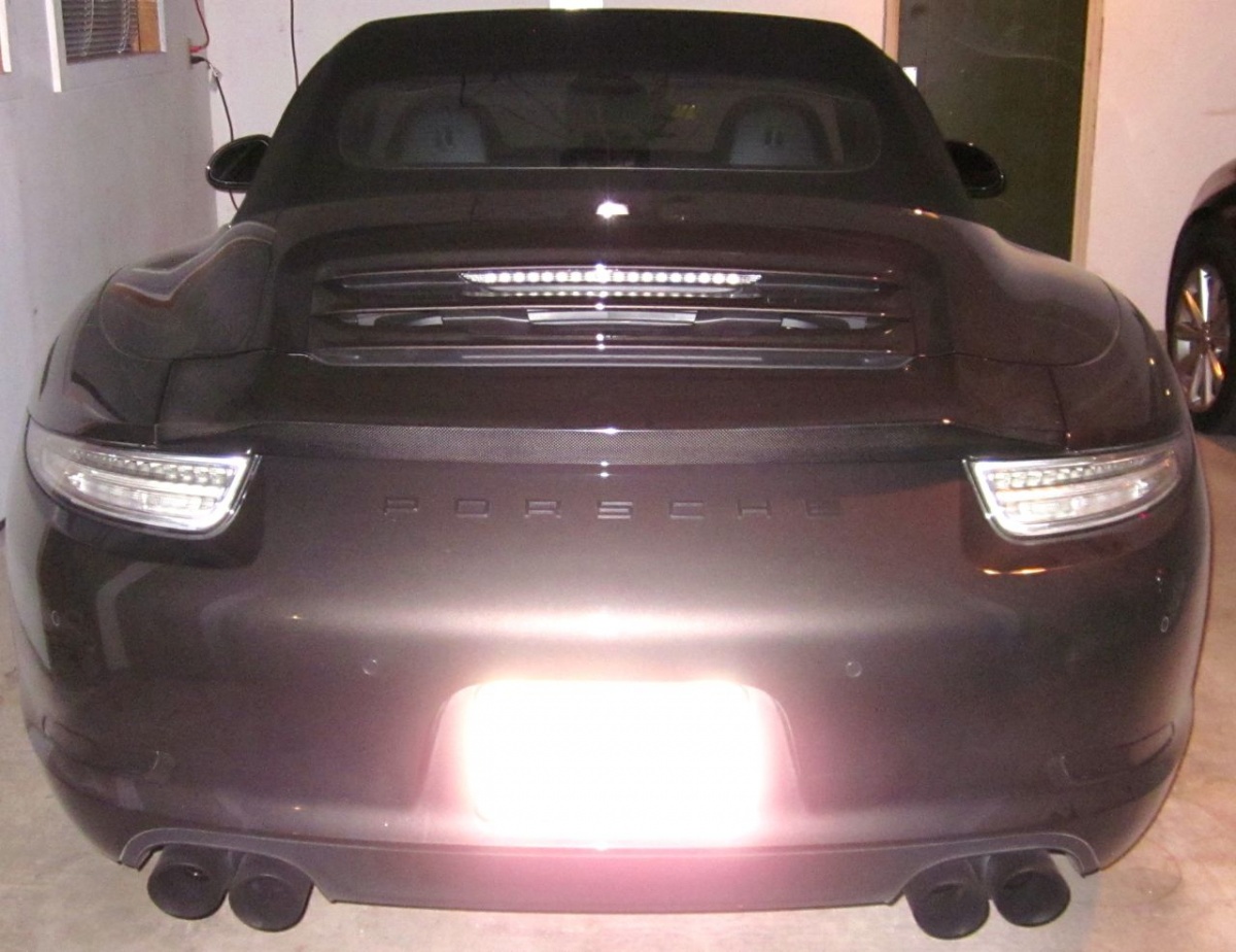

Just a quick late update:
I should have let it dry another hour before messing with removal, I did let it sit about 2.5 hours but recommended is 4 hours on the can.
In my fervent haste to see the final results, I peeled some of the product off the "P" in the P O R S C H E emblem. Just a tiny bit and on the inside, it was the first one I had to remove the plastidip from inside a letter. Anyway..sigh..take your time. Work the toothpick (what I used) or whatever in slowly, in the middle of the "P", and not quickly. Slowwwly worked very well with all the rest of the letters.
The plastidip just peeled right off around the outsides of all the letters without any problems at all, even the "E" and the "S" was not a problem. Its only the letters with an inside not connected to the outside like the "P" and the "O" and the "R" where you have to work very slowly and carefully not to let it remove the product from the letter also. I want to re-spray the "P" on my car at some point tomorrow. Anyway, it's such a small tear on the "P" you can't see it..but I know it's there. I gotta fix it. Remember, slow removal on that inside letter space.
Btw, it looks freaking awesome in person. I could not get a good photograph at night in the garage, I will take another in the sunlight..but the lettering now matches the ceramic black exhaust tips, the carbon fiber vorsteiner lip, and the black cabrio roof really well. I don't know if it comes through in the photos. But in person honestly, I was amazed. Looked great to me. Thanks again to the OP.
