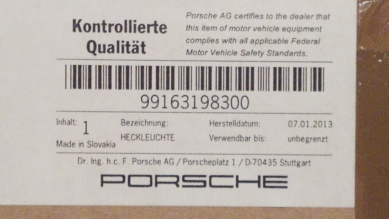

Clear tails should be fine as they are available as a factory option on the US Porsche online configurator.
Not sure that a cop level set on ticketing you would care but all the boxes for my euro clear side markers and clear tails had this sticker on the box.
Oddly the first vendor that I ordered the tails from declined to fulfill my order. He indicated that his distributor would not allow him to sell non-US market parts to a US customer.
