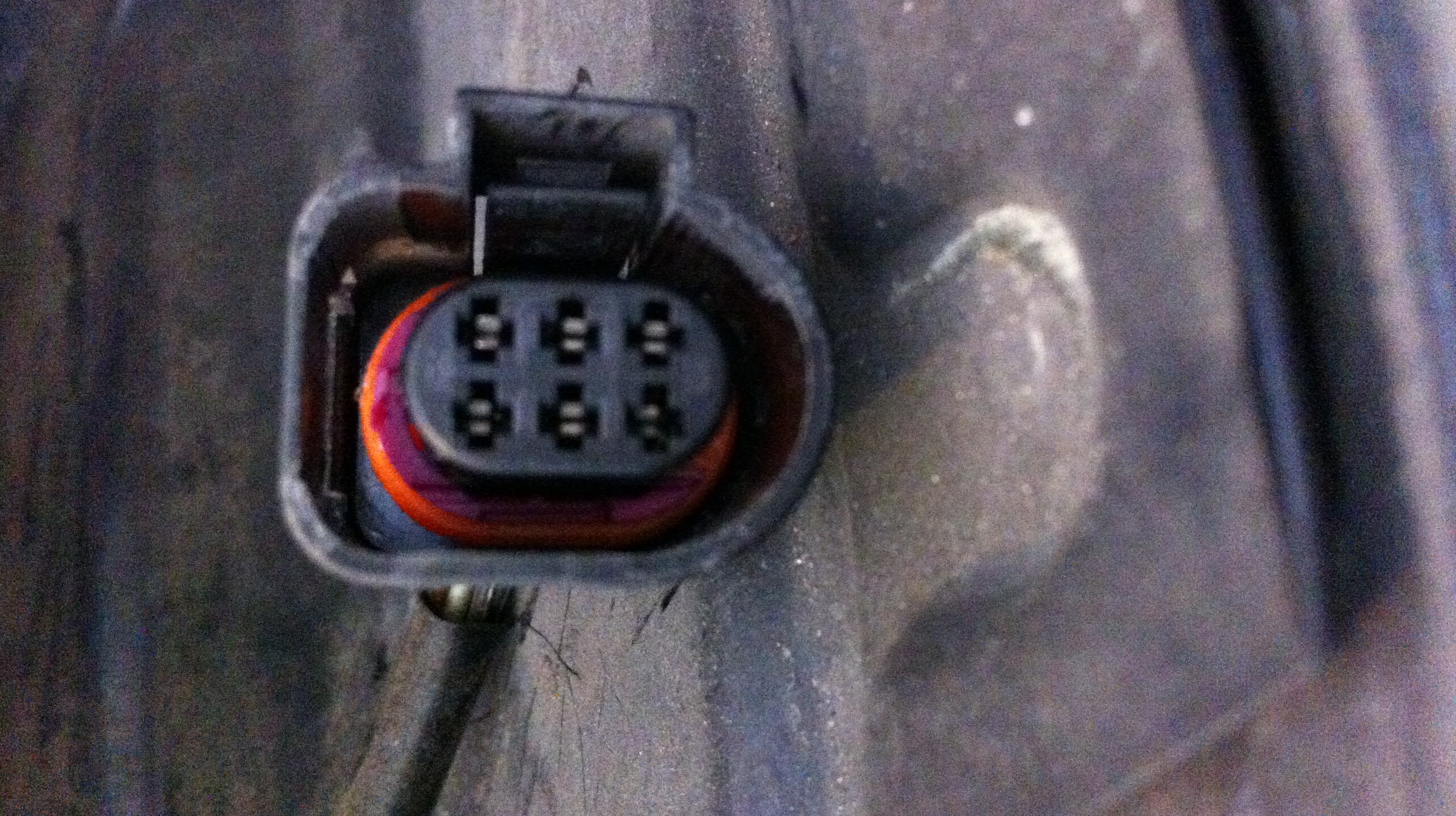

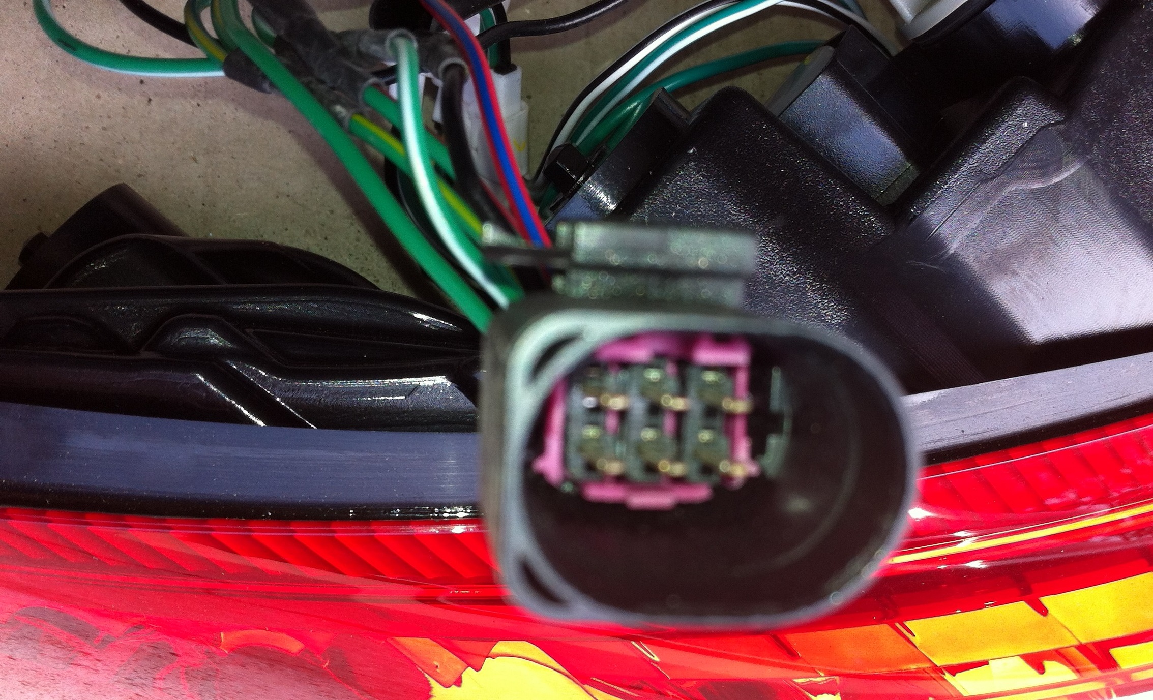

One thing I noticed is that on the plug there are 6 connection points on the Right Side, but on the Left Side (with the faulty lights) there are only 5 connection points. It seems that one of the connection points have been soldered and blocked by Porsche. Do you notice the same thing?
This is the OEM Plug by Porsche that is attached to my car. The same connection point on the DEPO lights is also shorter than the rest, and thus, does not connect.

An update to this:
Today I removed the lights again to try once more and troubleshoot this issue.
As shown in the pics below, the Left Side Cables (both on the car and on the DEPO Lights) have 5 spade connectors, instead of 6 spade connectors which the Right Side Cables have.
Is this the same case with other 997.1 owners?
First two photos: OEM Porsche Cable (connected to the car)
Second two photos: Cable attached to DEPO Taillights
Particularly, the one which has been soldered and blocked off (By Porsche as this is the OEM connector on the car) corresponds to number "6" as shown in the pics. The number 6 spade connector is shorter than the rest, but it does not matter anyway, as theres no contact point on the other cable.
I removed the lights and checked all the connections were tight, and then replaced the lights back on. Guess what? Now the lights work fine on both sides, EXCEPT that the fog lights do not turn on on the left tail lights. While I hardly ever have a reason to switch on rear fogs in Singapore, i'm still wondering if this is normal?

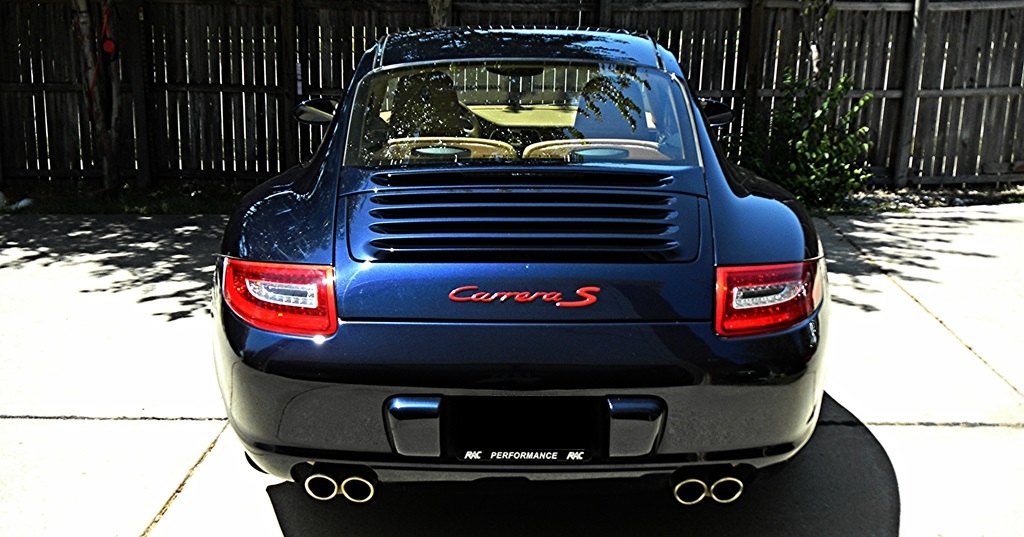

Old Aug 30, 2015 | 01:46 PM
MkC2S's Avatar
Joined: Mar 2010
Posts: 1,849
From: Big D, Tx
Rep Power: 101
Mine has 6 contact holes from the car & 6 raised pins from the DEPO light.
