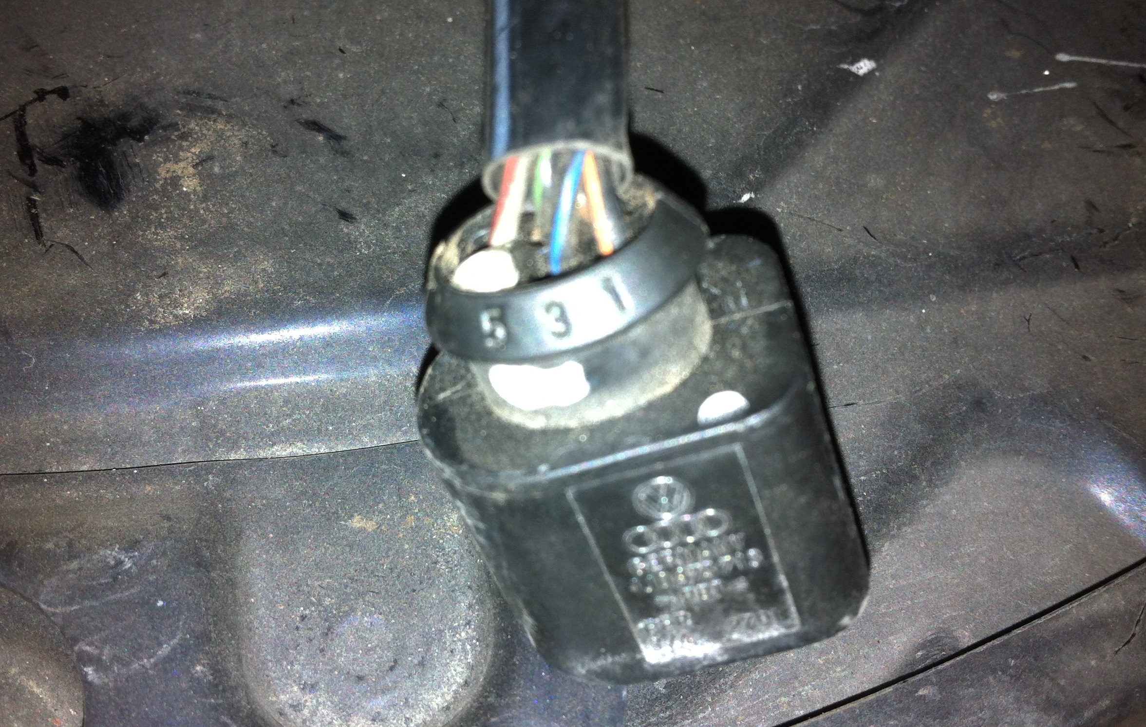

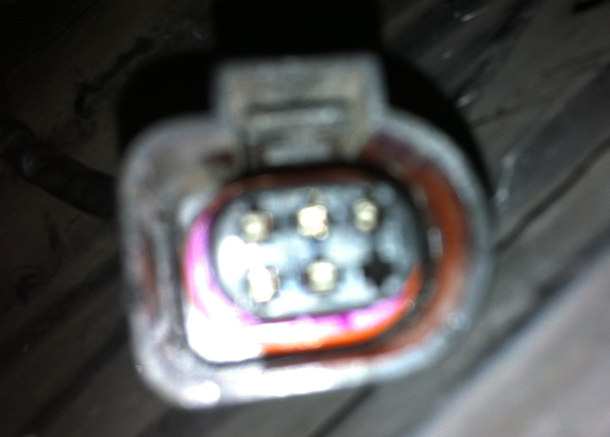

Mine has 6 contact holes from the car & 6 raised pins from the DEPO light.
Is that the same on both driver and passenger side tail lights?
Thanks!
Thanks!
now that I looked at it, my right side(passenger) only have 5 connectors as well. Don't know if you already knew but there's only ONE fog light in the back left side.
ID:	427261   Click image for larger version

Originally Posted by MkC2S
now that I looked at it, my right side(passenger) only have 5 connectors as well. Don't know if you already knew but there's only ONE fog light in the back.
Thanks for helping me out with the info!
Yeah, I guess the Fog light only comes on on the drivers side.
Strange thing is when I initially had the issue, the Fog light was permanently switched on for my passengers side (as shown in the video and screenshot), my passengers side is on the left of the car.
But after reconnecting I don't see it light up anymore. I guess if thats how your DEPO works as well, then it should be considered to be working just fine now.
Hope it remains this way and does not cause any issues in the future though.

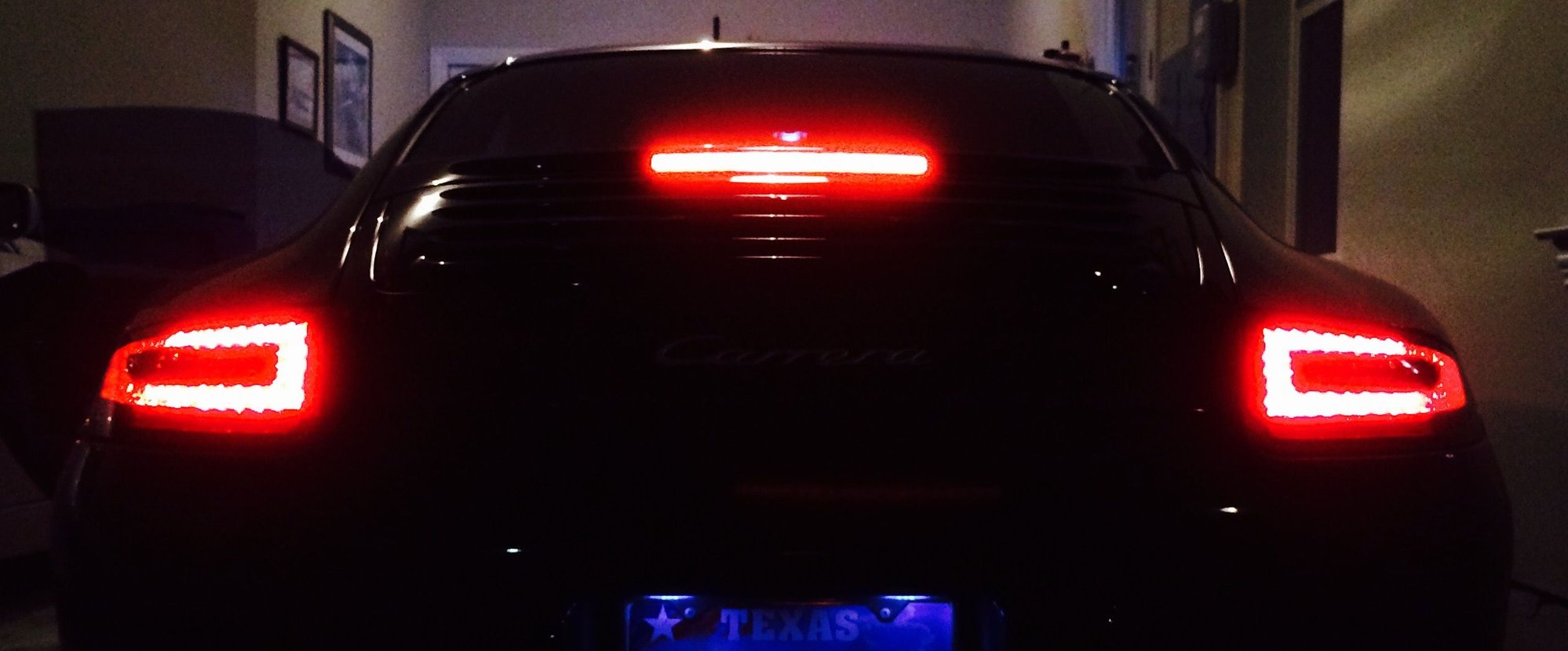

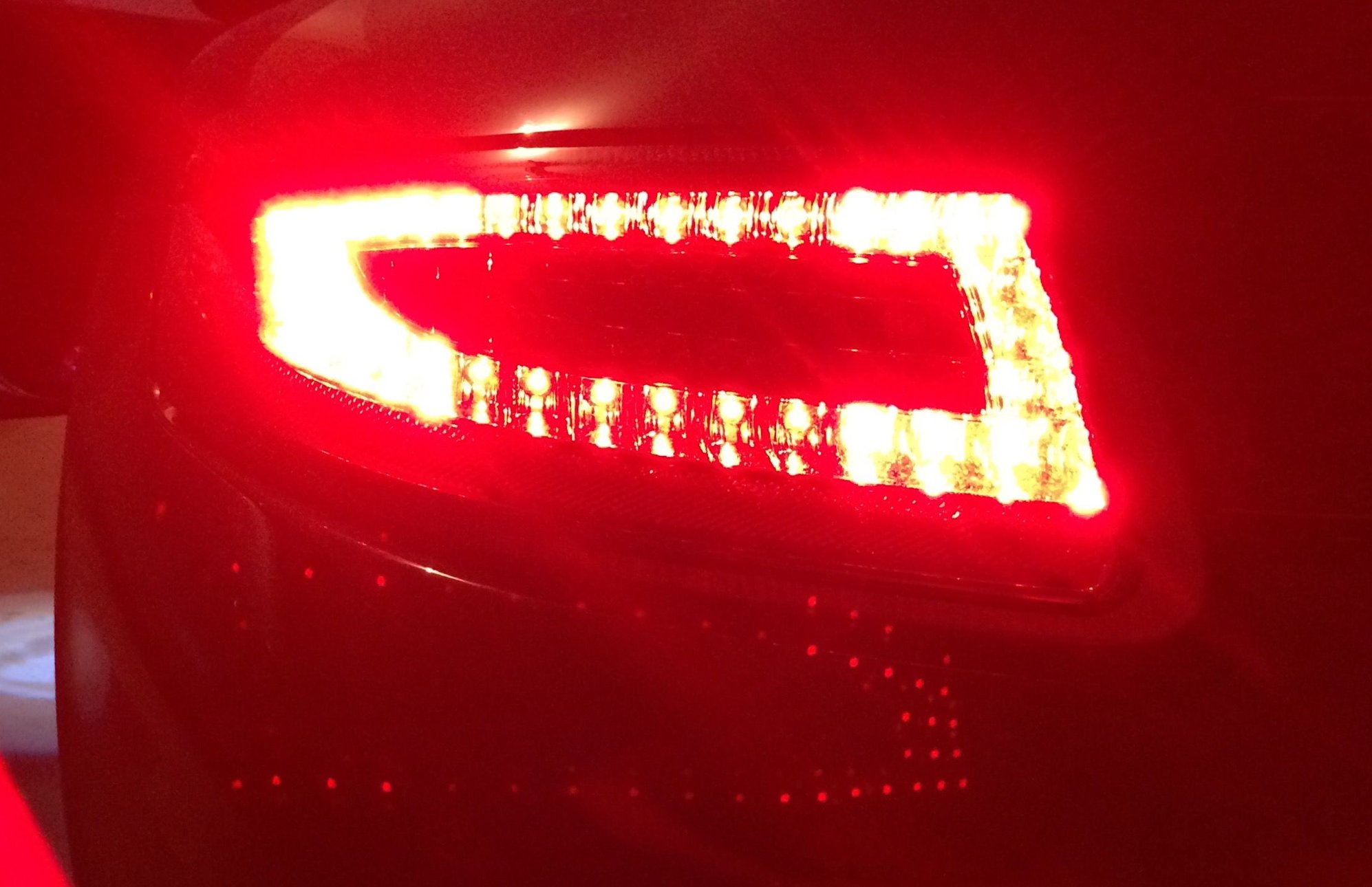

Seems like you got it working right but when the rear fogs are on the light output is normal. Just to be clear it should be that way or its normal when the rear fogs are on. Added some pictures of mine.
Parking lights on.
Parking lights on with brake light, even lighting.
Parking lights on with Fog light turned on.
Parking lights on, fog light on, with brake. Middle LEDs between fog and brake lights don't light up, this is normal
Closer view of above.
