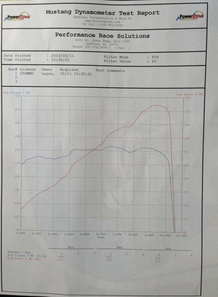

We had our local PCA Dyno Day this past Saturday. Whomever guessed closest to their hp at the wheel, not the the engine, gets a free wheel alignment. I guessed 370, which is close to 75% of the supposed 430hp it's supposed to have. My car was second to go up on the Mustang Dyno, and from the start there were issues. The PDK, not seeing the front tires moving would not shift past first gear no matter what we did. They reset the dyno to AWD which would then move the front rollers. Then they were able to get the car to upshift. Even still, the power the dyno was showing was far below what it should be. They ran it three times even adding more fans for greater air movement and cooling.
I have attached a video and a copy of the Dyno report. It did sound good.
Their guess as to why it was not reporting properly is due to the PDK computer, from the front rollers not able to keep up and sucking some of the HP, and/or not enough air movement. Needless to say I was a bit disappointed. Now, if the dyno is accurate, then there is a real problem somewhere. I will have to find another dyno and see what results they get.

Hmm, this is way lower ...around 335 ish Hp?? Definitely due to front wheels...

Most modern cars have to be put into "dyno mode" via the computer system with some sort of OBD II machine, or else the results will just not be accurate.
With my old M3 this was done with a GT1 machine, not sure what the Pcar will need.

Do your math again. 0.75 x 430 = 322 and 335 shows as your max hp. Each dyno and each brand of dyno will display different drivetrain losses. Go to a Dynojet if you want a bigger number.
Getting a Mercedes into dyno mode is easy through the multi-function steering wheel. On my 987 it just takes turning off the PSM to avoid the front and rear speed differential problems.

Yeah, I may have been hoping for too much, but a stock Cayman R was showing 282. 282/.75 = 376hp? It is closer to 85%. By that account mine is showing numbers for a base S of 394hp.
The traction control was off, even still the car refused to upshift by wheel buttons or stick. Either way, I will be looking for another dyno to see if they get different numbers.

Counting on 25% drivetrain losses seems very pessimistic. I think the 'usual' number is closer to 15%.
I have wanted to dyno my 991 but have been told you need to trick the car's computer or use a dyno where the front rollers are perfectly in sync (same responses you have seen on this thread and basically what you experienced when you had to go to AWD mode). Even then, the shops I talked to were not convinced they would get an accurate reading. Because of this, I had been quoted $300 I've given up for now.
The only practical (track) experience I have is that my standard 991S has a better acceleration than a 997.2S and even than a 997.1 GT3 that has more hp's.
Do not worry, all the promised horses are there and Porsche has the reputation of understating its numbers.
