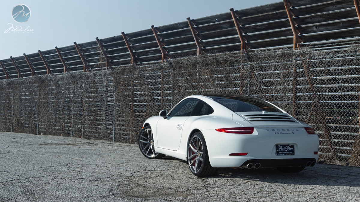

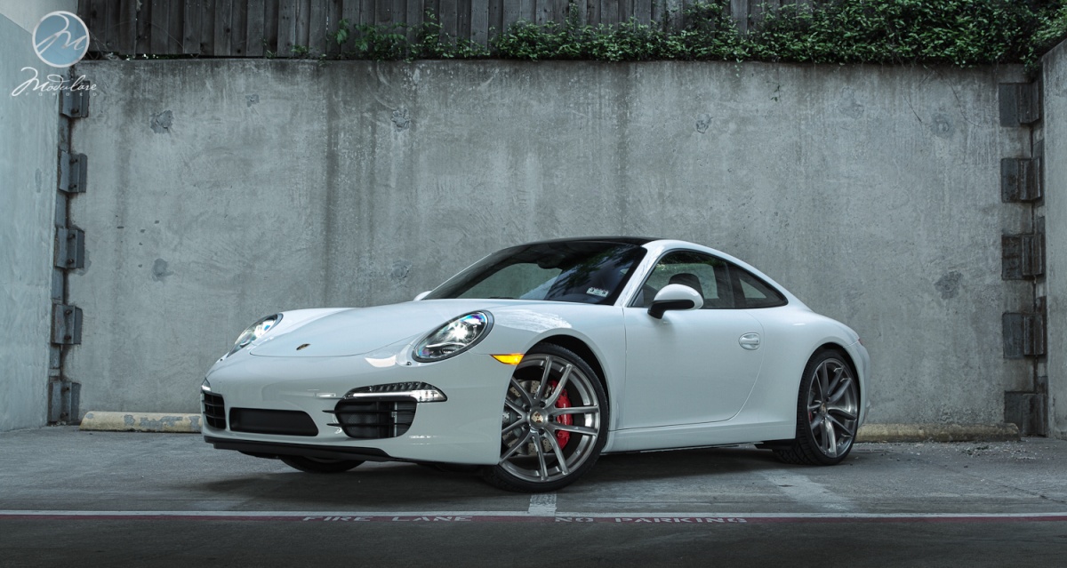

Hey guys,
In about 3 weeks I should be getting my white 4S with black glass roof, and I want to slap on some custom wheels ASAP. I got my eyes on a set of Modular B18 wheels like these:
I want them one tint darker, and one size smaller. The ones in the photo are 21", and I would prefer to run on 20".
Does anyone have the exact wheel size I should order for the 4S? I know the rear of the 4S wheels is quite a bit wider than the 2S. Exact sizes would be great to have so I can verify that with the manufacturer.
Also, has anyone ever ordered wheels from http://www.modularewheels.com/ ? If so, how was the quality? I've bought wheels online before, and they turned out to be quite badly weighted, whenever I added new tires, the tire guys would have to add a ton of weight to them to get them kind of rotating properly.

the widths are the same but the offsets are different.
4S:
Front - 8.5 x 20 ET51 - 245/35/20
Rear - 11 x 20 ET52 - 305/30/ 20
FUrthermore, P offers Sport Techno wheels that are:
Front - 9 x 20 ET51 - 245/35/20
Rear - 11.5 x 20 ET48 - 305/30/20
I prefer the 1/2 in wider wheels as it sits flush w/ the wells w/o the need for spacers.
good luck.
