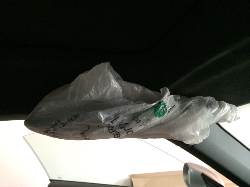

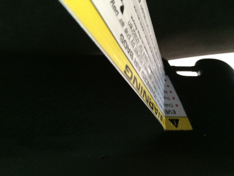

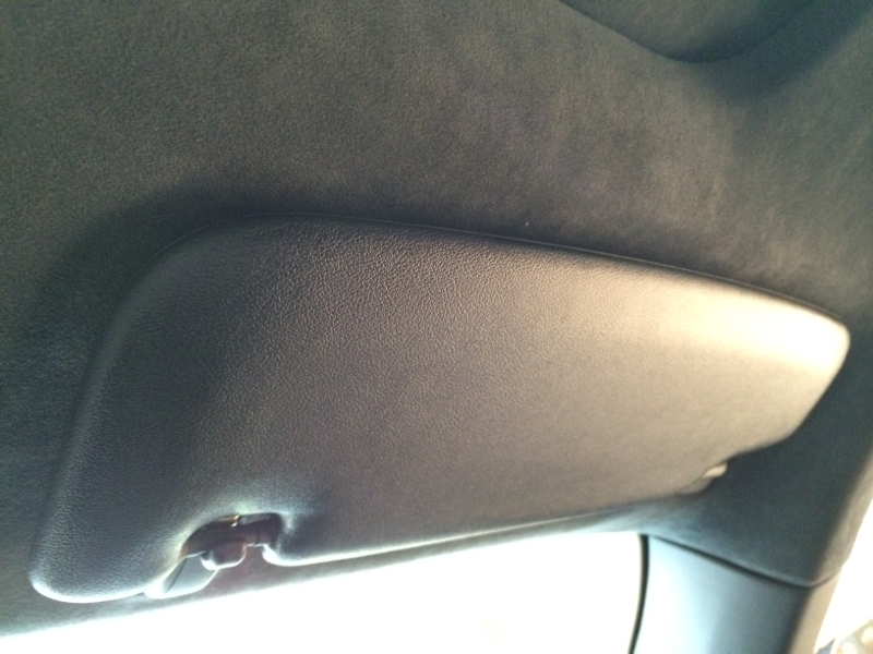

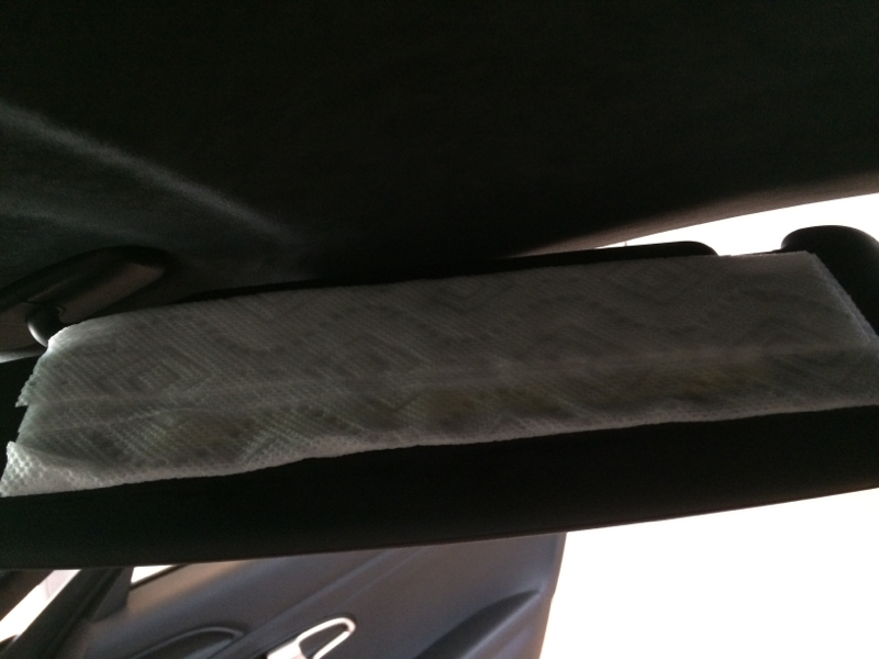

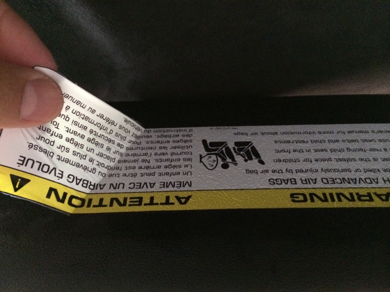

I realize this is one step above "I installed clear side markers". Did it, and took a few pics since there were none on here.
1. Took one sheet of paper towel folded a little smaller than the visor. Dampen it with 91% Isopropyl. Turn visor towards door window and flip up with sticker facing up.
2. Set damp towel on sticker and rub it to dampen it. Leave the towel on the visor, and put a plastic bag on it.
3. Come back in like 15-20 min.

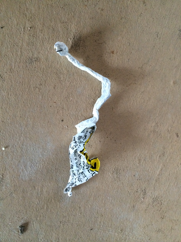

4. Take bag and towel off and slowly peel sticker up. Mine came off in one piece.

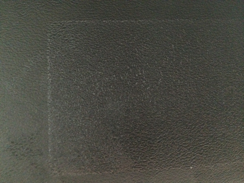

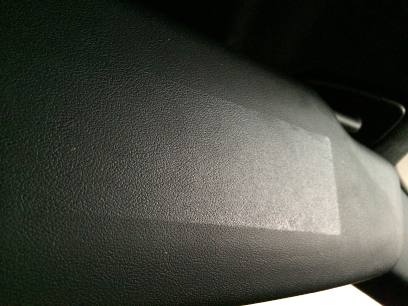

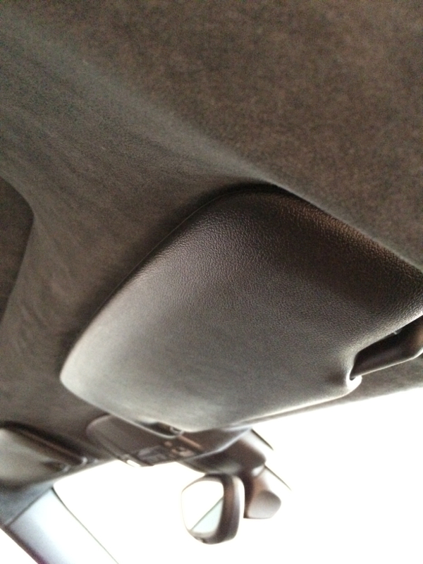

5. There will be adhesive left over as only the vinyl sticker comes off. My car is a couple years old and the adhesive seemed a bit of a pain in the *** to get off.
6. I repeated the first two steps (damp towel and bag trick) to loosen up the adhesive. Took a tooth brush to get in the textured visor. Rubbed quite a bit with the damp isopropyl towel.
7. As you can see from the pic with the adhesive shadow, there was some blotchy areas around it. After I had the whole rectangle adhesive removed there was an uneven sheen to the visor.

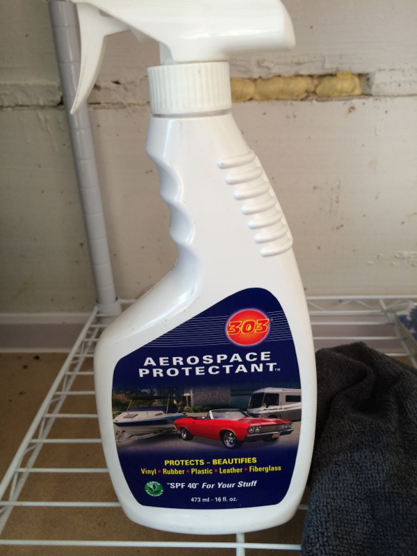

8. Pulled out my Aerospace 303 protectant. Looks like an infomercial product, but it's legit! This stuff is the best out there. Put a thin coating over the visor with a microfiber. Bingo, good as new!

Glad to hear my bag trick worked for you!

Good job. The shadowing will go away eventually if cleaned thoroughly to get the adhesive out of the textured visor. Plus using the 303 to even it out. After a couple months, the slight shadow I had has disappeared!
