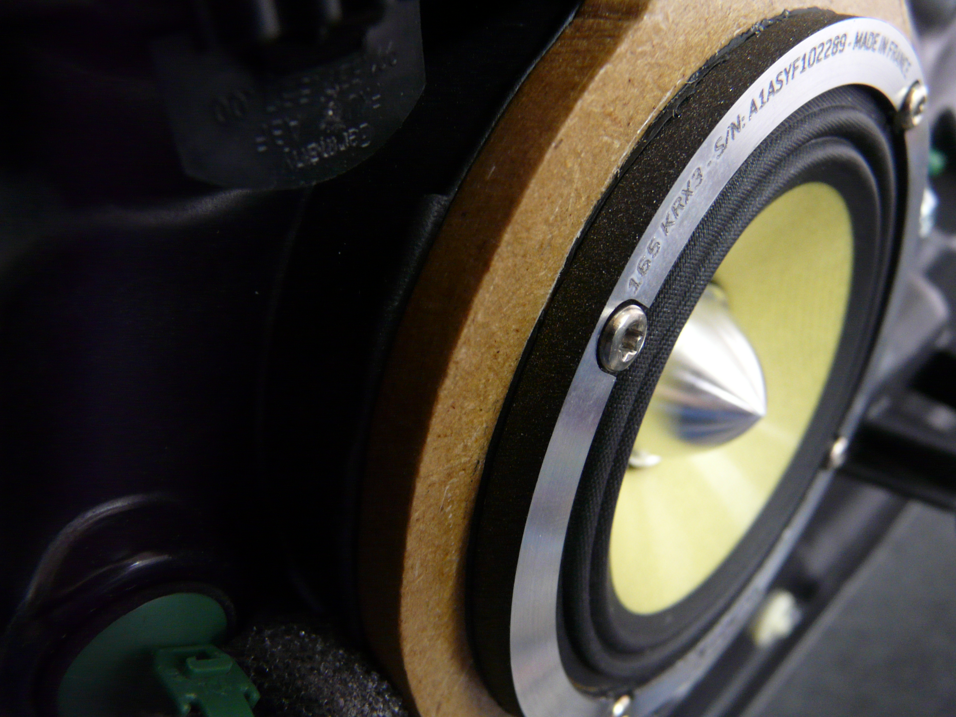

Hi, When you said that the spacer is a 6mm one, you mean the larger part that you screw on the door, correct ? I will name it "the plate"...
After you have a second spacer (circular ring) between this 6mm plate and the 165mm woofer, correct ?
I measured in total a need for a 26mm total spacer. This is strange but on your picture I have the feeling that it's lower. Below 26mm, in my case, the back of the woofer will touch the window (when window down).
Do you remember the total thickness of your spacer : the plate + the circular ring ?
Many thanks...

My plate is 6mm that screws into the door. I then have a ring screwed into the plate, the total thickness it 21mm. It worked for me, maybe your 26mm calculation isn't correct?

Excellent, I took 5mm margin thinking that door black plastic panel can ''unfortunately'' move when we close the door / "huge" speaker weight --> with window open I wanted to secure the back of the speaker from touching the window...
So, it fits, really great your information, thanks a lot :-)

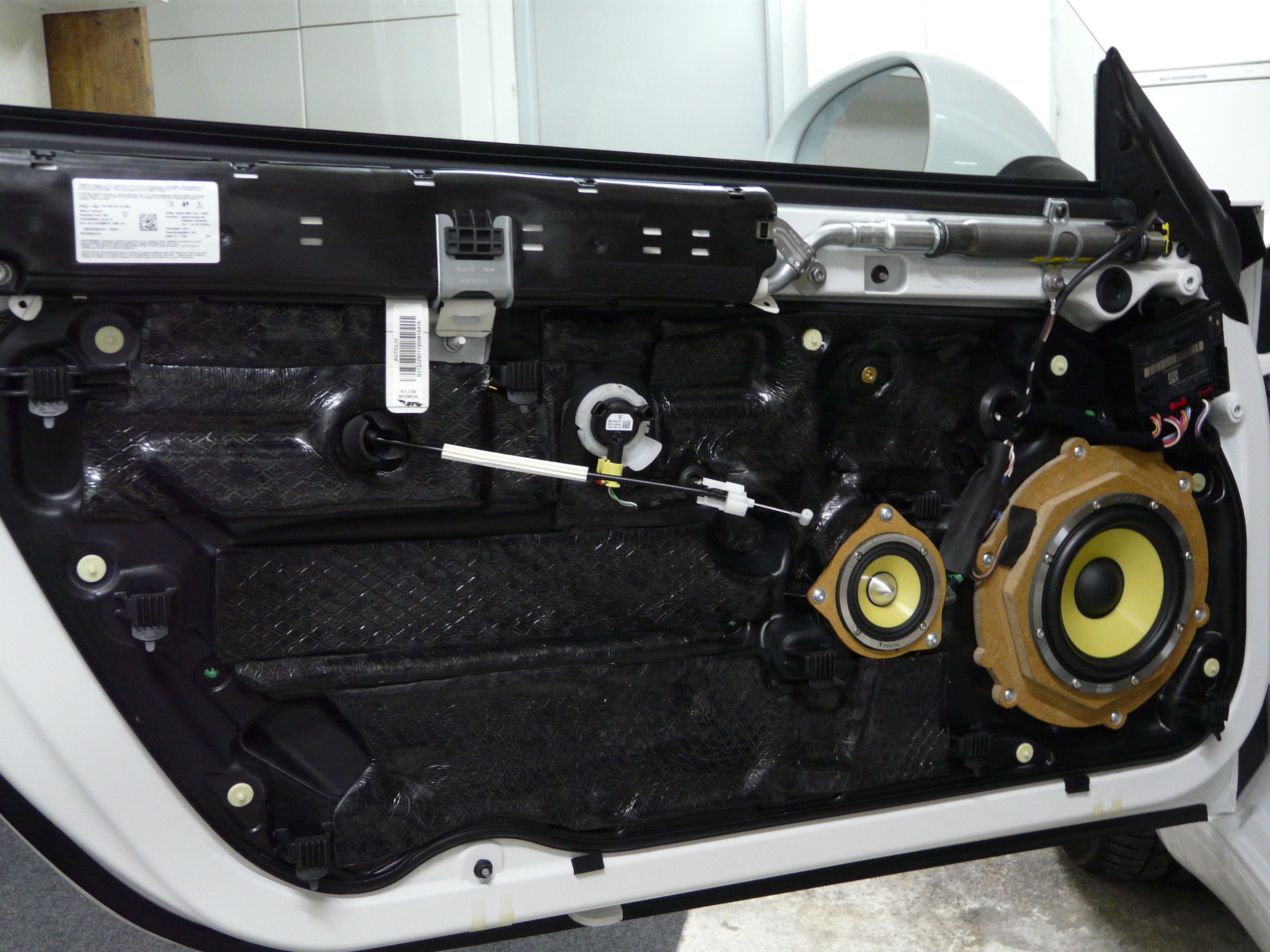

Install not finished but on good way...
For the woofer, I finally used 25mm spacers : 10mm (in contact with the black door plastic panel) +15mm (in contact with the speaker)
For the medium this is a 6mm spacer
Also some work to damp / nvh all the door wiring (back side & front side), plastic box (DCU) and so on...

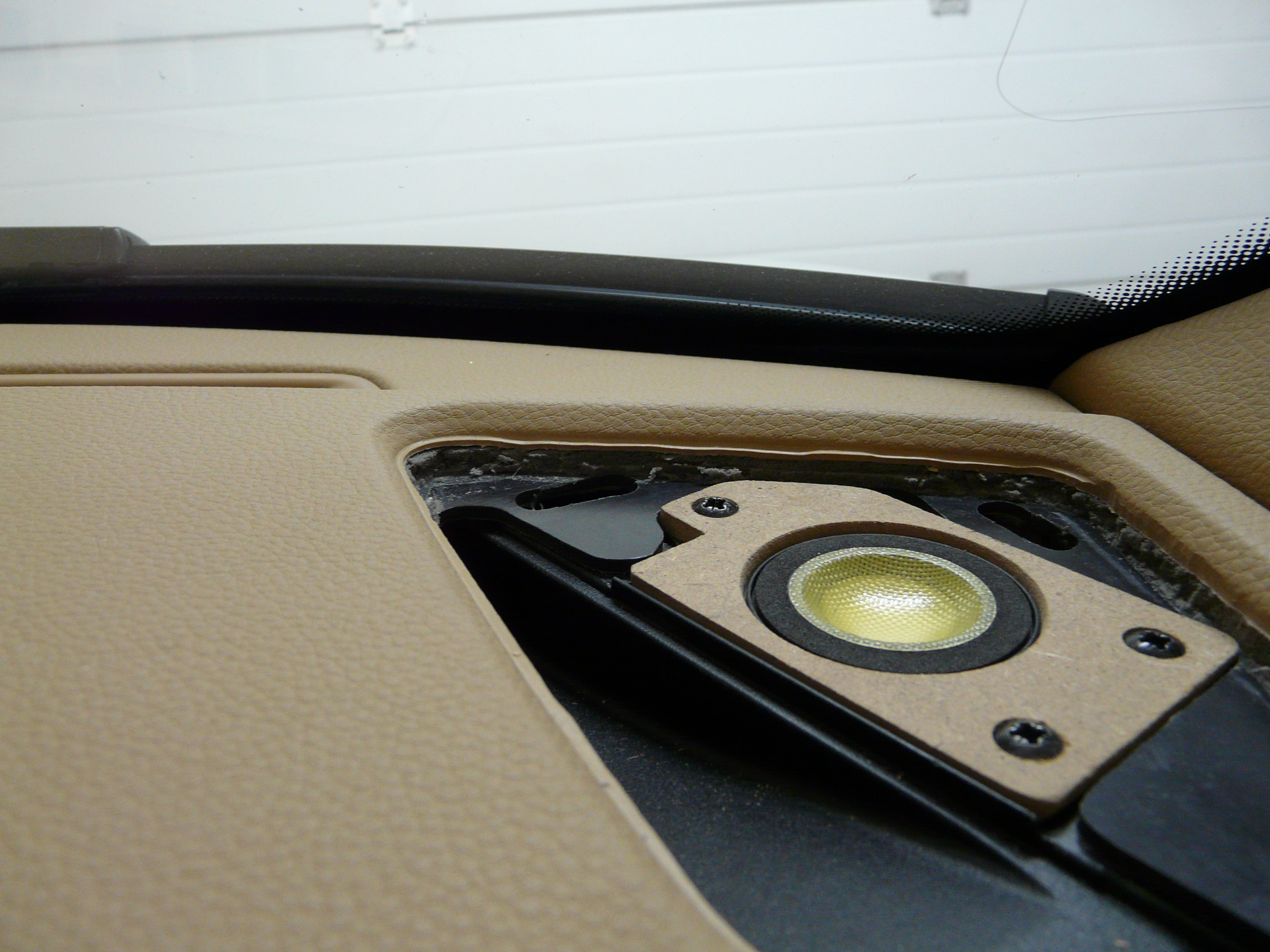

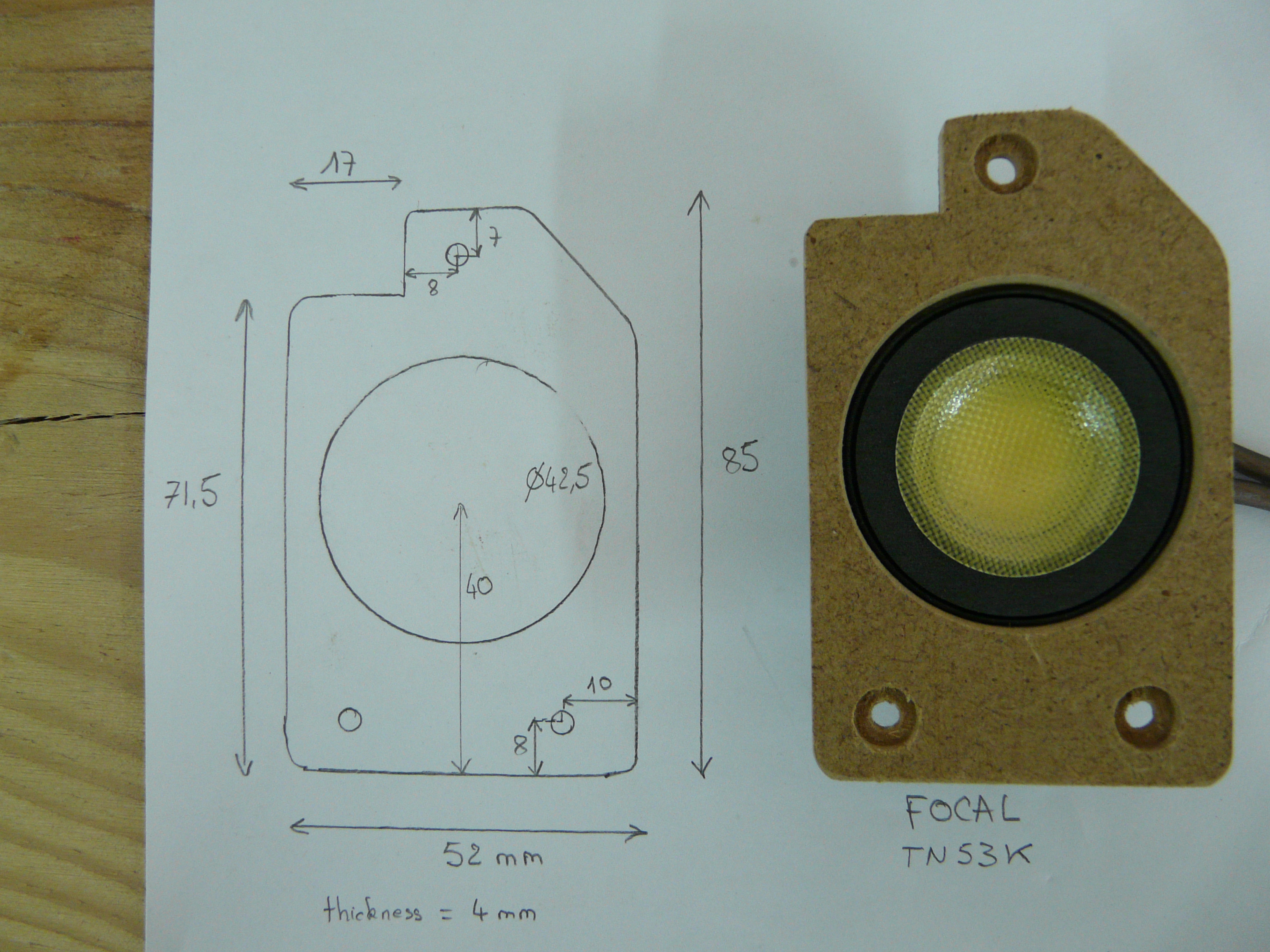

In one word INCREDIBLE !!! I didn't expect to have such result, impressed...
I still have to put the sub but for what ??? perhaps just to be state of the art.
Nevertheless I have an issue engine running with EMI on the rear right filter (the medium output), Focal will change it...
For the integration of the TN53K Tweeters, I made a drawing for people who want to integrate them in the Dashboard with Burmester set-up

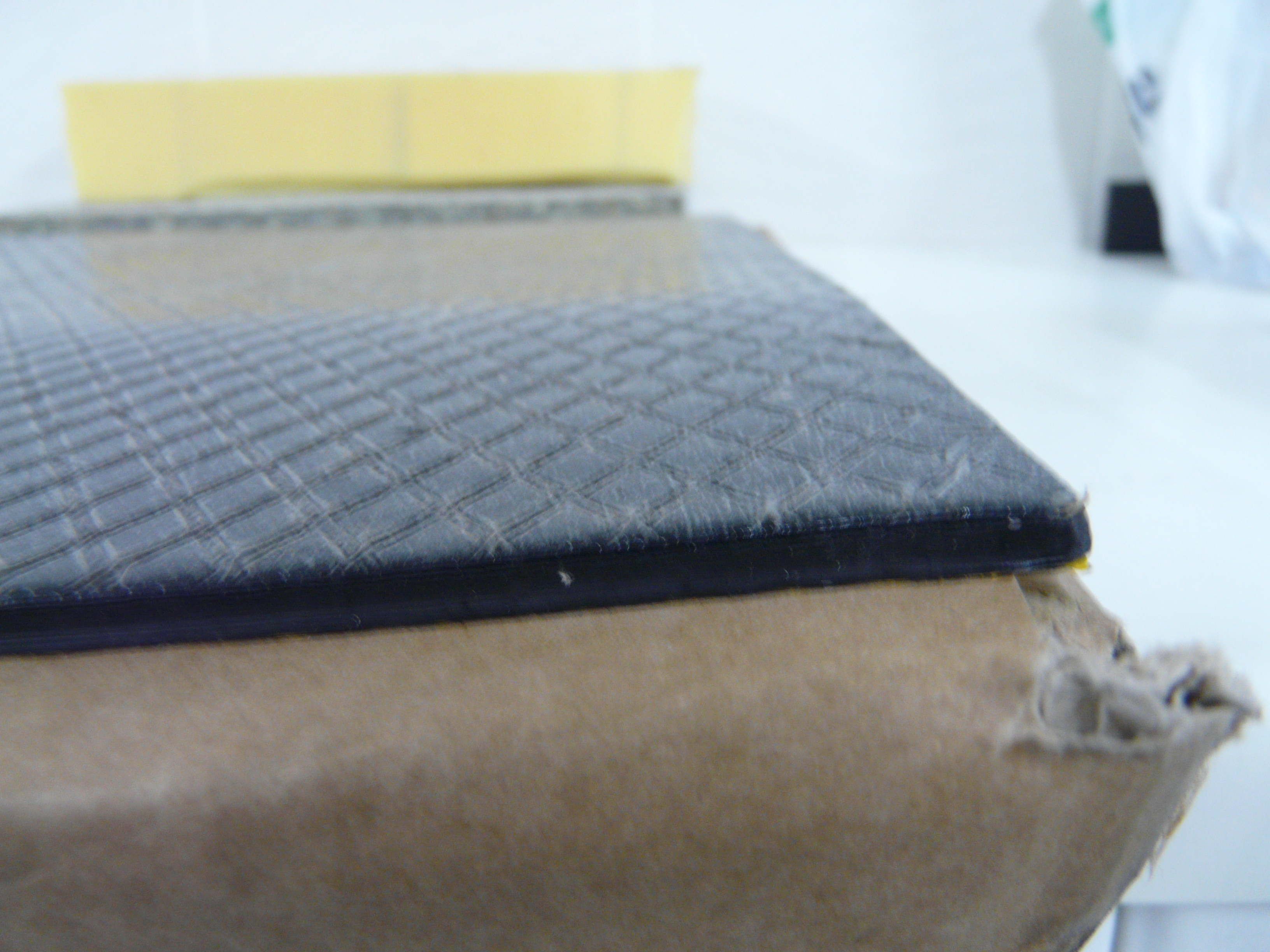

Nota : Regarding the bass from the 165KRX3 woofer, it took me many time to get rid of the rattles from the holder panel. I cover all the panel with bitumen plate. Did you face to such problem ?
