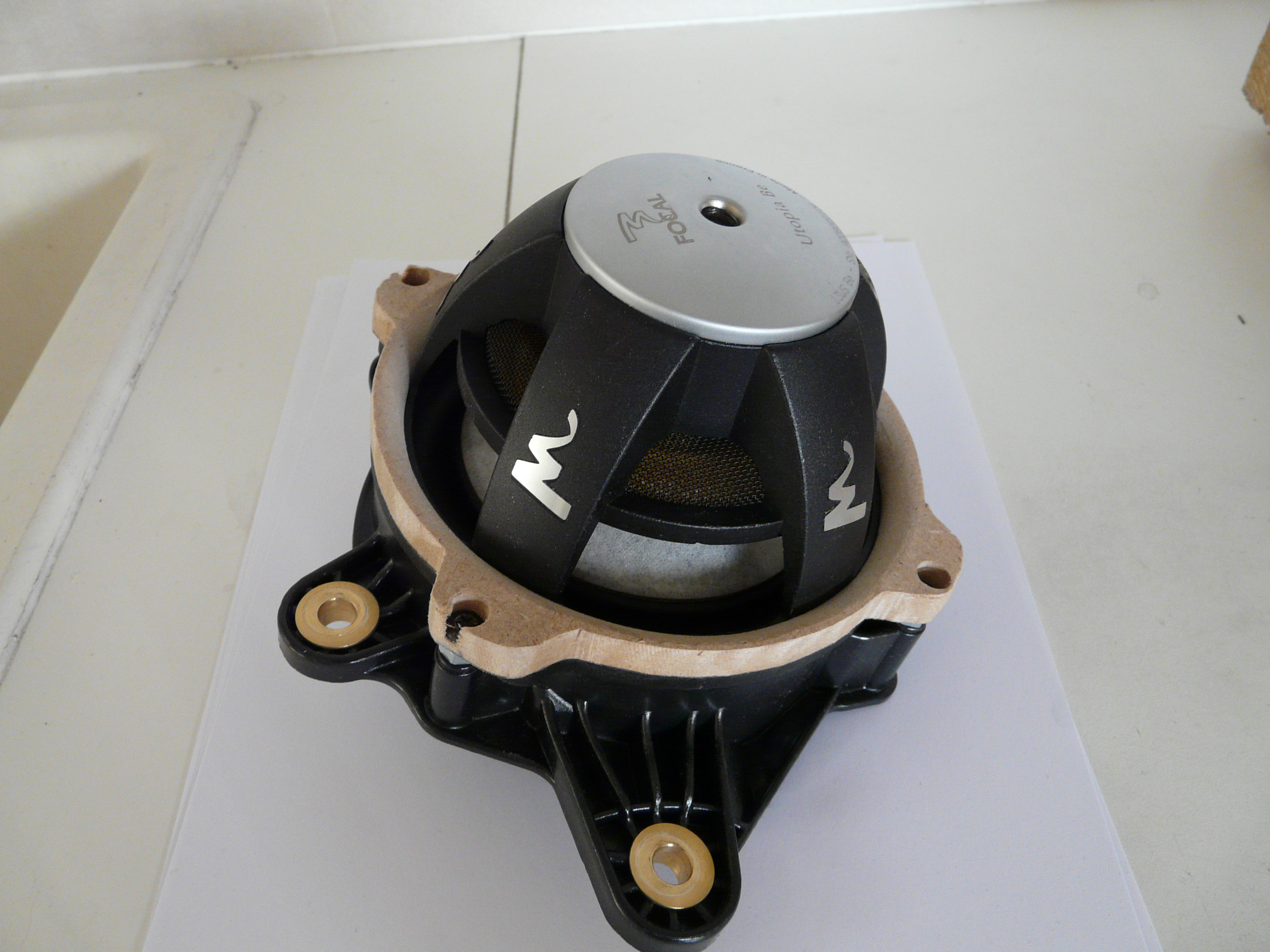

A second way to fix the sub on the Bose holder, I did it like that keeping Bose screws set-up...

I initially built a sub box that fit in the rear shelf, I made it as large as possible and was able to get 1 cu ft. but the thing was a tank, 30 lbs without a sub even in it and we’re already back end heavy. I've always believed a sub should be hidden in a trunk and that's not possible on the 911. I like a clean interior (OEM look) with everything hidden. I did a lot Internet researching tracking down what's in these cars (since my installer wasn’t familiar with the new design) and found a few different sites with the Bose/Burmester system and found some sizes and location where the OEM sub/speakers were located. I then found the Focal Utopia Be 5" sub and thought maybe that's an option. My installer said those were great little subs. I had a couple weeks prior to bringing my car in so I started investigating where the OEM sub is actually located. It's basically under the tweeter on the driver side. To access it you have to remove the shin airbag, remove a screw for a air duct and unclip two bracket sections of module and plug-in harness. But, you don't have to unplug any connection plugs, just move them to the side to gain access to the underside of the top of the dash. There are three bolts holding the sub in place. I had a sore neck after figuring out all that and removing it, it a very tight squeeze but it'll come out. I did all the measurements and decided to buy the Focal 5”sub. It fits great in the OEM location with minimal modification to the sub bracket. There is a sound chamber that runs from the driver side to passenger side and then two 2" sound ports at each side to let the sound in (driver side) or out (passenger side). See PIC below ofthe driver side to get an idea. I installed the sub and let my local installer do all the rest.
Initially an Audison Bit One was used to sum the Bose amp, but for whatever reason it didn’t work well and lack sound clarity. My installer has used it on Panamera’s but for some reason he couldn’t get it to work well with the PCM3.1 so it was replaced with Audio Control DQ-61 to sum the channels. He also replaced the 3” midrange of the165KRX3 up front with a 4” from the 100 KRS to get the mid-bass frequencies a little lower. Overall, I’m over joyed with the system. It has great bass and super clear highs. It sounds awesome at lower volume levels as well as when I crank it up.

Focal Utopia Be 13W (5")sub
