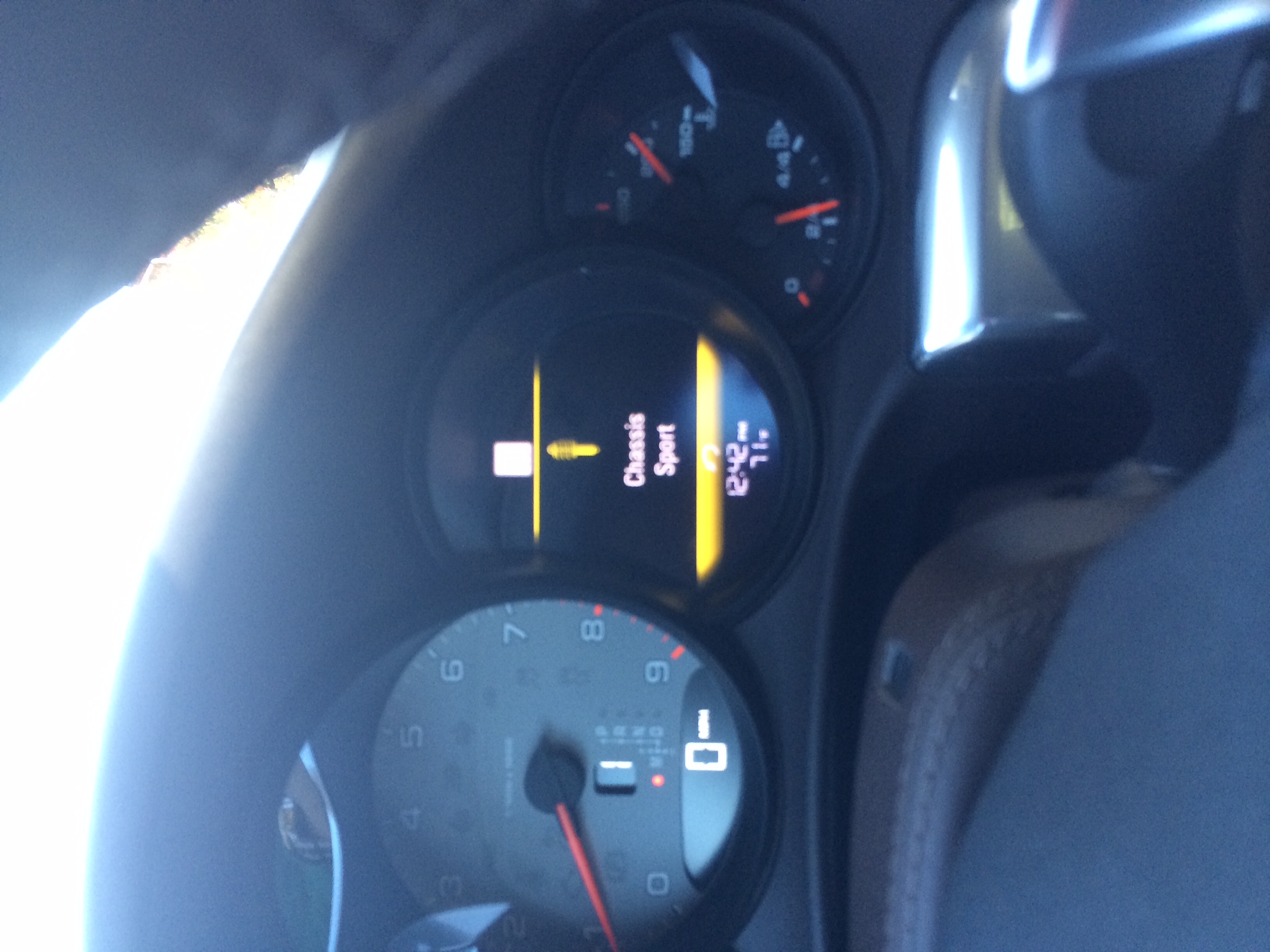

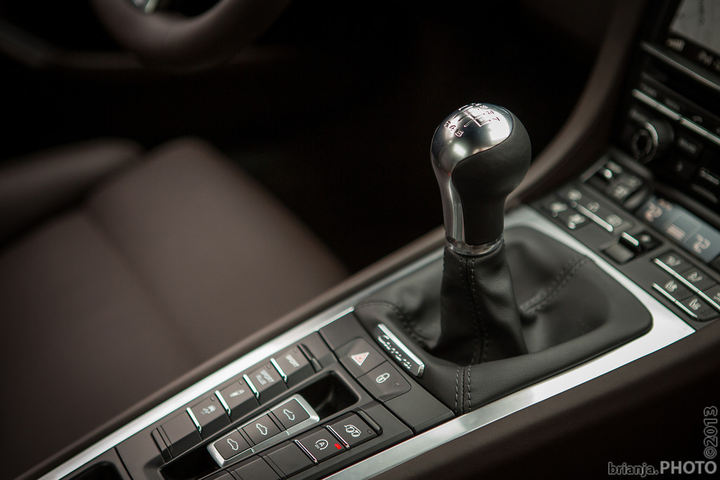

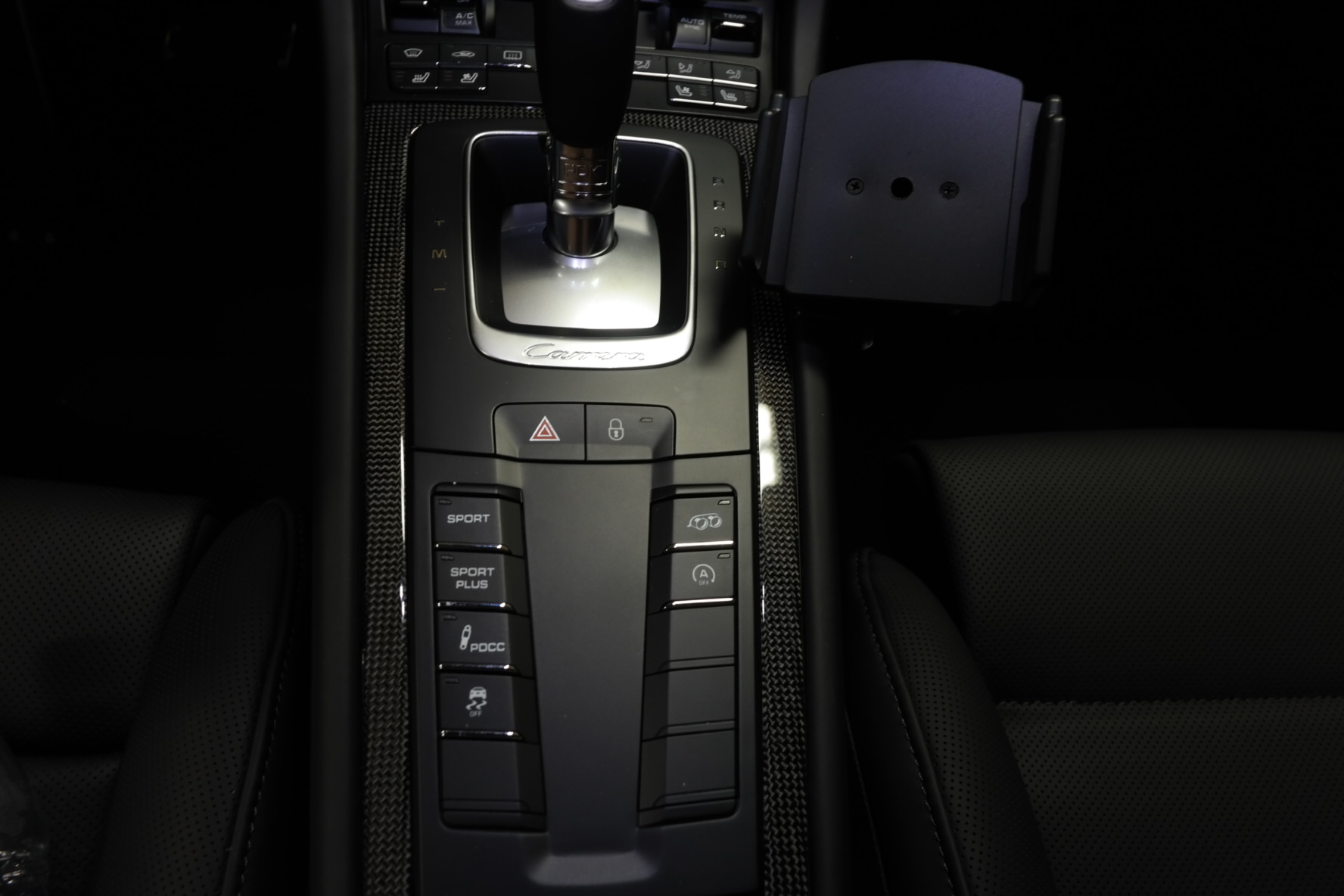

Is it me only who's puzzled by the function of the switch with "shock absorber" sign on the button stack in '13 (e.g., mine) vs. '14 (e.g., JoeInDallas) 991 C4S??
I have S-PASM as well as PDCC and JoeInDallas has the same - now the question is what this button actually does in his vs. my car? When I press it, it indicates "Chassis Sport" and I could feel that suspension is stiffer. I thought my PDCC is active all the time... What does it do in '14 model year cars with S-PASM + PDCC?
Is it linked to PASM in '13 but linked to PDCC (on/off) in '14 cars ??

I have the same as yours Fester ('13) albeit on a 2S. You are correct pdcc is always active. It does change its parameters when suspension settings are changed and sport suspension is on. I think that on '14 models it's only a change of the graphic.

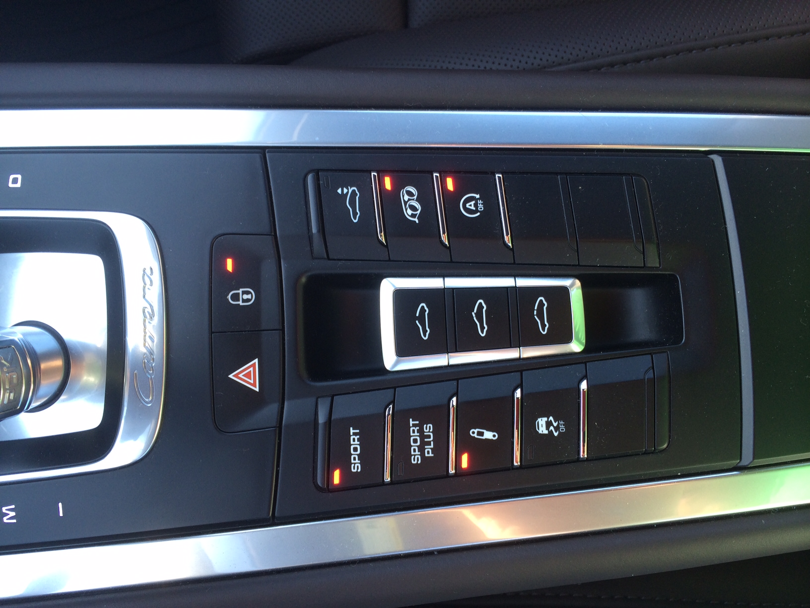

Originally Posted by STALKER
Where is the spoiler button on the 2014 car?
'14 car probably has Sportdesign kit or Aero kit. When the car comes from the factory with an immovable wing, they eliminate the button.
I have the sport design and (as you can see) there is no button.

PASM and PDCC are both "on" all the time. The sport setting for PASM biases the shock absorber toward the "faster rebound" end of its rebound parameter. The speed of the rebound is what is typically felt a "firmness (or harshness when it is sudden). PDCC modifies the roll bar stiffness, preventing the car from tilting in corners, which has a positive effect on the contact patch of the tires. Think "flattler" rather than "stiffer". The "S" in Sport PASM refers to to the shorter, stiffer springs on the car. They lower the car and restrict the amount of spring action compared to the standard springs. They have their own quality of variabiltiy- but due to the physics of the spring winding and material rather than the "active" control of the SPASM and PDCC).
All the components are carefull matched (along with the suspension settings) for optimal effect over the ranges of handling and comfort.

Also, I believe the marketing folks added PDCC to the suspension button to identify which cars have PDCC and which don't. Without that, buyers would need to know what to look for under the car (or get a tech to confirm) whether '12 and '13 cars actually had PDCC.

My car is '13 with S-PASM + PDCC & Aero Kit Cup and the button just show the shock absorber picture

Alright -- thanks guys -- so conclusion is that it's just the graphic change on the button for MY'14 cars...ah these marketing folks are out of control!!!

Chuck--great explanation. My PDCC/SPASM car has the shock button but without the PDCC stenciled on it. I think there is no change other than the stenciling.
