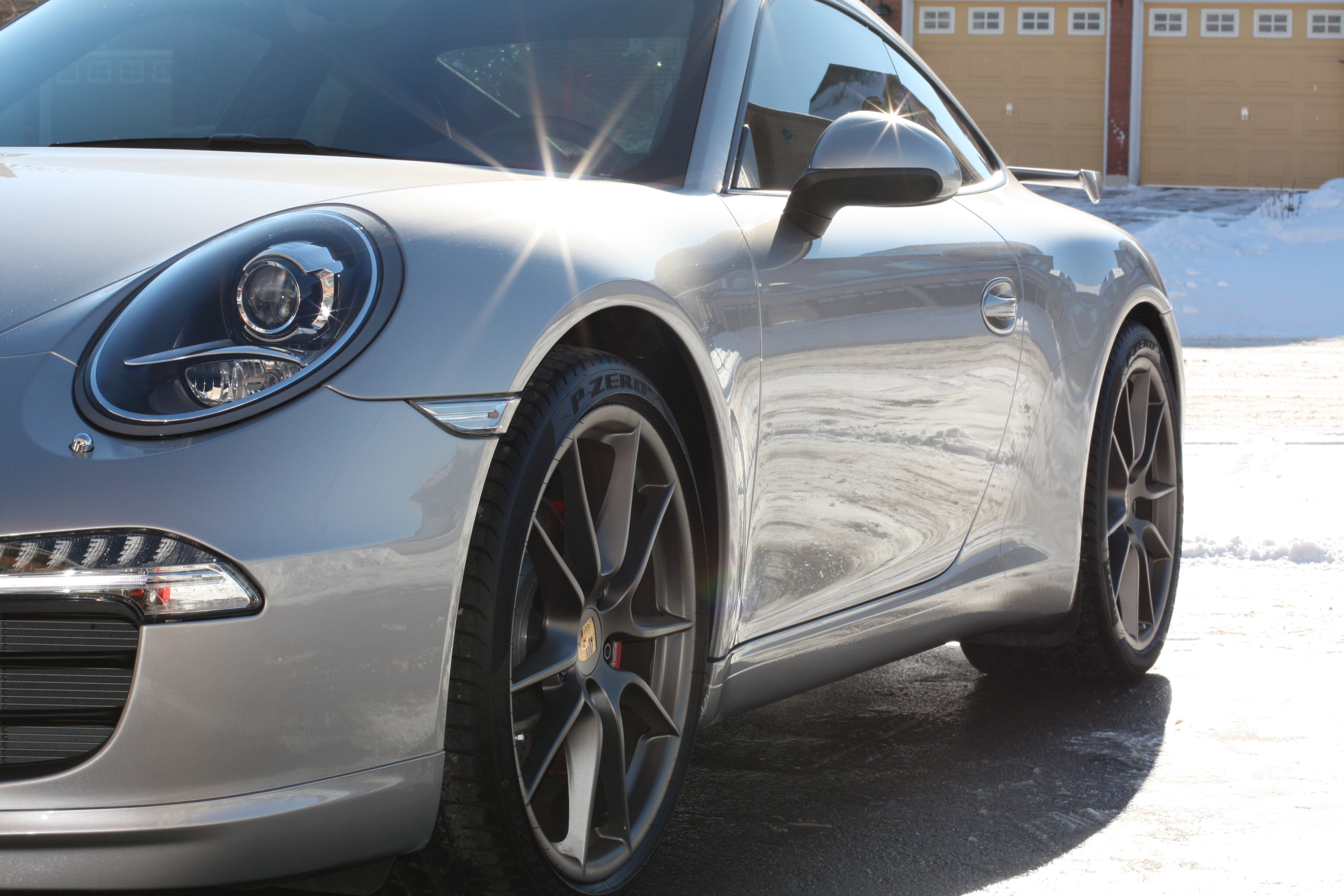

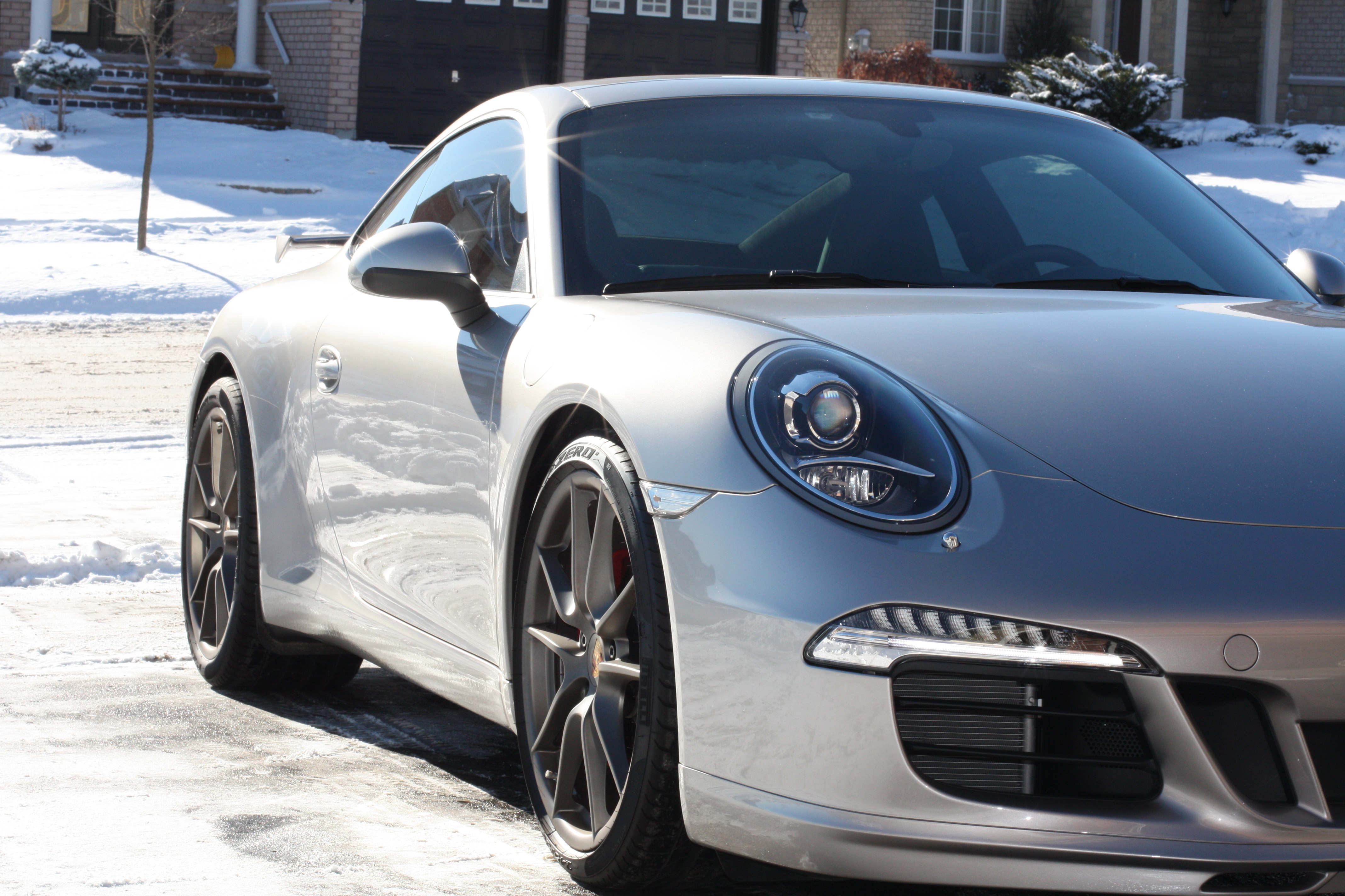

I have recently installed 7/15 on my C2S and it is perfect. I really cant believe why Porsche did not ship the cars with this setup. Here is a pic after the mod. The pic does not do justice, it looks so much better in person.

are u running oem 295 rear pirelli's. if so, what would u think about your same setup with mich pilot ss 305's in rear. too excessive?
