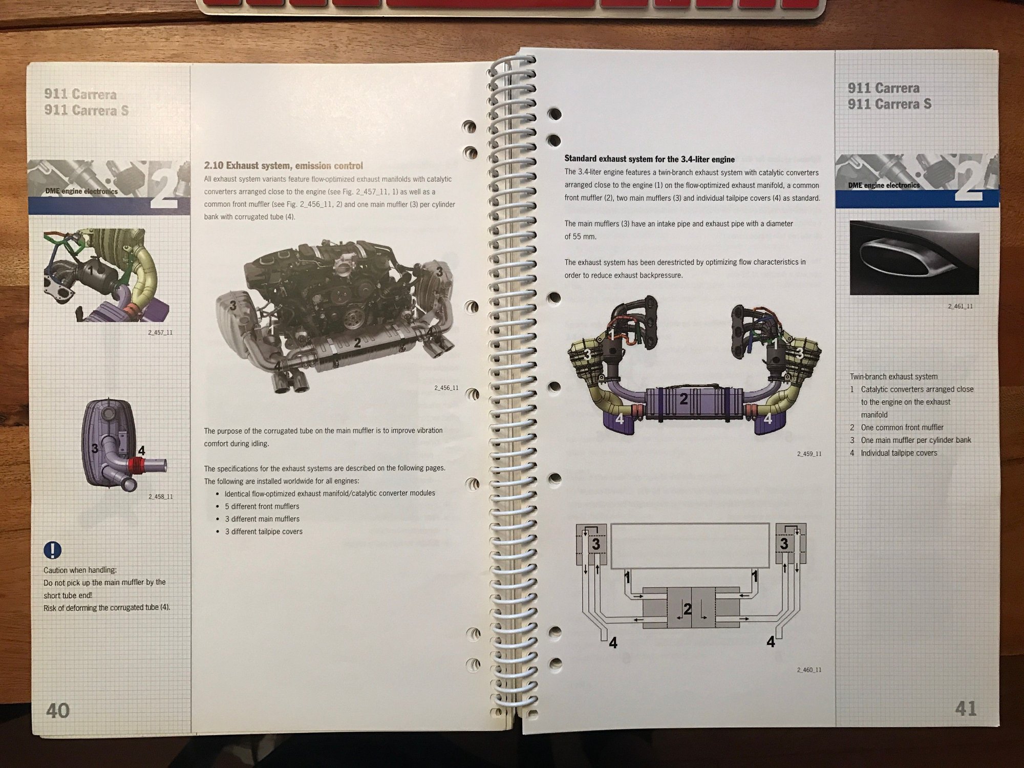

Stumbled across this thread while doing 991 exhaust research and wanted to clear up some confusion about the 3 types of exhausts avaliable from the factory. The attached images should clarify any future curiosity.
Porsche 991 3.4L basic exhaust system. twin branches w/ one common center muffler and two main side mufflers (55mm). No cross bank linking of exhaust flow.
Porsche 991 3.8L basic exhaust system. Four branches w/ common center muffler w/ two flap controlled bypass pipes and two side mufflers (55mm intake, 52mm exhaust). Bypass flaps are automatic underload, not user controlled. No cross bank linking of exhaust flow.
Porsche 991 3.4 & 3.8L sport exhaust system (PSE). Four branches w/ common center muffler w/ two switchable bypass pipes and two side mufflers (55mm intake, 52mm exhaust). Bypass flaps are controlled by mode or independently (sport, sport+ and or PSE button). Note: PSE includes cross bank linking of exhaust flow for increased resonance.
