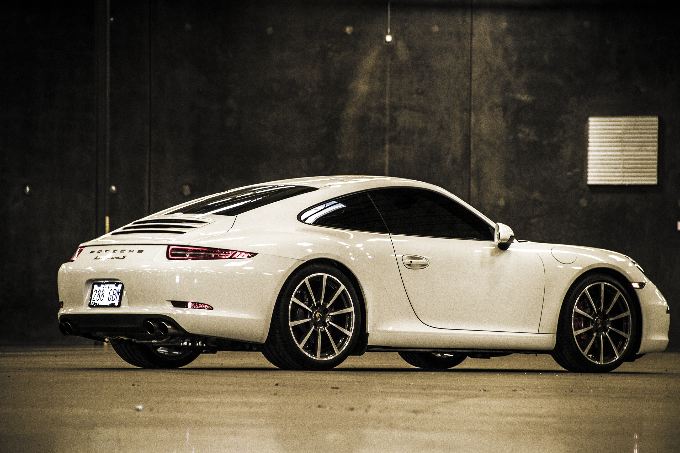

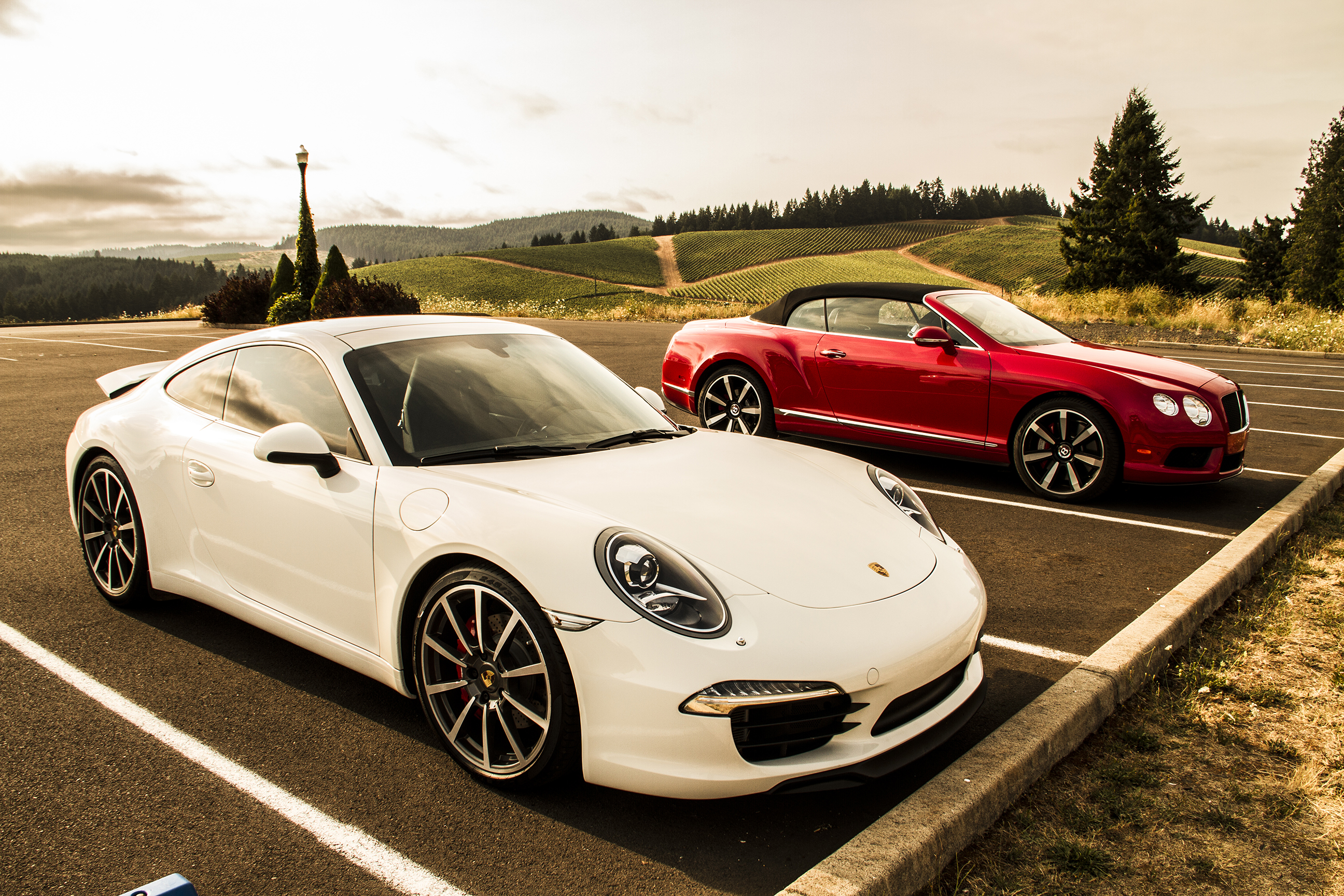

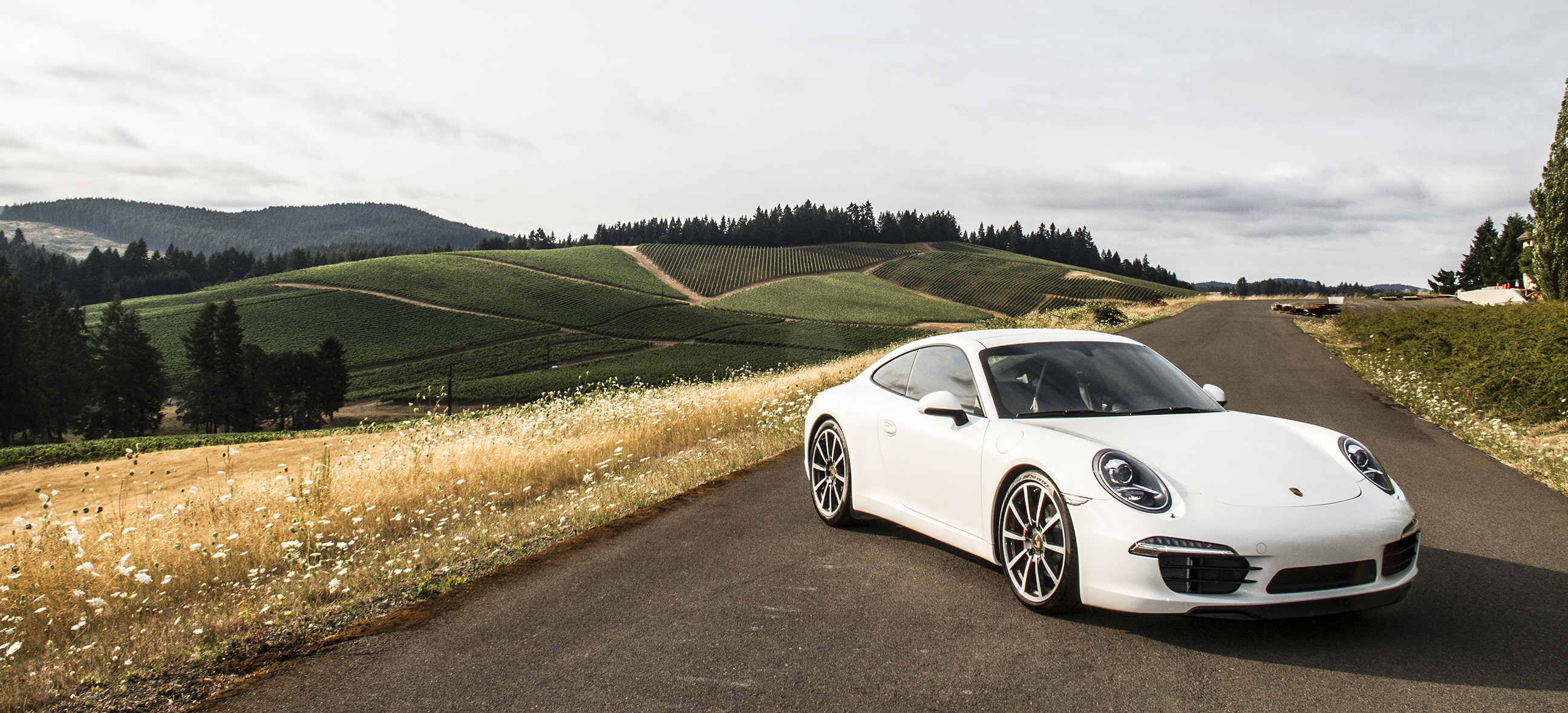

Hi all, new guy here from Oregon. A few months ago I picked up a very lightly used (1,873 miles) 2012 991 C2S PDK with Burmester, Sport Chrono, and some other goodies!
