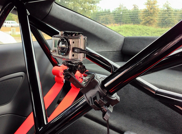

-GoPro inside the car: attached to my roll bar. Another option is to use a suction cup and attach it to the backlite

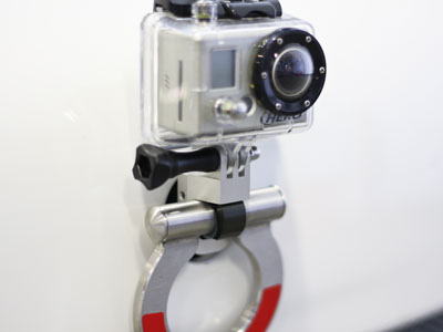

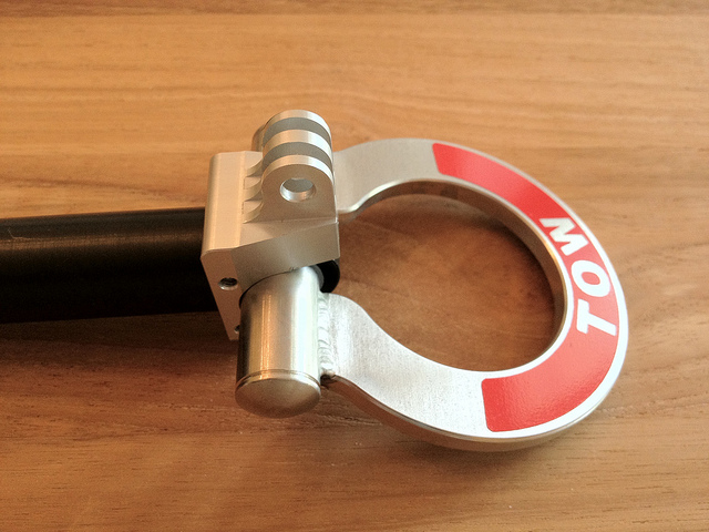

-GoPro outside the car: I am using a tow hook mount sold by Rennline. I synchronize both GoPro's using the iPhone App.

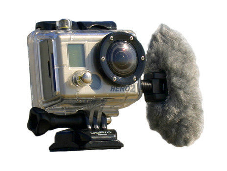

-Sound: I just purchased this external microphone that should reduce wind noise but I have no tested it yet...
