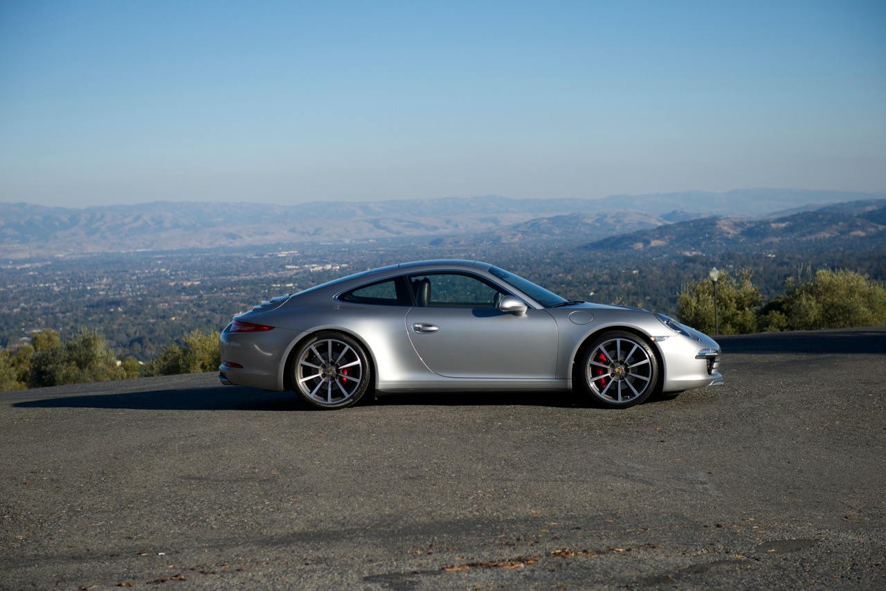

Here's mine PDCC+SPASM...very compliant with no/minimal body roll around the corners. Also compliant over bumps etc. Highly recommended!
