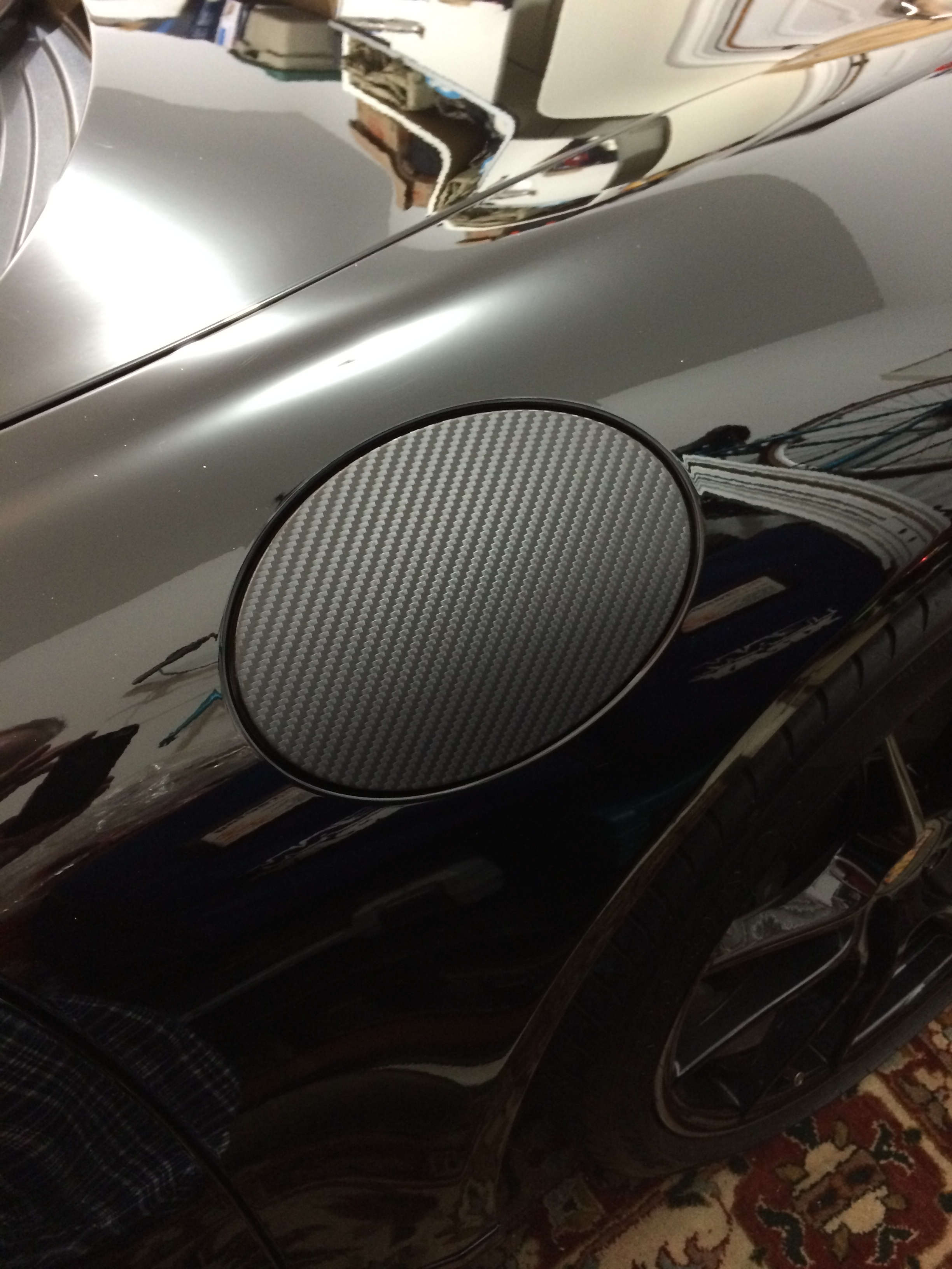

Here is a pic of the fuel door. I think it came out great! was really tired of people at the stations fingerprinting up the door. I hate not being able to pump my own gas here in NJ!
Nice job! How did you round out the curves so nicely? The vinyl always bunches up - and you had nothing but curves!

the trick with the wrap is to stick it to the surface and gently heat the vinyl and stretch it around the curve. then trim in up on the inside. You can do it!!
