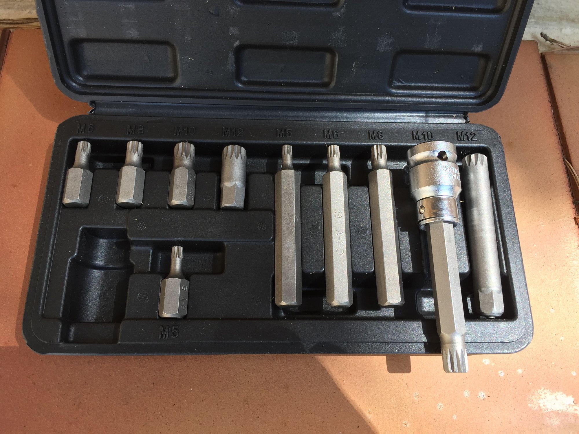

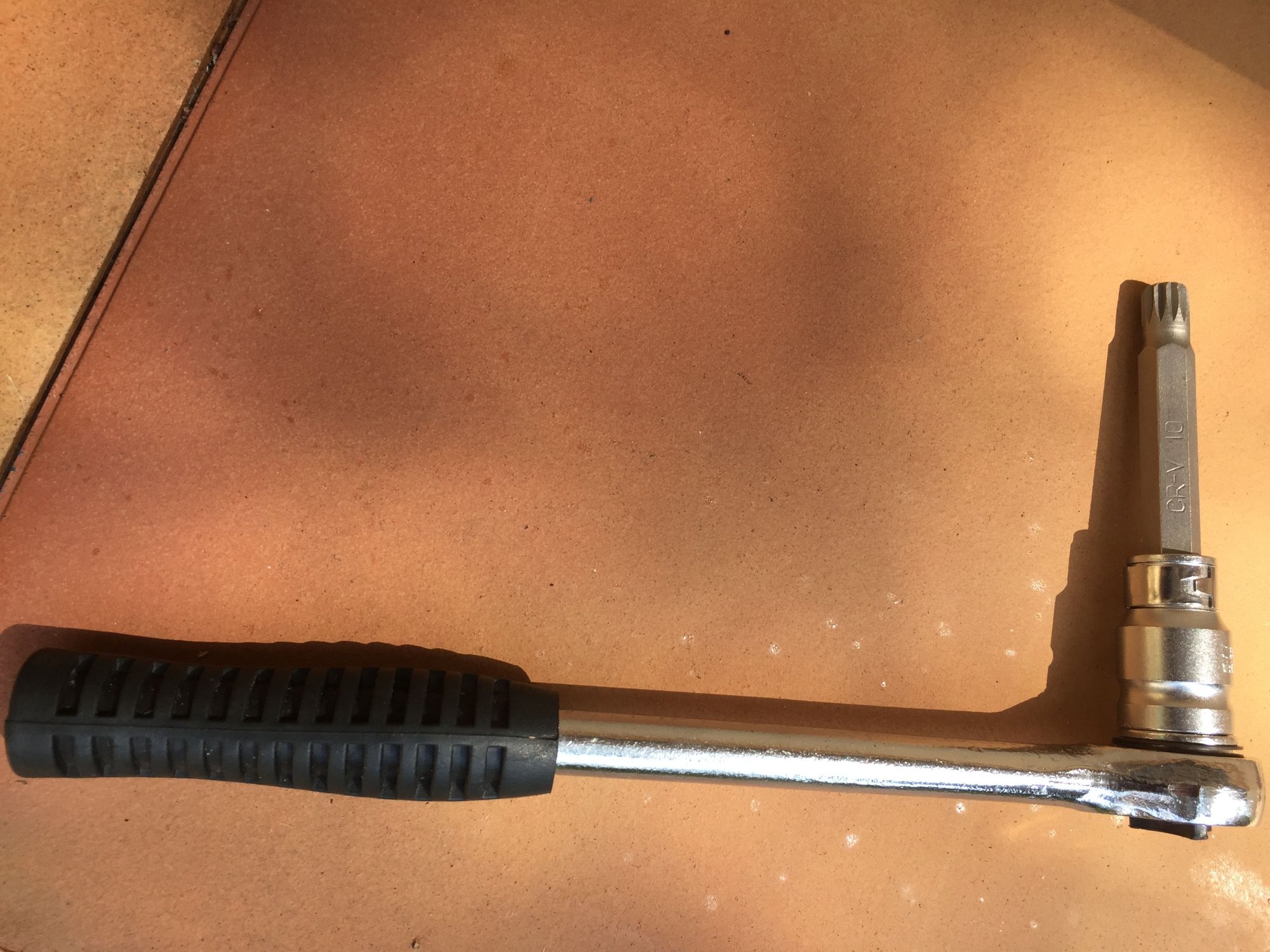

My personal experience:
My car C4 991.1 PDK LuxorBeige. Multifunction not heated Steering Wheel. No Chrono Package.
Following this excellent post from Liamdoung I did the swap to Multifunction heated Steering Wheel in Black. I found it in Ebay from Germany. Very good price.
As mentioned ¨PMNewton¨ XZN TripleSquare M12 long bit fits perfectly in the Bolt. See the picture. I found a very nice set of those bits online for just 9€.
The job was really straight forward after reading this article.
Multifunction works perfectly. Heating system is not working considering my car has not this function enabled in the system. I live in Spain, so not many cold days...
I am very satisfied. Thanks all of you, specially Liamdoung and PMNewton
