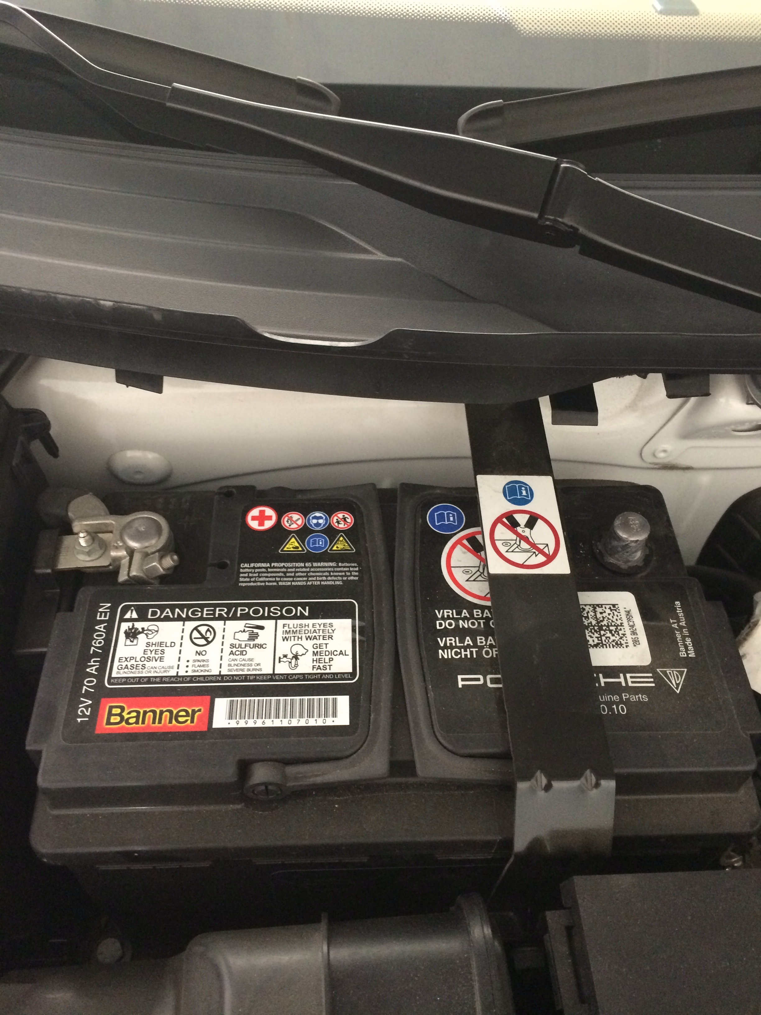

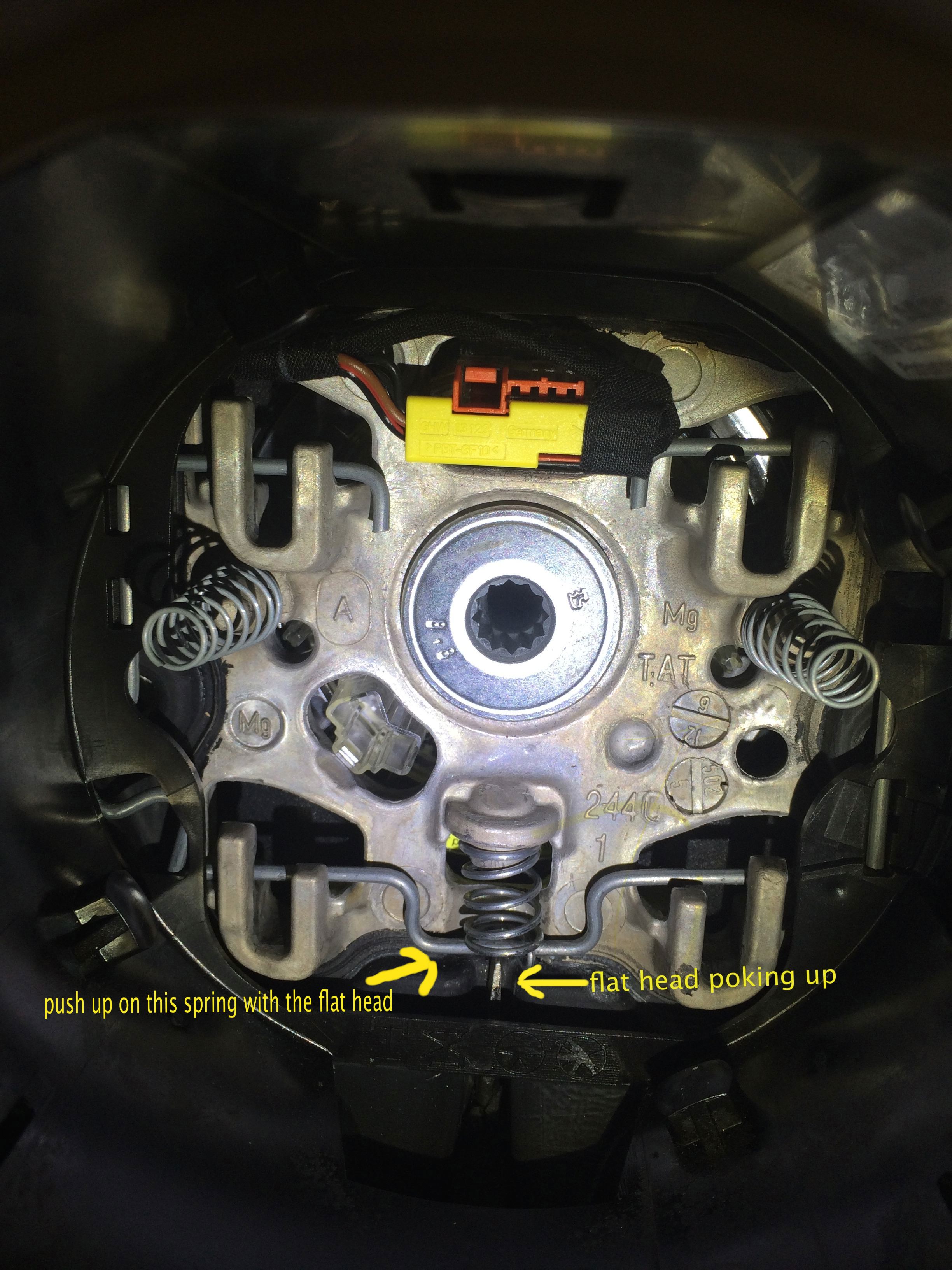

1. Disconnect battery (negative terminal)
2. straighten out wheels and steering wheel

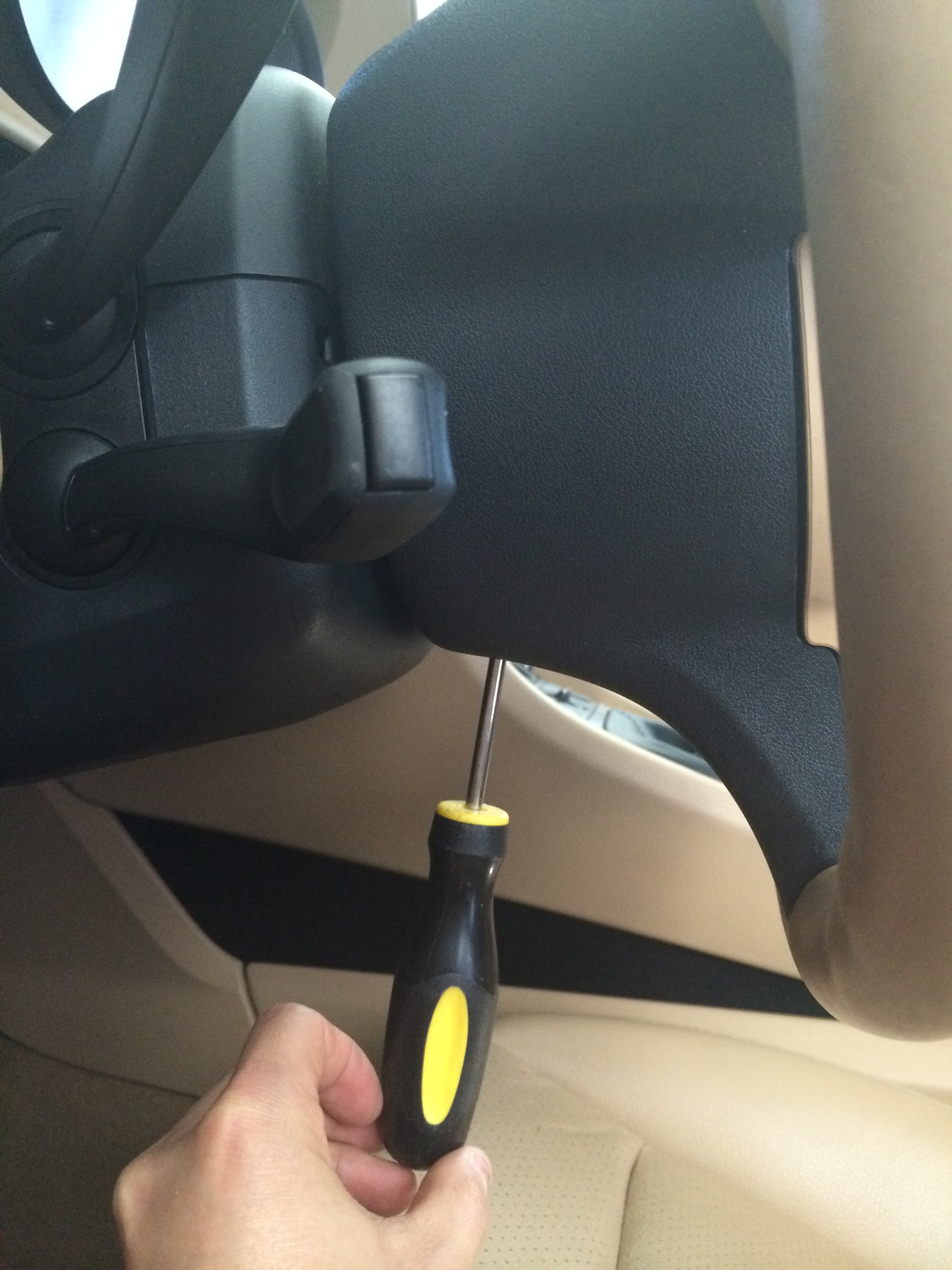

3. using a small flat head (or something of the same size) and insert it up through the tiny hole below the steering wheel. What you're trying to do is to push "UP" on a spring. The airbag will release when you push up on the spring.

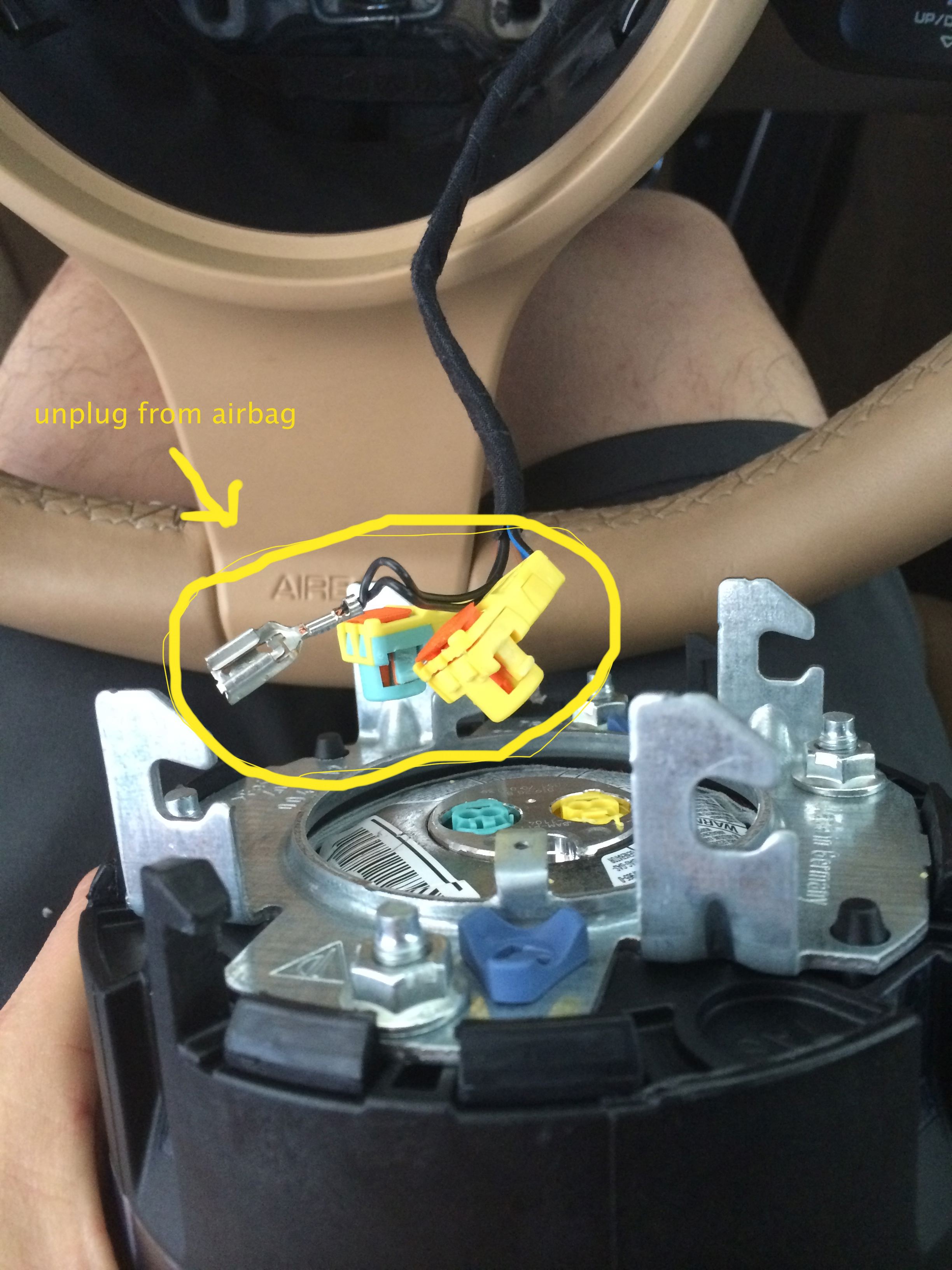

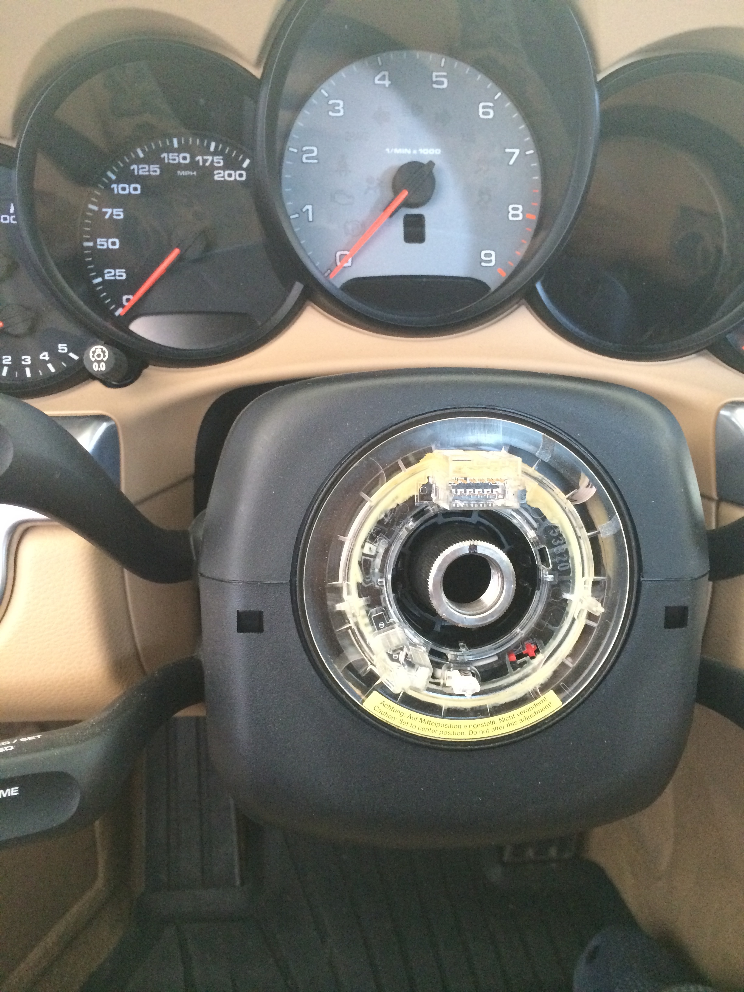

4. take out the airbag and unclip all the connections from the airbag and the one connection at the back of the steering wheel .

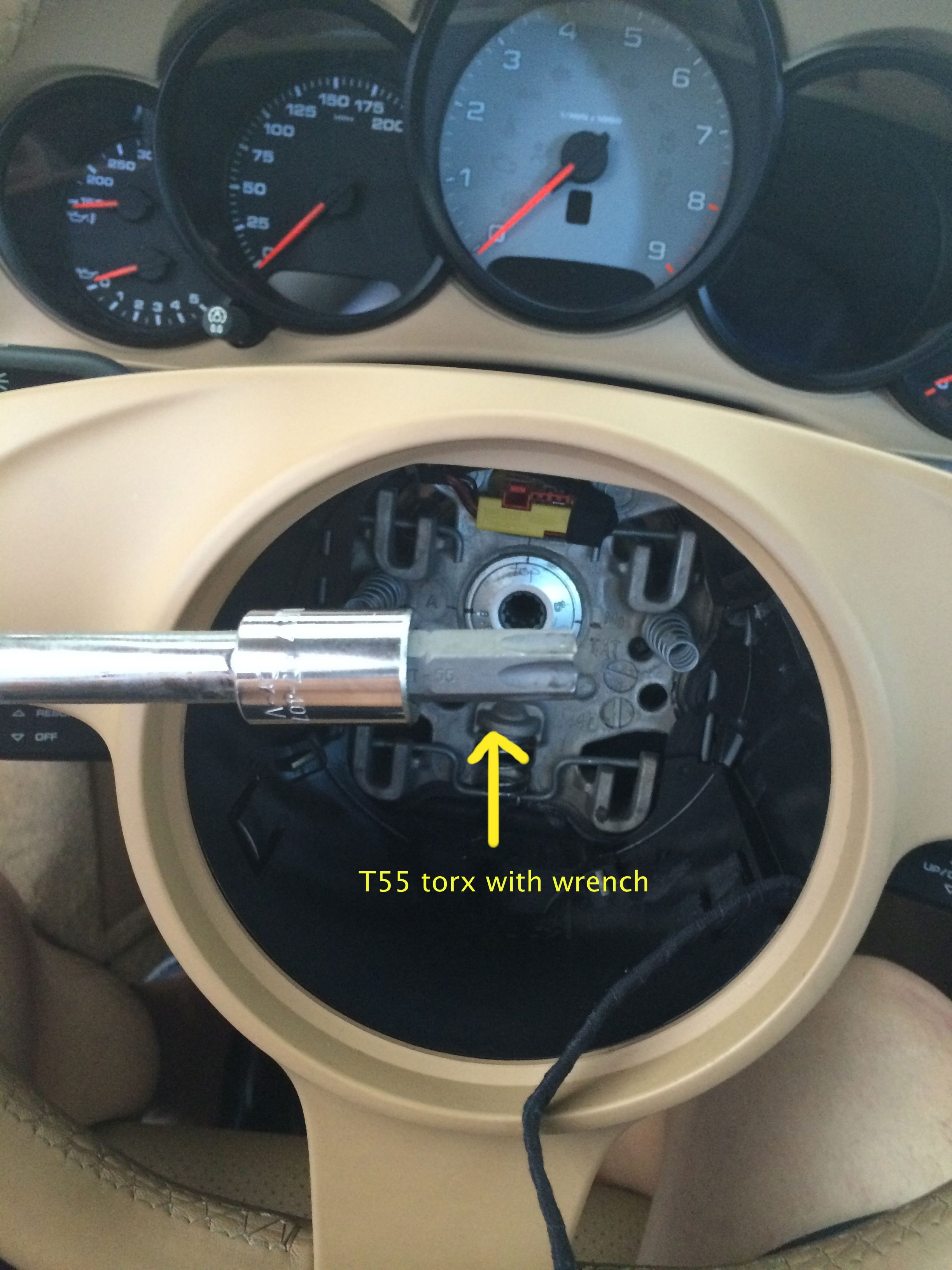

5. using a t55 torx bit and wrench, unscrew the screw in the middle of the steering wheel. DO NOT TAKE THE STEERING WHEEL OFF!!!!

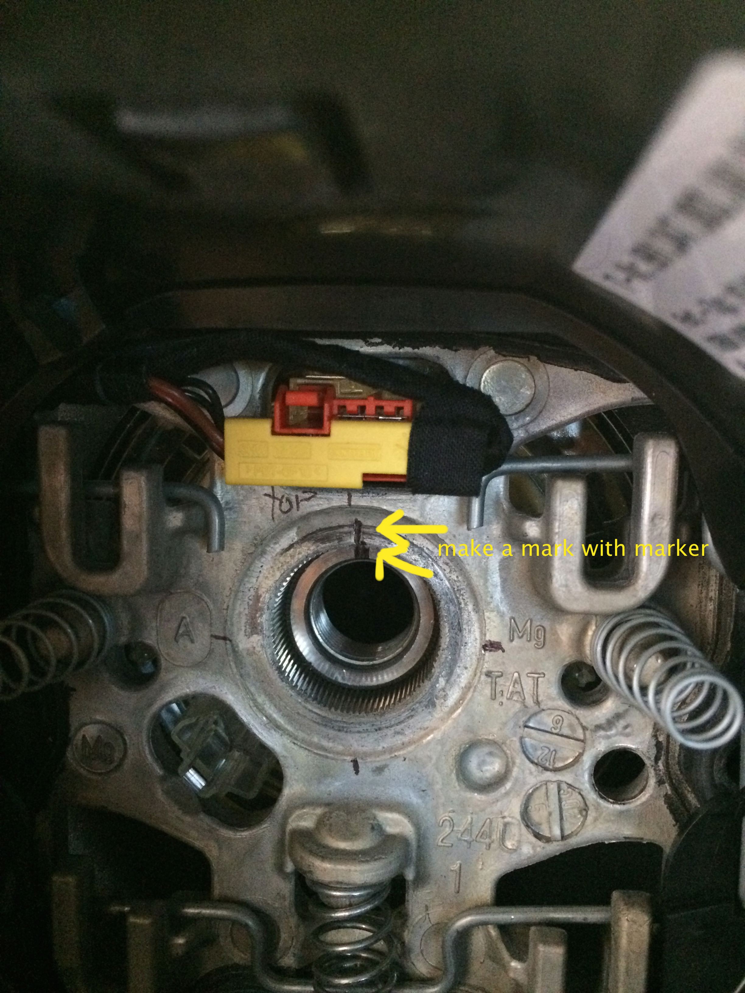

6. Before taking the steering wheel off, use a marker and make a mark as shown in the picture. So that when putting the steering back, it in the right position.
7. Now, take the steering wheel off. Put the new wheel back on, make sure to align the small notch(cut) on the ring of the steering wheel with the mark that you made earlier. Connect the airbag and all the connections. Push the airbag back and it's done.

forgot one thing, I torqued the screw at 37ftlb.
