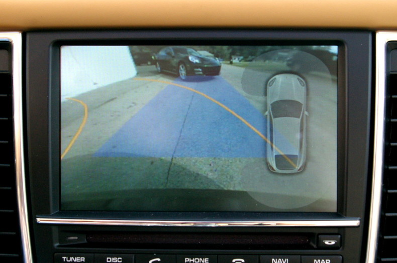

Originally Posted by Rapture1
I have a question, are there any camera's that provide the "active" parking lanes on the PCM? And is it only the camera that supports this feature or also the specific interface?
Thanks,
You have to separate Camera from Interface to answer your question....
Camera provides a video source
Interface is what you need to pipe the video source to PCM unit, as well as possibly CANBus integration.
I don't believe there is a camera unit out there that is also providing integration with PCM -- I could be wrong, as there are a LOT of camera solutions out there. You should be able to purchase any camera as a video source, both wired and wireless. Depending on what PCM interface kit you choose, you may also have multiple cameras as video source -- some members here have posted they have forward as well as rear-facing cameras. You switch between cameras using the SOURCE option on the PCM unit.
To integrate the video source with PCM, you actually need an interface unit like the ones offered by NAV-TV. The PCM 3.1 unit has everything else "built-in" - such as video source activate upon putting transmission into reverse, and displaying distance and front-wheel position ( I think that is what you are calling "parking lanes"?) graphics overlayed on the video source. The PCM unit likely gets this detail from CANBus integration, ie it knows steering wheel position, gear selected, park distance control present, etc.
As for video, or images -- I've recommended searching this forum. But here is a pic that I've posted previously (not from my car). There are also videos posted out there and on the NAV-TV site (they may be from Panny or Cayenne, but same PCM unit).

This is the NAV-TV version that is for PCM 3.1... This is probably the most straightforward, as you don't have to open up your PCM unit (void warranty) to get it to work right. It automatically switches in when you go into reverse and the video is overlayed with your Park Assist (if installed). It should work just like a factory installed..
http://www.navtv.com/product/164/pcm3-1xg-cam.html
Has a in-line harness that plugs into your PCM and is a relatively simple install. So you run it to power and run a video cable back to the license plate to install the camera. You could do wireless cam, as well but that has it's downfalls..
I think this may be the same that tadi bros sells and a few have bought, although their website is such a mess it is hard to tell what you are buying.
There are a number of installers I believe who are using this if you aren't up to the task yourself.
What you need to watch out for are the one (all that was available up to recently) that required you to open up the PCM unit (voiding the warranty) and install a ribbon cable. This is a simpler cleaner install.
+1 I'll clarify tho that PCM3.1-XG-CAM doesn't actually come with a camera. The $699 price is just for the integration unit that plugs into the back of the PCM unit and to which you need to plug-in your video source. You can buy any camera. Also, this is single-source. If you want multiple cameras, or video-in-motion, there are other NAV-TV products you can select from. Correct, this model is truly plug-and-play and does not require opening the PCM unit case in any way -- which is nice if you ever want to remove it....
