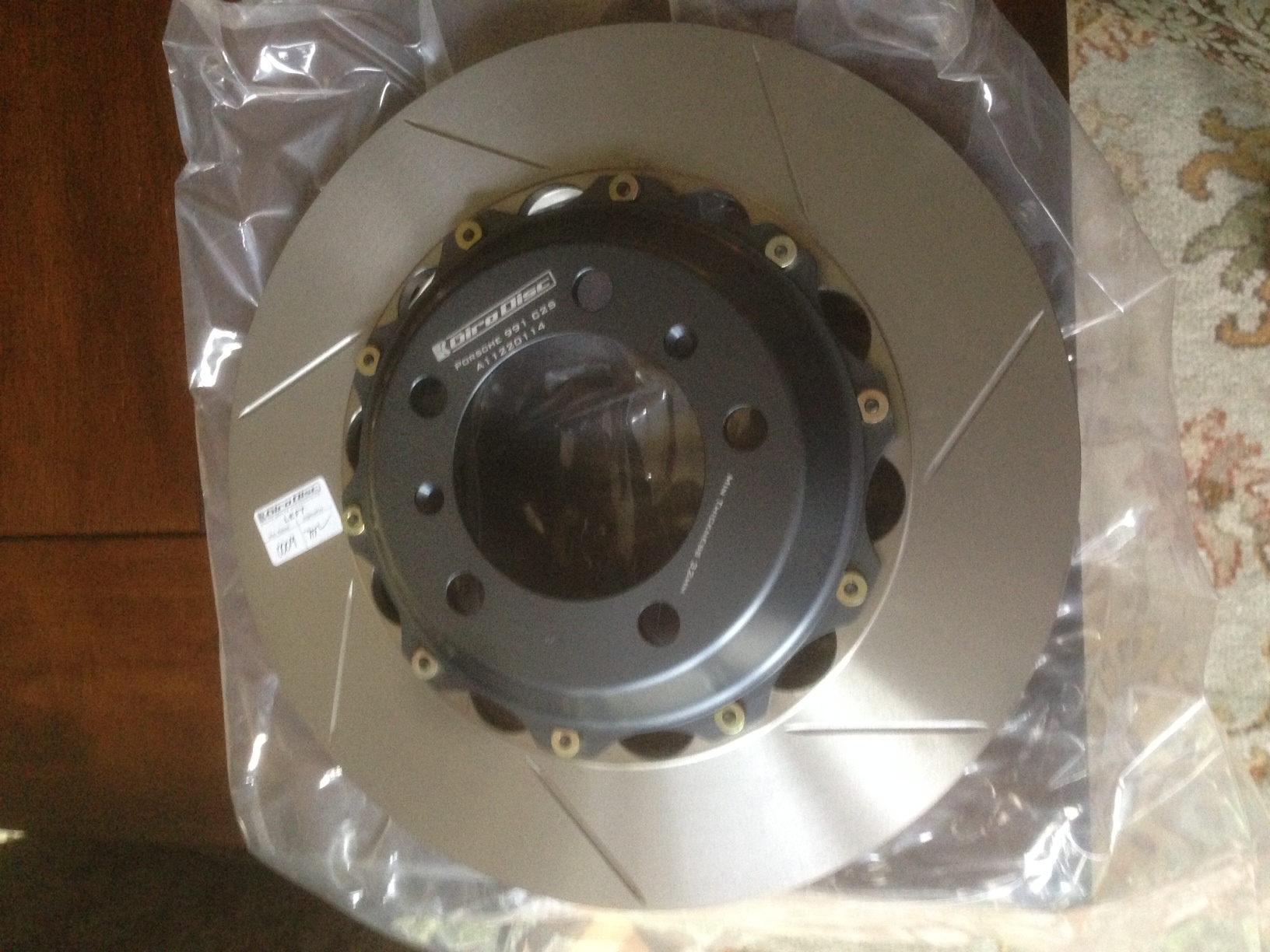

They look cool. This picture does not really show how their true size.
Marc

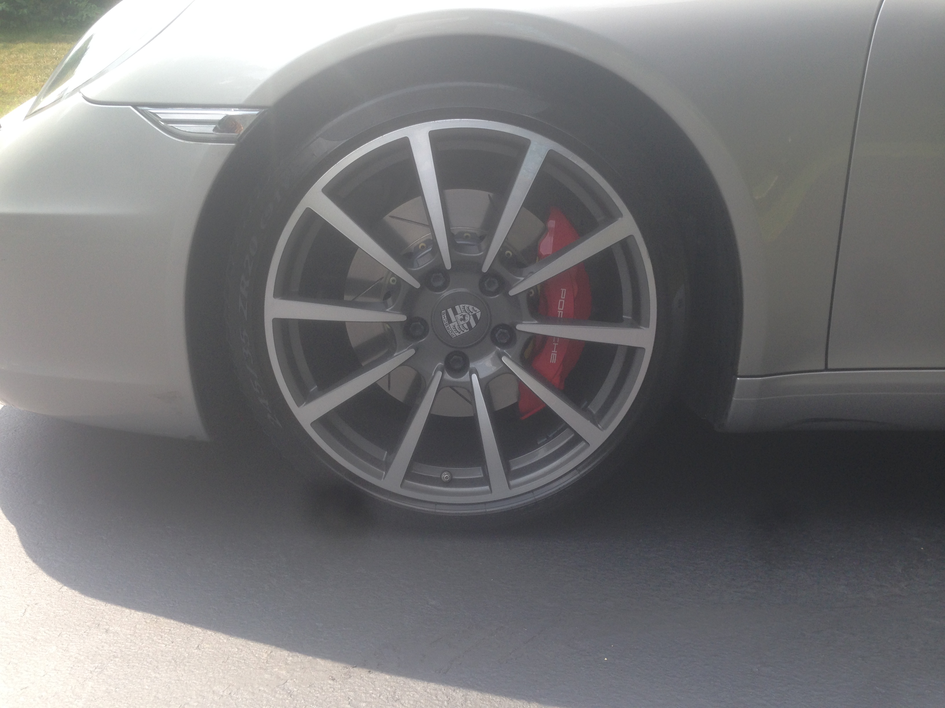

So both Stable Energies and Girodisc got the disks ,pads and fluid to me in plenty of time to get them installed. A big thanks to both who had to deal with my OCD and million questions. Got the car back with the new disks and pads installed.
The initial thought is that they are awesome. Solid feel. Not grabby. Lots of confidence. Keep in mind this is all on the road. Track day will be Aug 15th. Even the Porsche mechanic was impressed from his test drive. And he didn’t want me to do it.
The bummer is they are noisy. I knew this going in but may have been a little naive on how noisy. From 10mph to 0 they squeal like pig. I will live with it for the track season.
More to come after the 15th.
Marc
Name:	Slotted brake.JPG

Spent the day at Road America on Friday with the Milwaukee PCA. The new Girodisc and Padig pads were awesome. They provided a firm feel with zero fade. They inspired confidence in the braking zones. Two things I did notice. First, they were so powerful that I was getting into the anti-lock quicker and more often. Second, after some hard laps the car’s rear end would dance a little in the hard braking zones. Similar to when you have to much brake bias to the rear. Not sure why it would be happening. I was running with another guy who was rocket quick and he mentioned that he saw it as well.
My tires are shot and the day was pretty warm. So I didn’t really see especially quick times. The turnout for the event was high so we did spend a lot of time waiting and passing.
Marc
