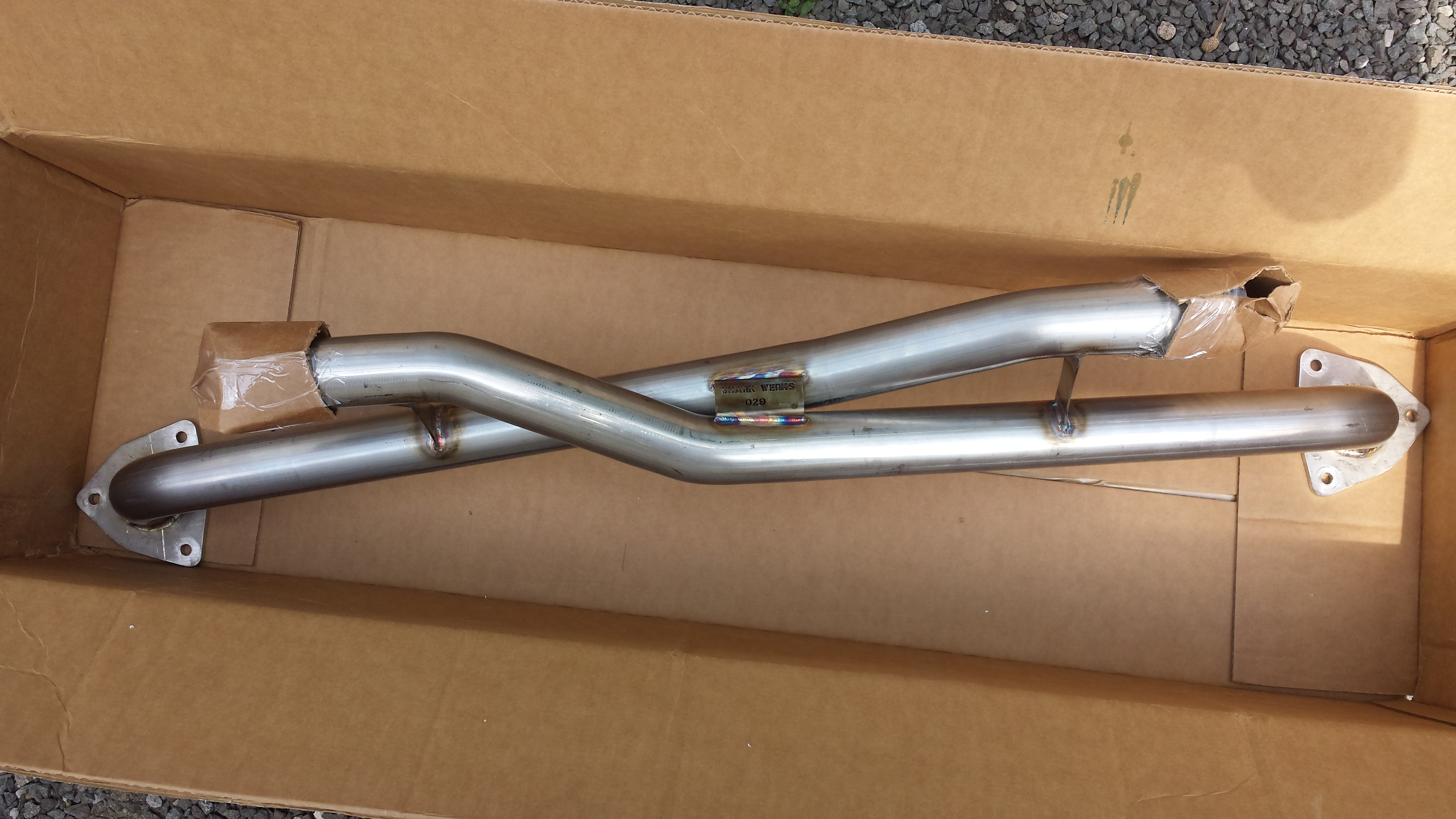

Yesterday, I installed the Sharkwerks crosspipe / center muffler replacement for the 3.4L engine on my manual transmission / zero option car.

Now, 3 mufflers is just a little much in my opinion, and I didn't want to spend $$$ on a full replacement exhaust. I debated going the easy route and getting the PSE, but the cost ($4k) plus labor was not something I wanted just for a little more excitement in the sound area. (And, frankly, I like the wide-mouth-bass oval tips better than the dual tips.)
I naturally landed on a center-muffler delete, and debated the various designs. In the end, the Sharkwerks pipe won out, as it was very reasonably priced, and I liked the sound on the website videos. And, it looked like a very easy DIY install. I placed and order, was was filled promptly, and began to wait for it to arrive.

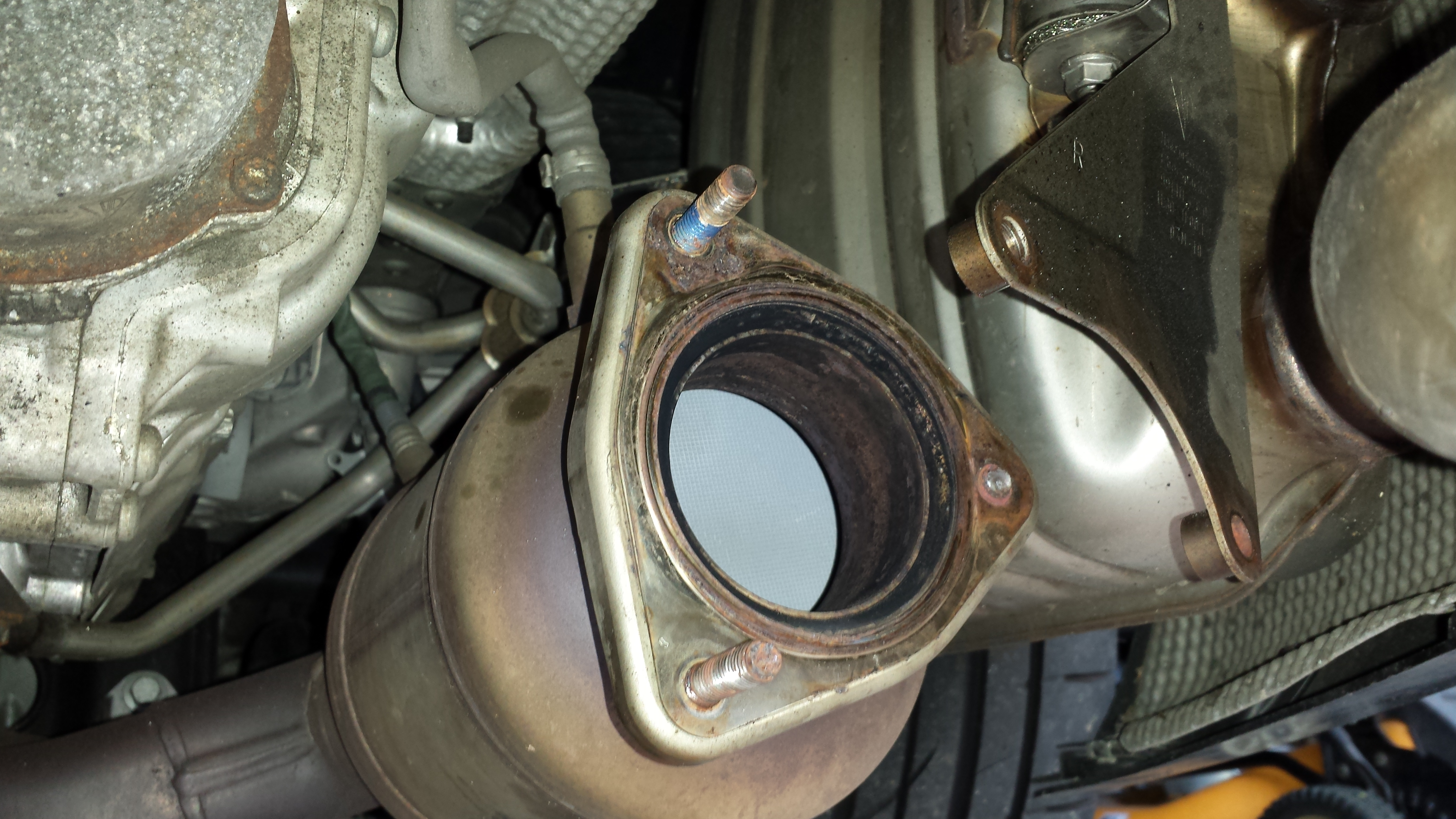

On sunday, I started to tackle the center muffler removal. No jacks, just left the car on the ground. It was a very straightforward process - remove the tips, unbolt the flange, remove the connectors, and undo the straps. It went very smoothly, except I snapped one stud on the right cat (NE winters and harsh salt created a lot of rust and corrosion on the exhaust connectors...and I only used regular WD40 rather than a rust penetrator which was a mistake).

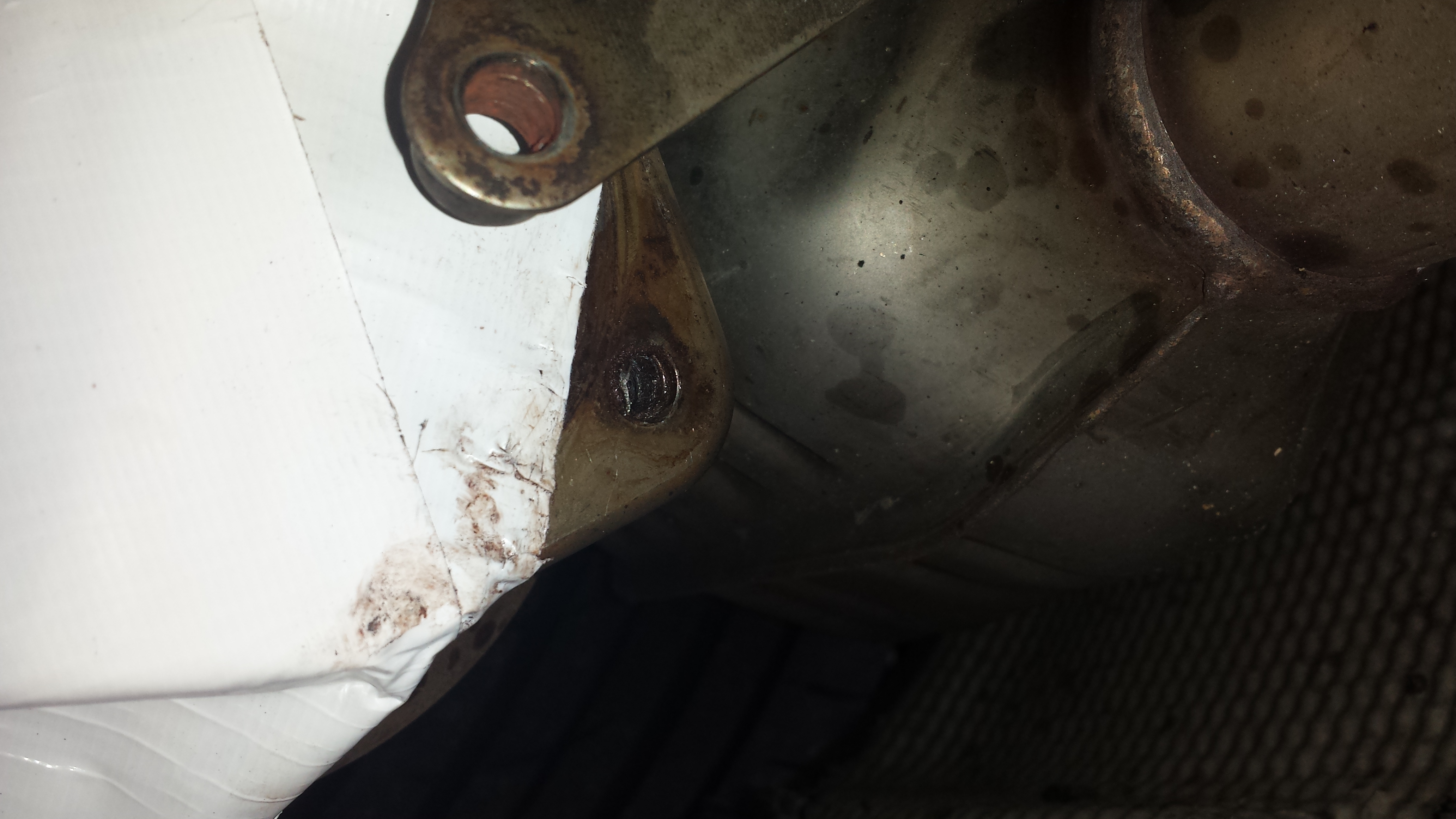

I promptly panicked, and both posted on this forum (thanks drcollie, viper3838, and lunarx!) and sent an email to Sharkwerks. They responded, even on a Sunday, with some very good advice. I decided I didn't want to remove the header and play it ultra-safe, so I decided to drill it out. Pulled out my cordless drill and metal bits, and worked up from a 1/8" bit to a 3/8" bit. I tapped out the remaining piece with a punch and a very small hammer...it tapped right out. Mission accomplished, took about 1/2 hour to drill it out. I replaced it with a high-strength bolt.

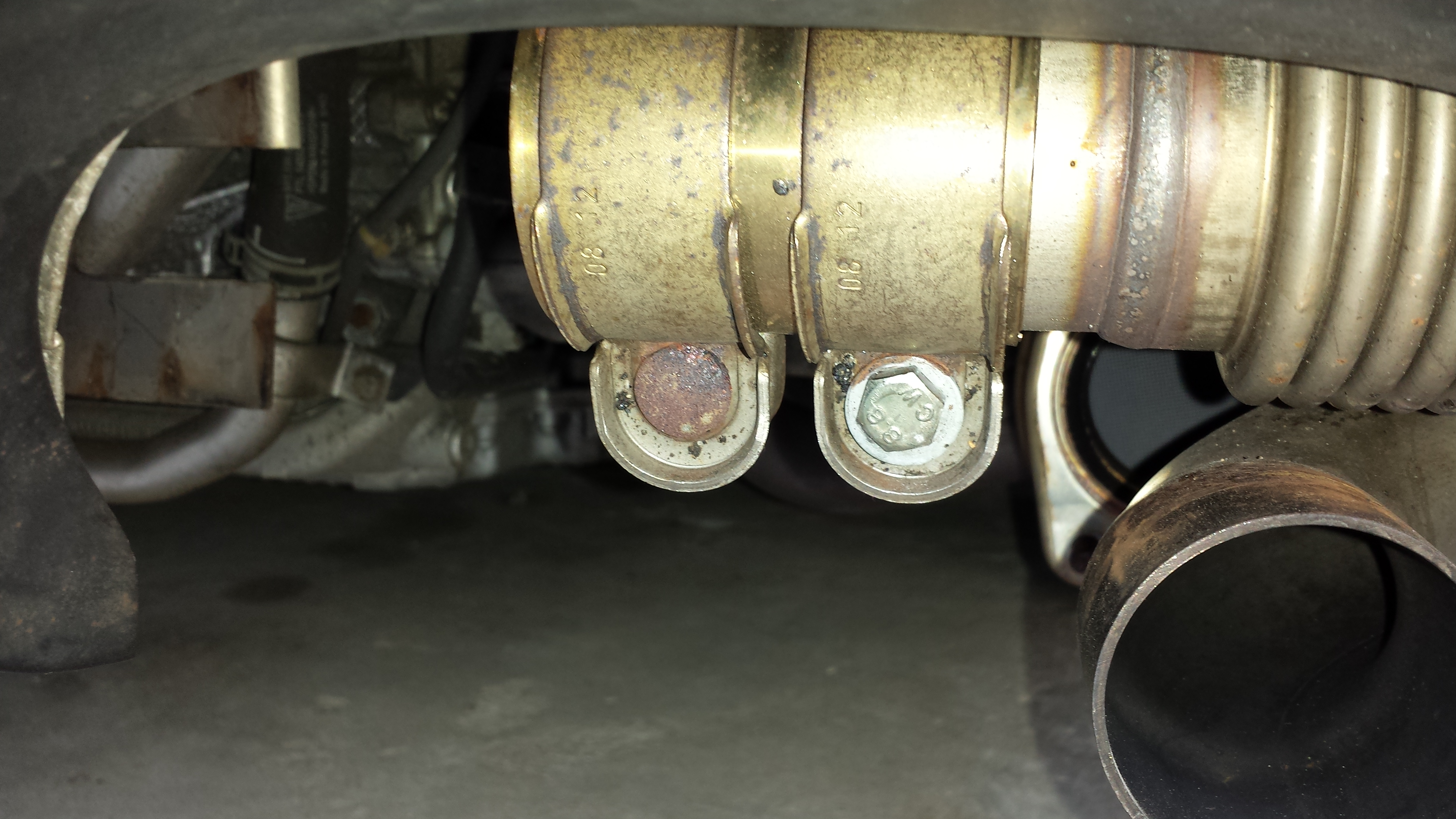

I also discovered that I wasn't the first to break a bolt on my car. The dealership must have broken one of the sleeve bolts when they replaced my side mufflers under recall. It was replaced with a cheap bolt.

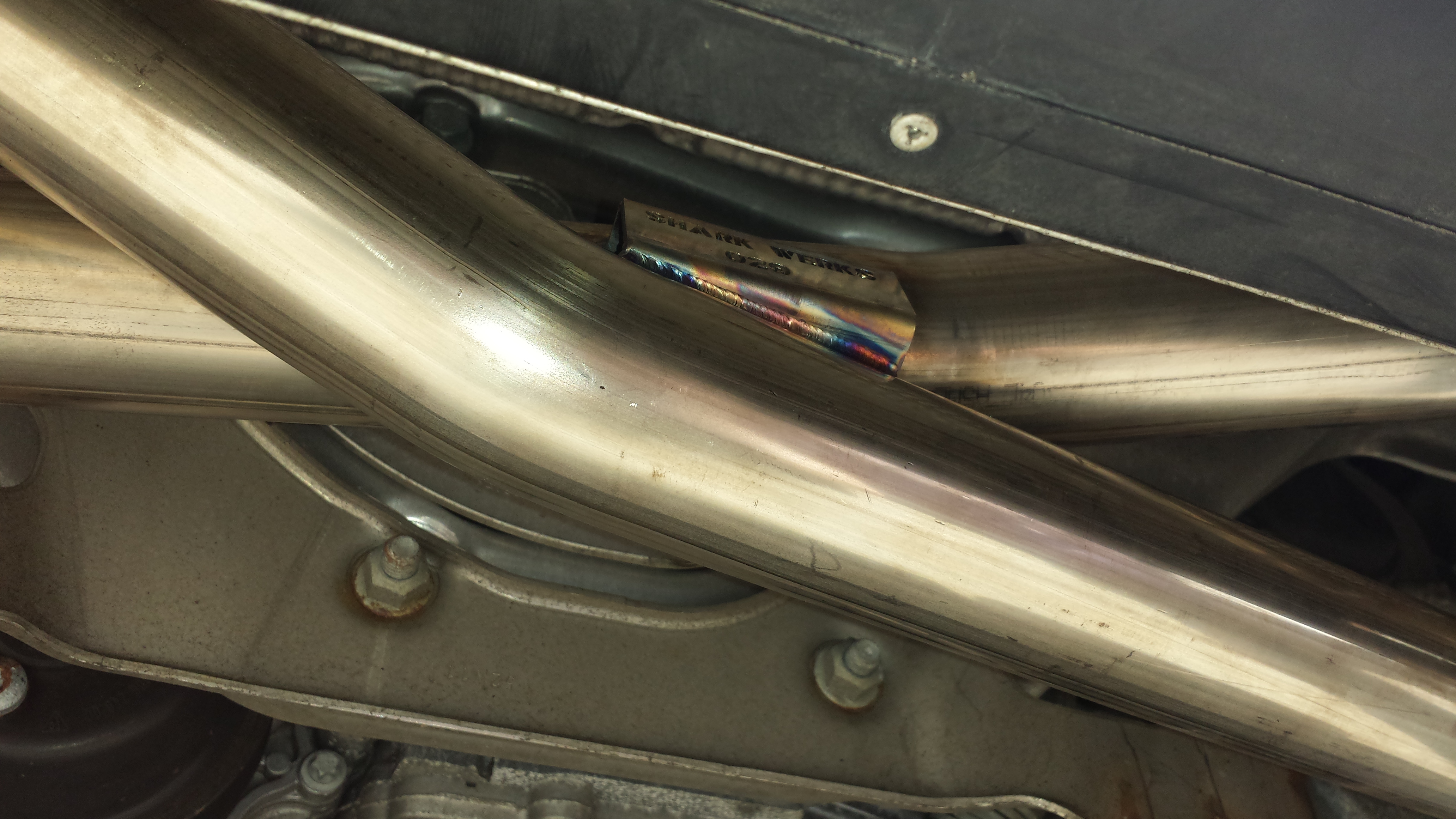

All in, took about an 1 hour to remove. Fairly easy. The pipe came on Monday, and I bolted it right up in 1/2 hour. Success!

If you do it, buy the Rust Penetrating Spray, and let it soak in overnight, and hit it again before you start the removal. I was surprised at how little torque it took (my 3/8" rachet is only about 8 inches long) to snap that stud.
