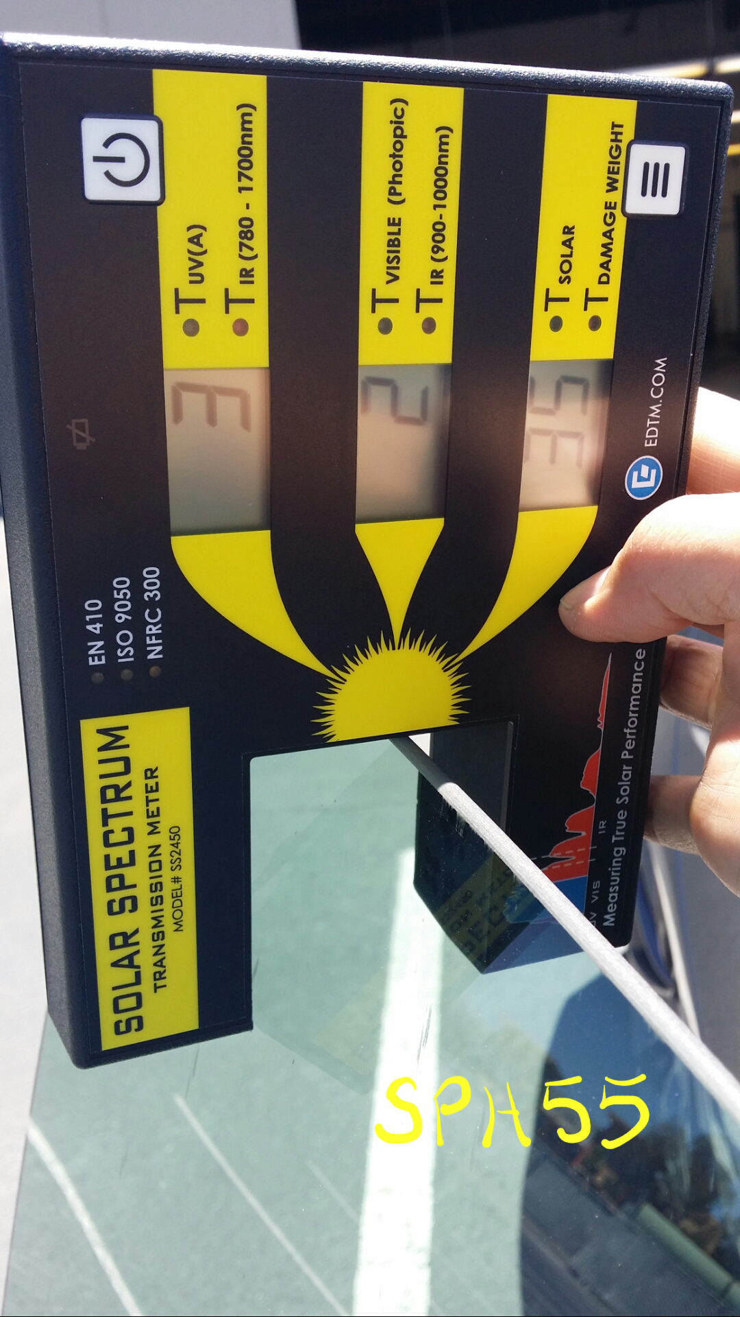

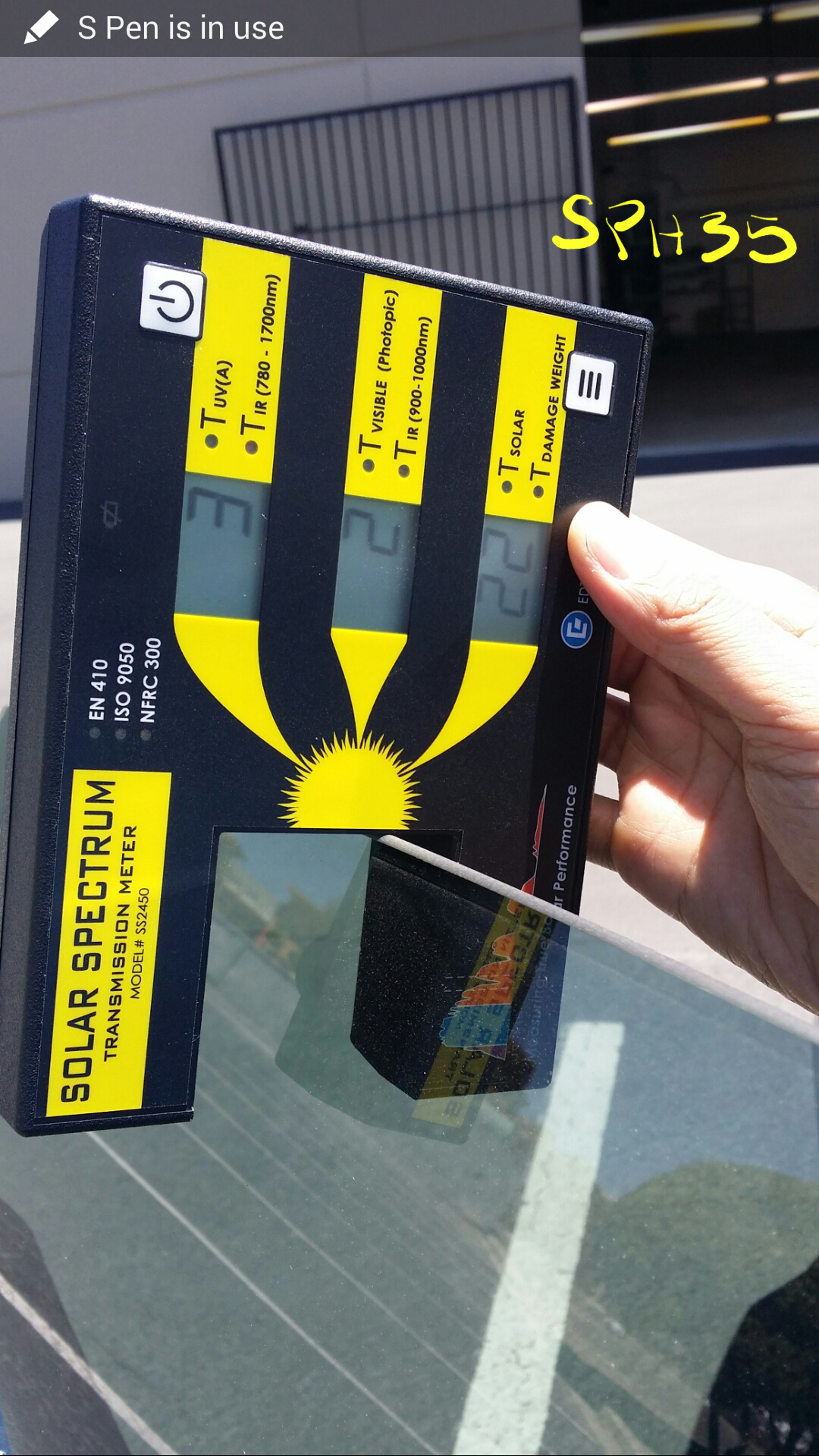

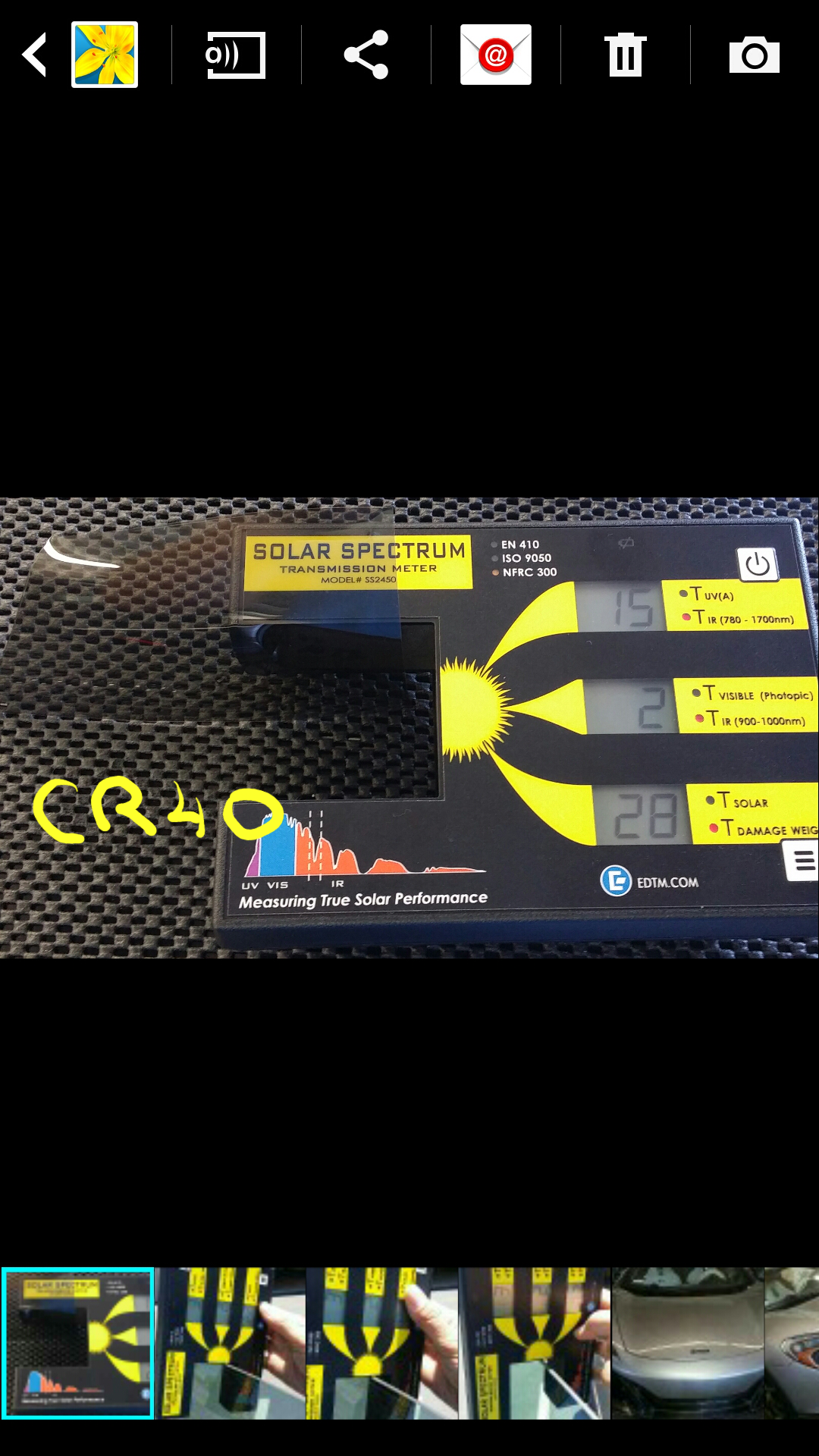

Just wanted to provide a little bit of feedback from us at Premier. Crystalline is a great product. It reduces IR by 97%. However, educating the public is what we need to do. The solar spectrum consists of UV, Visible Light, and Infrared (IR). The IR range runs from 780-2500nm. Unfortunately, many manufacturers post their highest IR rejecting numbers , but unfortunately these numbers are in the range of 900-1000nm.....the lower range of the scale. In addition, the performance of the film drops drastically in the higher IR range.
Below is a test we conducted with a spectrum analyzer. This is made by EDTM and utilizes patented optics to reproduce the solar spectrum. It also measures with NFRC300 (2010) standards, so this is the most accurate portable system available on the market. Below are the test results between Spectra PhotoSync and Crystalline.
This machine is capable of reproducing the solar spectrum and can calculate a solar product performance with respect to 3 important global standards:
1. EN410 (2011)
2. ISO9050 (2003)
3. NFRC 300 (2010) - this is the most important one for us window tinters because it is a USA standard
*this equipment is patented and a very accurate measuring tool we use.
Many films on the market boast high IR rejection numbers, but they usually take their highest performing numbers. Typically, the easiest performance numbers to gain is in the short IR between 900-1000nm. This represents a very small portion of the IR spectrum, which ranges from 780-2500. In general, these other window tints perform not as well in the higher ranges. BTU meters typically run in the range from 900-1000, so it is not representative of its true performance. On the IR scale, the range between 1100-1600 is the spot that is critical to heat transmission. With this unit, it can do what other units cannot - measuring two different values:
900-1000
780-1700+
We just installed window film to this Tesla Model S with 55 on the front two and 35 on all of the back windows. As you can see SPH55 blocks out 98% of IR (allowing 2% to transmit through) on the 900-1000 scale. With the higher spectral range 780-1700, it comes through with 97% IR rejection (allowing 3% to transmit through). Simplified results:
SPH55
900-1000nm 98% IR Rejection
780-1700nm 97% IR Rejection
SPH35
**quite consistent results and only 1% variance in the higher nanometer range
Crystalline 40
780-1700nm 85% IR Rejection
**as you can see the performance drops when you are looking at the higher IR range.
Before actually conducting our own test, we were a little perplexed as to why the TSER is so different between PhotoSync and Crystalline even though their IR numbers are close. Now it is clear. It is because on Crystalline, their performance drops when you reach the higher nm of the IR Spectrum whereas PhotoSync is highly consistent with high IRR (infrared rejection)
