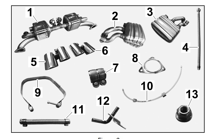

From the diagram:
#1. 991 111 437 07
#8. 991 111 482 00
#9. 991 111 481 01

Not sure what the right valve motor is...I've attached the diagram of all of the PSE parts. The only ones you need are 1, 8 and 9 if you want to install without the switch. This is what I've been told by two different dealers.
Another forum member recently told me that the old tips (S/4S models) will work.
Also, how do you know that it won't be in the always on position? It would make sense that without the switch closing the valve that it would always be open. I believe this is how it was on the 997.2. I guess I'll know in about a week.
If #1 comes with the vacuum motors, then you don't need to buy that.
#9 is the same part number (for both mufflers), so I don't see why it is needed (but it can't hurt to get 2 new ones).
Same for Gaskets, Nuts and Bolts.
I think you do want those vacuum lines 10, 4, 11, 12.
Those are the last 4 parts, that I listed here:
https://www.6speedonline.com/forums/...ml#post4128325
They are real cool Steel Mesh Covered Vacuum Hoses (and they better be for $150).
You will need to source your own clamps for them though.
The Porsche Clamps require a special crimping tool.
#11 joins the two vacuum motors together.
#12 joins the two #4 vacuum hoses together.
#10 connects #4 to the Change Over Valve.
You have four clips, on your existing vacuum motor line, that you re-use two of, on #10 (as the pic shows).
That's if you want it like the factory did it

*** As a note - my list was for a PSE for a S/4S model.
For a base model, I believe you do need new side mufflers too.
You do not need the new double tips for an S/4S.
