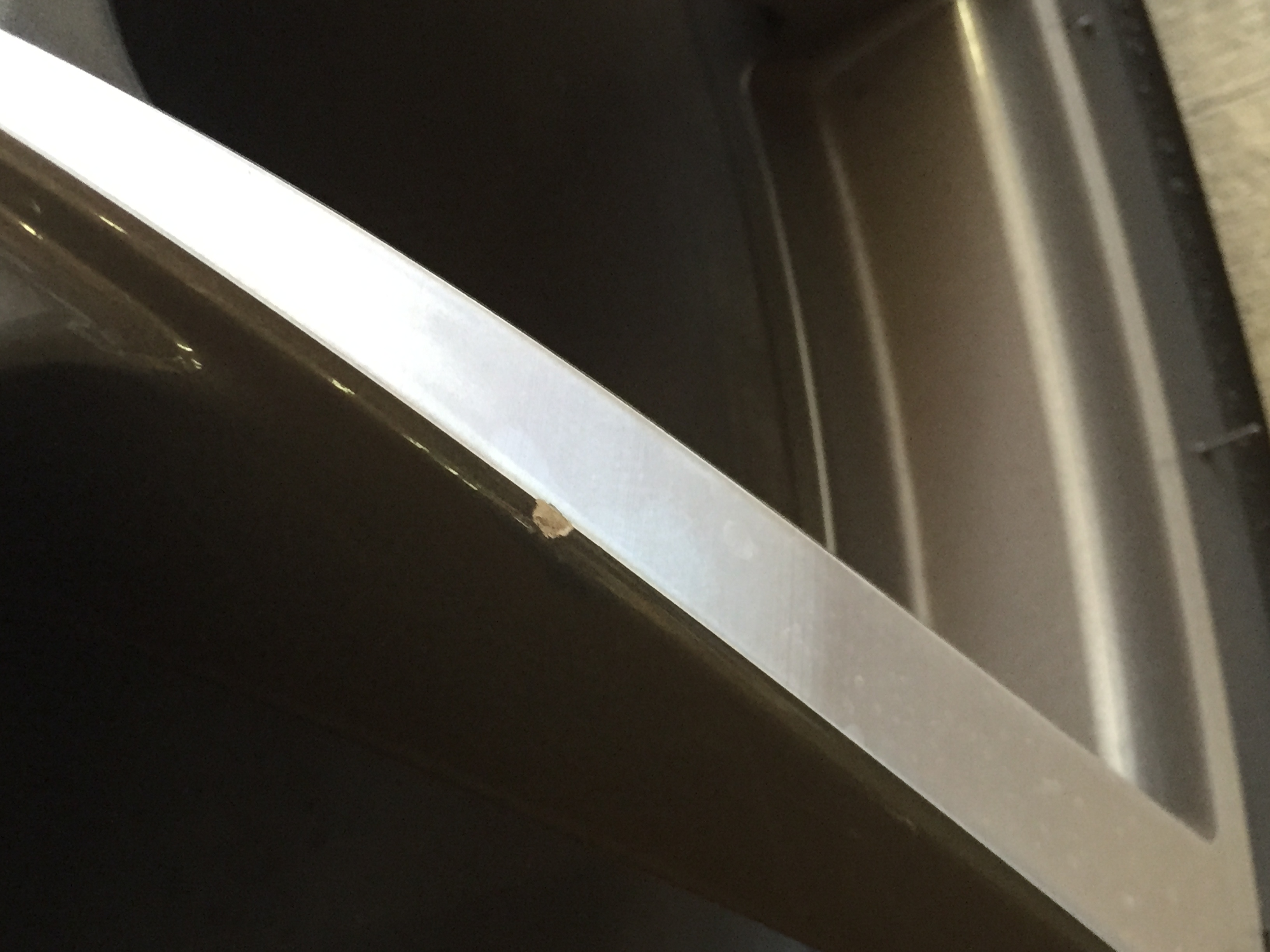

Any advice guys? Was going to use a regular wheel repair guy. Any good experiences/people you've used in the LA area? Definitely a stone chip. Bad location though, right at the edge of the polished and painted section of the Carrera Classic wheels.
leave it as is - not worth damaging the original finish

I would DIY fix the chip. Go to a hobby or art supply store and get a 00 size brush. Get a tiny bottle of touch up to match the inside and/or outside color of the wheel. Testors model paint has practically dead on matches for every wheel I have touched up. Also get some Testors clear coat.
Lay in the paint to fill in the chip. It could take 2-4 applications to bring it to level. Seal it with the clear coat. If the chip or gouge is rough edged simply smooth with sandpaper. For curb damage I start with flexible cuticle files then follow with sandpaper.
Only with severe curb damage would I consider taking the wheel to a refinisher. I try to maintain the OEM finish as long as possible.

I can't agree more with the above comments. if you take it into a refinisher, even if it comes back looking good, the process they use (blending clear coats, etc.) will leave you regretful in the long run.
I would just put a little touchup on there and you will be the only person that ever knows this happened.

The chip looks almost exactly what happened to me. I used bondo to fill the chip, sanded it smooth and then painted. Like dogshyne says, the only one who knows there was ever a chip there is me.

Thanks for the advice guys. You're probably right and I wouldn't be surprised if it happens again. I've learned not to sweat the small stuff so much.

When my dealer did a tire swap, a small chip appeared from the previous wheel weight. A local body shop matched the paint as it's not available from Porsche. Perfect match.

If I could add, I would fix the chip now. You want to seal the chip now to stop moisture and contaminants from getting under the chipped clear coat...which it will...and then it will start to delaminate and get worse.

Ouch! Yes, I'd do the same. Seal it up, touch up and use it.

Definitely do a touch up to seal the paint and finish now. I would be reluctant to take the wheel to be refinished as most of these refinishers don't seem to grasp the concept of finishing the wheel like factory. I have seen them come back from "reputable refinishers" where the front of the wheel looks OK but when they clear the finish they cleared right over dirt and dust and especially on the back of the wheel - yes I clean my barrels when I clean my car. So just a thought. Good luck and don't sweat the small stuff.

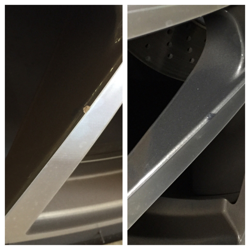

This was the best I could do. Used Testors paint. Mixed gunmetal metallic with flat gray and applied approx 4 coats. Then used spray clear coat. Sprayed it into a cup and used a brush to apply. I couldn't find a clear coat to brush on initially so I improvised. Not perfect but I'll get over it. First time I'm looking forward to brake dust haha. Should blend in more. Thanks for al the advice.
