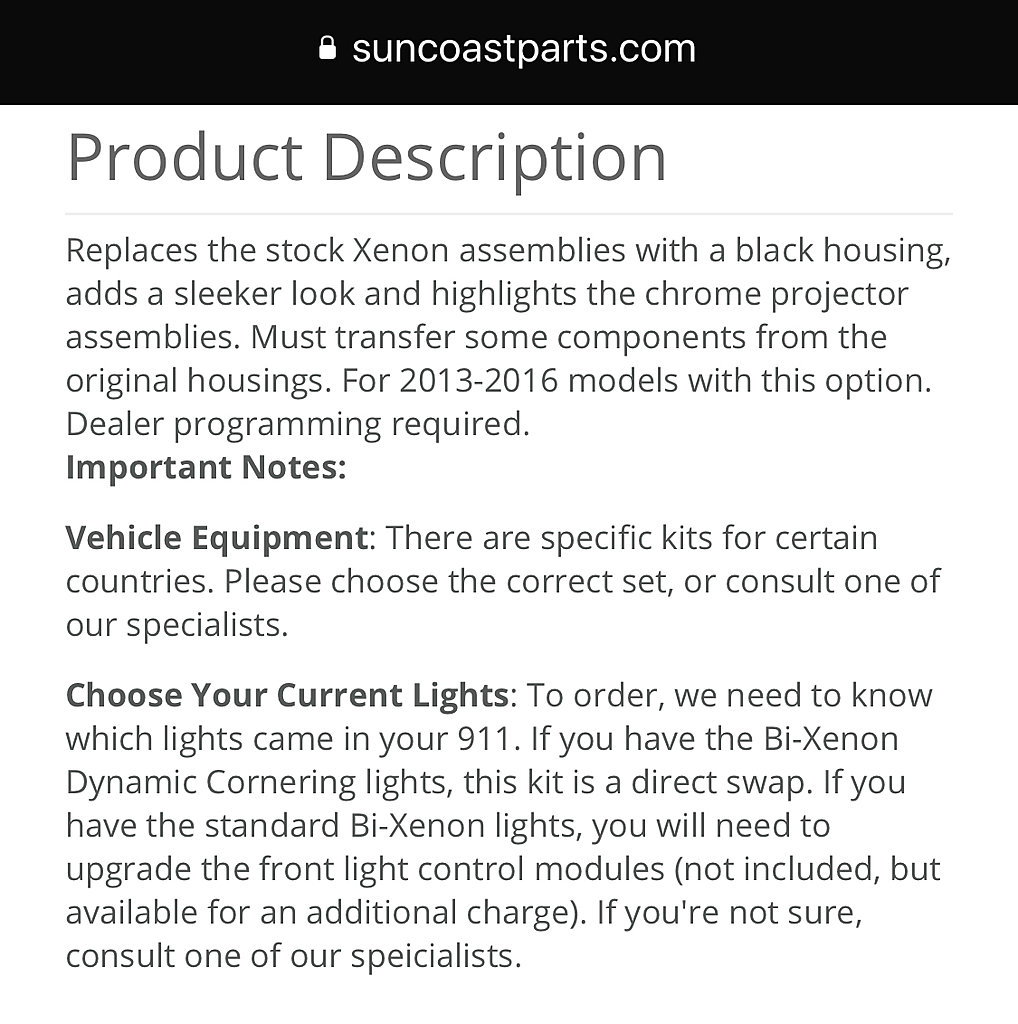

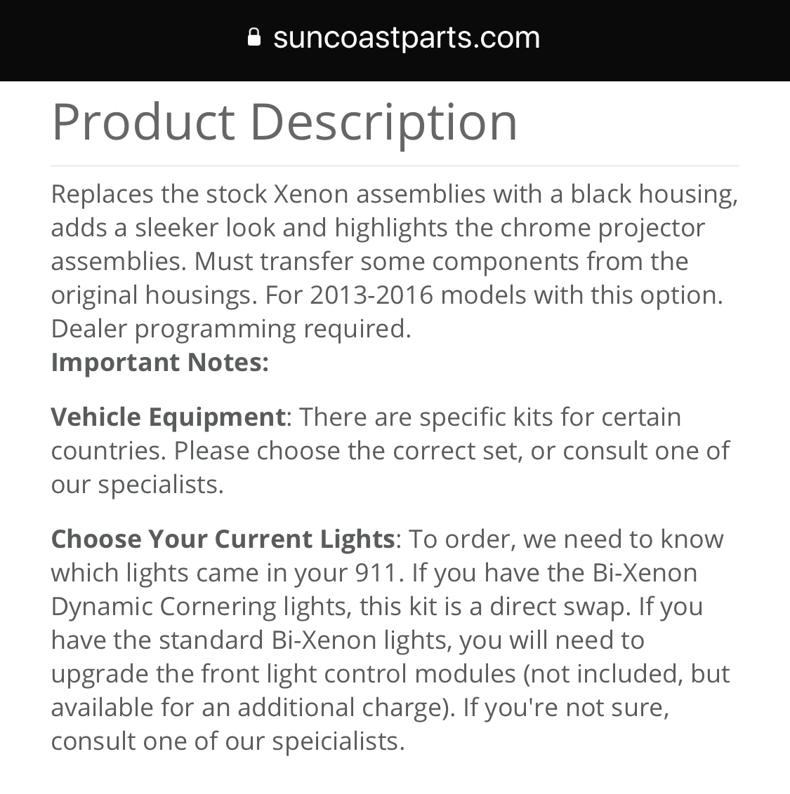

You will need more hardware if you didn't have the option. See notes here.
