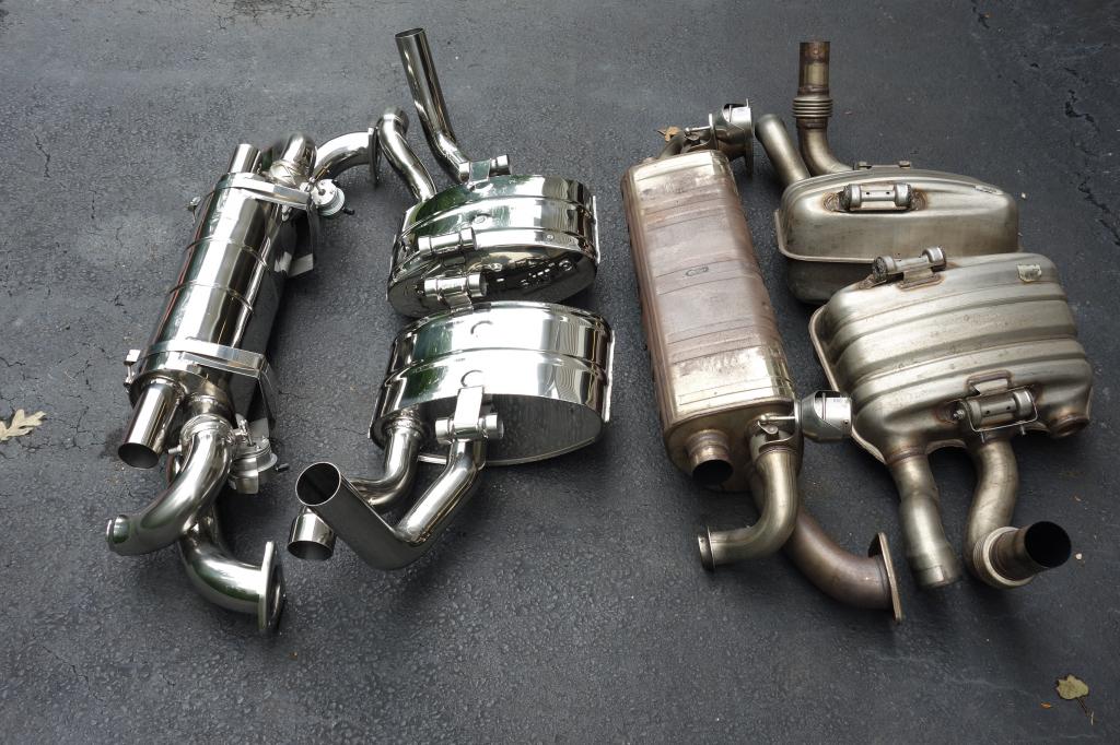

I replaced the whole cat-back exhaust on my 991S with a TUBI after mucking around with several different options. Not everyone wants to drop $ 4,500 on a cat-back exhaust but I enjoy it every time I start the car and would do it again in a blink. Stock is on the right....
