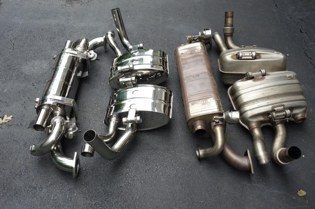

On my car, I have a full Tubi Cat Back Exhaust after first trying the AWE Switchpath, that's how I got as far as I have into the exhaust plumbing as I did all the installs myself and learned the system. Here you can see the valves on both the Tubi and the stock exhaust, side by side.
99% sure that the "10% louder" tone you're hearing is the Sound Symposer opening up. That's the feature that's enabled in Sport/Sport +.
