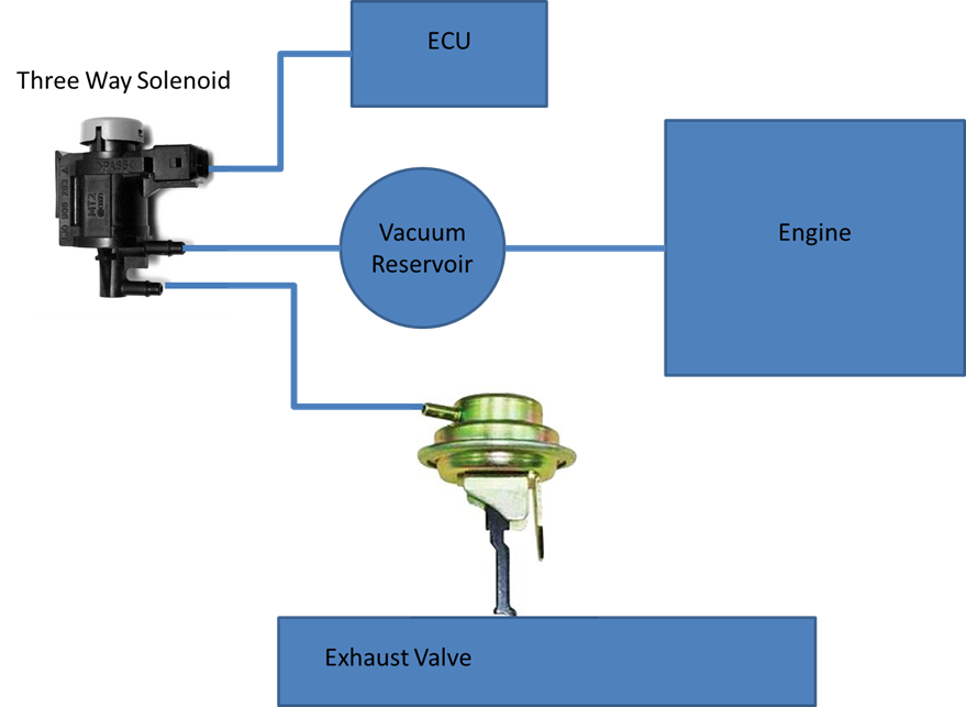

Lots of confusion in this thread. I'll try to help explain....
Standard Carrera (3.4 L) does not come with valves.
All S model Carreras (3.8 L) have the valves to control the sound level from the factory and they operate like this:
Valves are OPEN at start and idle.
Valves CLOSE once you step on the gas and remain closed until appx 3,700 rpm.
Valves are OPEN from 3,700 rpm to redline.
All this is controlled by the onboard computer reacting to vacuum input. Here's what the system looks like in a schematic.
So, everything is automatic in every "S" model from the factory. The PSE "switch" allows you to over-ride that closed setting from off-idle to 3,700 rpm if you want it loud, and also to keep it closed from 3,700 rpm if you want to keep it quieter. The PSE switch is integrated into the A/C system buttons and requires 1 hour dealer re-programming to set up, you cannot just pop it into the console and expect it to work.
The PSE exhaust itself is a different center can if you have a stock exhaust. Swap out the center can and you're all set. Add the button or not, the valves will still do their thing if you don't.
Hope that helps explain it some.

So all we need is a different center can. Great does it have to be the stock center can or will it work with an aftermarket center can and the button and reprogram?
Many thanks Drcollie that was great.
Old Jul 1, 2015 | 07:53 AM
drcollie's Avatar
Joined: Oct 2009
Posts: 1,172
From: Alexandria, VA
Rep Power: 87
drcollie has a reputation beyond reputedrcollie has a reputation beyond reputedrcollie has a reputation beyond reputedrcollie has a reputation beyond reputedrcollie has a reputation beyond reputedrcollie has a reputation beyond reputedrcollie has a reputation beyond reputedrcollie has a reputation beyond reputedrcollie has a reputation beyond reputedrcollie has a reputation beyond reputedrcollie has a reputation beyond repute
My pleasure.
Yes, this is the least costly way to get more tone without boom and drone (in my opinion). Just get the Porsche PSE and have them delete the console button if you don't feel the need to over-ride with the on-off. You can jack the car up and install this yourself in 45 minutes. No programming needed and the car will function as in the prior post.
