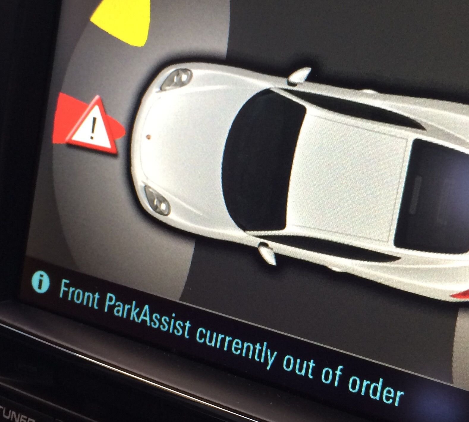

My car the other day gave me some sort of front park assist malfunction message on the PCM screen while I was sitting parked first in line at a stop light, so these two things combined makes me think that *perhaps* my battery is dying, could that theory make sense?

i get this message from time to time but it clears after a few seconds. dealer found no faults and thinks it some sort of interferance . so doubt your sensor and spolier issues are related.

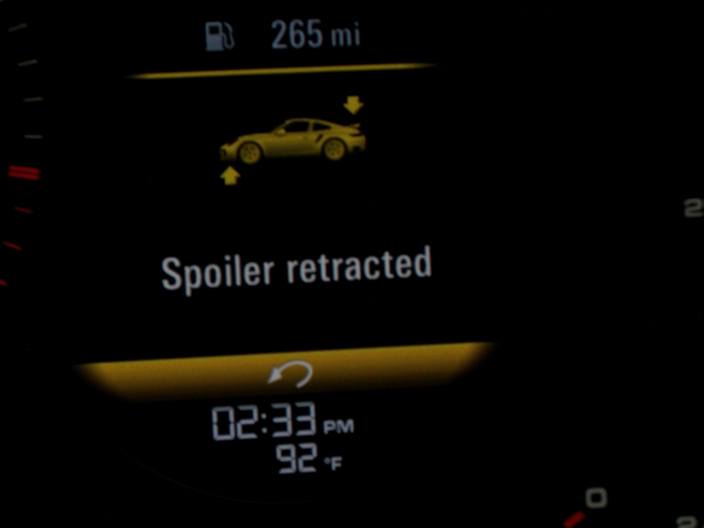

If you were in sport+ your wing automatically deploys. If your wing is up and the car is not moving and you want to lower the wing, you have to press the spoiler button and keep it pressed for about 10 seconds. You should get a message saying spoiler retracting or similar, and a final message saying spoiler retracted.

Not sure on this, I go to sport plus and my wing does not raise. I also do not get any message stating if it is up or lowering. I can push the button to raise or it goes up automaticly around 78 mph and drops around 50 no matter what mode I am driving in, and no message anyplace except telling me if I am in sport or sport plus.

It shows on the display to the right of the tach. Might be something for just the Turbo, perhaps? I just assumed it was a feature across the entire 911 line.
Here are pics of the messages.
